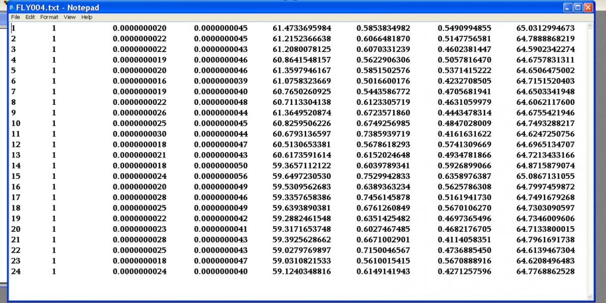

I tried it indoor and I took this file.I hope the coordinates are wrong because there is no GPS signal in the house.
leofuica
Stasid:
This is correct, try to SIMULATED FLY outdoor for better GPS reception....but look well
