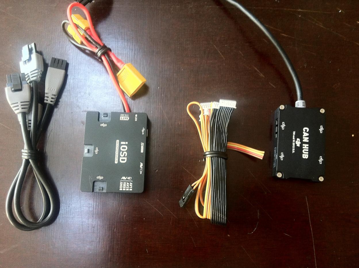

Got the OSD today and the Can-bus Hub.
Gonna hook it up and upload a video to see what it can do.

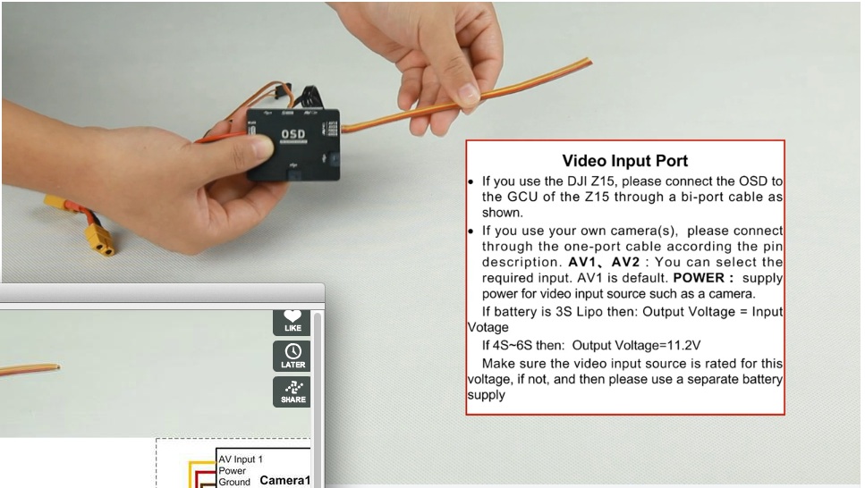

stragen one thought the OSD give out the full battery voltage over the AV out, direct from the zenmuse it was reduce to 12V hmmm. Guess that the way it should be !
BorisS

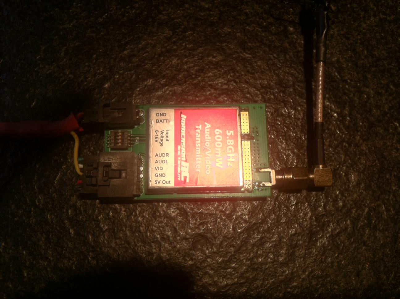

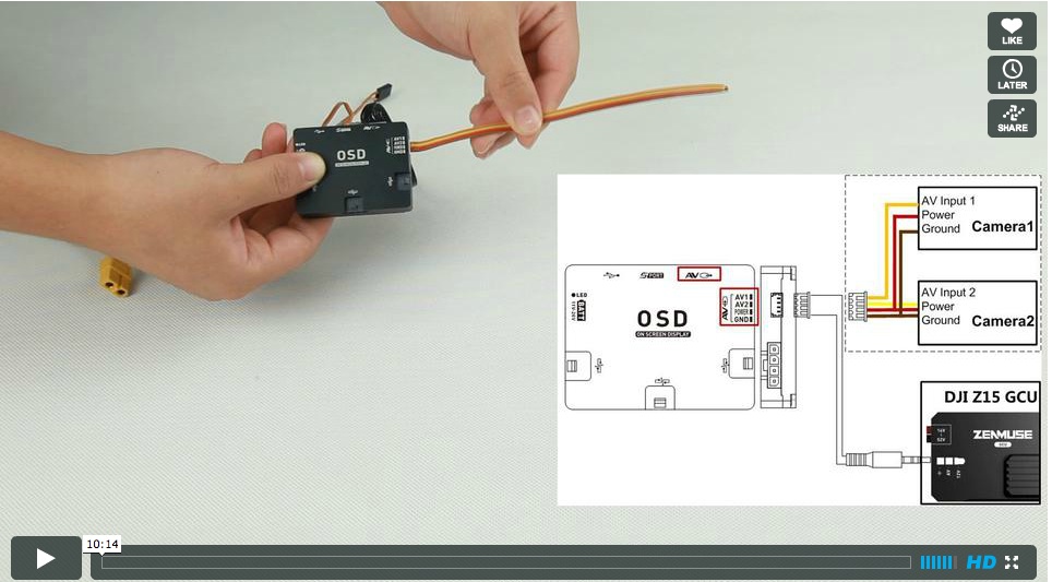

so were am i going to get my 12v for the immersion VTX from, which i got from the GCU before. Just use the 12v from the GCU again direct it to the VTX and connect GND and Video to the OSD and than to the VTX again. Aren't I'm creating a GND loop there ?
Really don't want to install an extra BEC
Boris
immersion vtx don't need regulated power..... if you are, you want it 7v

You guys see and GND loop risk here ?

hmm mine needs it for sure between 6 - 16 v can't give it the full 6s on the s800 to lets say it like that the 6s which comes out of the AVout from the DJI OSD

Digitech
i connect the output for the zenmuse directly to the osd.
the osd has again a BEC for the video tx.
so there you connect your 600mw to and voila ! all working.
also i dont get the problems you had with the 12V output (zen) to the immercion , i connect them directly without any issues.
i build at least 25 customer rtf like this.
if i am not mistaking the Zenmuse has a BEC for at least 1 amp
the immersion uses about 600 mah on 12 volts.
maybe the TX is bad?
ah, yea you gotta do something then. Those pull .5-.7 amp
don't see a ground loop
I've always found that ground has to go in and out of the osd to the vtx,,,, if anything that's the part that just wont let it transmit from no ground,,,,,,

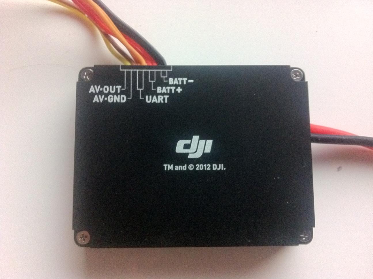

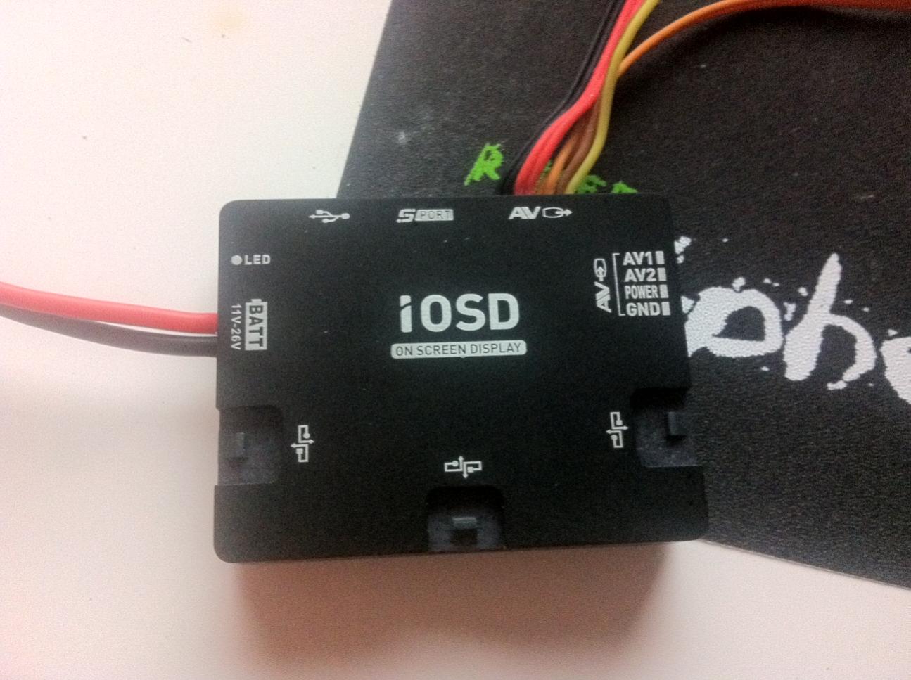

the 11,2v is for AVin ! If you look at the back of the the OSD you will see that the AVout + and - is marked as BATT - and BATT + thus full 6s, or use a mutimeter you will see ! No prob to use the AVin Voltage out, taking care to not loop anything ! But before that i prefer to take the 12v coming from the GCU to tell the truth !
Boris
BorisS
seems like its for their components. VTX DJI take 6s and might even be that DJI is bringing out a FPV CAM.
For the S800 no problem little work around I hope, but for small FPV birds having to use extra BEC again, where you can have it all in one with a TBS core hmmm.
