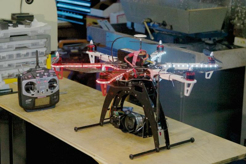

I have 50 or so flights with both my F550 and F450 with no motor problems at all. I have them both set up w/o any soldering other than to the board, I am just using the bullet connectors.
I would check the main board connections, and make sure your RX antennas are at 90 degrees away from wires.
Also put some black tape on the left side of the Naza, this will absolutely help eliminate vertical moves if the sun hits that side of the Naza.
I use 3 cel Lipos 25c 4400's and 6400's and I find the Graupner 10x5 E-props work very well, they have a nice sound are very strong, came needing very little balancing and seem to give me 10% or so longer flight times than the DJI's.
I run a gimbal on the 550 so it is pretty heavy, but I still find it flies great and the motors are just warm after 6 minutes flight time.
I did have a defective Naza once, but DJI replaced it under warranty. That was very obvious the gimbal would swing wildly and the 550 would make sudden lateral moves w/o my input.
I find the Naza 550 to be very solid and well behaved just stock, so there must be a problem with your kit somewhere.
If you ever get up to Mt. Washington Valley NH, bring your 550 and contact me we can compare your setup to mine and maybe find the problem.
