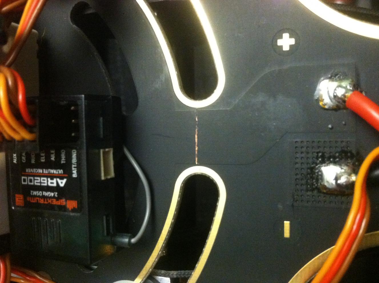

After a prop failure I did a rebuild and one motor wouldn't spin up. I thought it was a bad ESC so i replaced it. That wasn't the problem. Noticed this hairline crack in the board where that exact motor arm mounts. Can this be repaired with solder or do I need a new bottom plate?

what about sanding the covering off the positive ring behind the crack and soldering the input on there and then fixing the boards crack with solder. Couldn't have been in a worse spot, whats the other side look like? is the ground comprimised too?

Other side looks worse. The LHS has a 550 Base kit in stock. So i might as well just buy that for $50 and have some extra parts on hand. After looking at this closer i don't think Solder will work.
