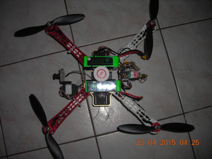

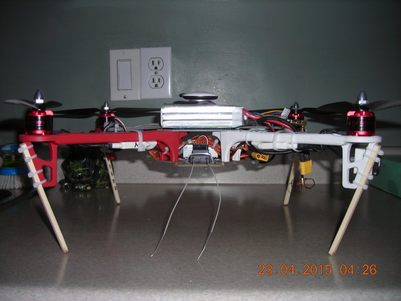

As the title says I have a DJI450 with a Naza lite controller and I was wondering if my battery setup can affect the stability of my quad. I have two 2200mha 3 cell lipo batteries on the top deck of the flame wheel on either side of the GPS antennae, will a battery setup like this be too much weight and affect my stability, or do I need them put in a different location such as below the centre of gravity?

I don't think it's over weight, the batteries sit so that the tops of them are level with the tops of the motors. I'll take a picture of my setup and post it later.
bensid54

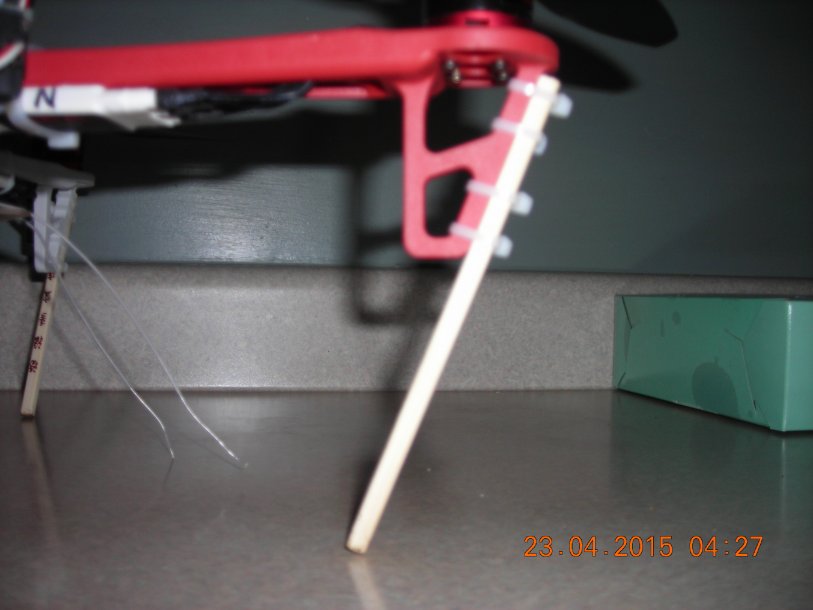

Here are the pictures of my battery locations along with pictures of my chopstick landing gear.

Motopreserve
Have you tried to determine how the center of gravity is with a string? You have some things off the front and back which may cause unease.
You might try the batteries below as a test. See how it handles.
Motopreserve
It is definitely worth a shot.
Also, Try to do some calculations for the motors you have, the props you're running - and what type of thrust that's producing. Then weigh the MR with everything on board (including batteries). If you're overweight - you'll be at a value that requires more than 50% throttle to hover.

Ok, next suggestion would be to try and get the center go gravity to the center of the rig. Meaning if you hang the quad from the center by a string it would hang level. This will greatly help stability. Also balance props.

Props are balanced, as far as hanging it from centre the GPS puck is there and that may be a little tricky. I could however place my scale under each leg and weigh them to see which one weighs more. Worth a try that may work.

The center of gravity is more about seeing if the weight distribution is correct. So the single leg method might not tell you much.
If you put a string under the frame and center it - hold it out so it doesn't hit the GPS and see if it tips forward or back, or if it stays level. You can the move the string 45* and do the same - that will tell you left to right balance.

If you're under the 1600g with batteries, you should be good. Seems like center of gravity (CoG) is the most likely culprit. Remove the puck, it'll give you a more accurate reading on how it's laid out - and it's not that much of a pain to put back.

54, I wouldn't worry about your batteries being on top of the frame, because they're still below your props, which is where the center of thrust is located.
Search 'Pendulum fallacy' and multirotor. There are 2 discussion on this forum and another on DIY about matching the center of gravity with the center of thrust.
Having weight below the CoThrust may feel more stable; but it actually makes the motors work harder to turn or move through the air because they have to lift that off-center weight against the leveraged displacement from center.
