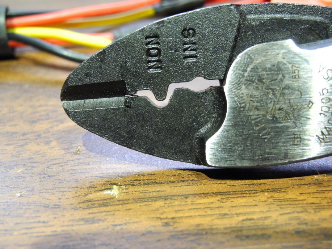

The crimp connectors I used.
Here ya go... This is what I did.
I bought butt connectors from The Home Depot like the blue ones in the picture. I actually bought several types of connectors as I has several things in mind. I used my nippers and needle nosed pillars to remove the blue shielding as I just wanted the metal part. I know you can buy them unshielded but I didn't see any. It has a little notch so you know how much to strip off. I purchased the industrial crimp tool also at HD. It was about 10" long and has quite a bit of leverage.
I took my stripping tool and just cut through the wire at the correct distance for halfway through the crimp, without removing the insulation. It makes it easier to slide on the heat shrink. I slid the pre-cut heat-shrink on the wire, placed the connecter in the tool with the seam up, and inserted one end in after removing the insulation. I squeezed with both hands to get the most pressure. Repeat with the other side. Slide the heat shrink and heat. Violá!
I tested several things and this seemed to be the neatest. I tried a bigger diameter connector, thinking I would overlap the wires and then solder and then heat shrink, thinking it would give me a smaller joint. It worked, but the connectors I bought were too big and didn't look smooth so I opted for what you see. I may re-explore other methods as it worked really well.
My thought process was, I was using bullet connectors already. This had to be as strong as those were. I tested several before I committed to putting them on the ESC. I couldn't pull them apart as much as I tried. Hope this provides some insight for y'all. Let me now what you think.

Bowley
Nice Fred, thanks for posting the pics. Have you tried the ratchet style crimpers? much easier on the hands and makes sure you use just the right pressure for a good crimp.
