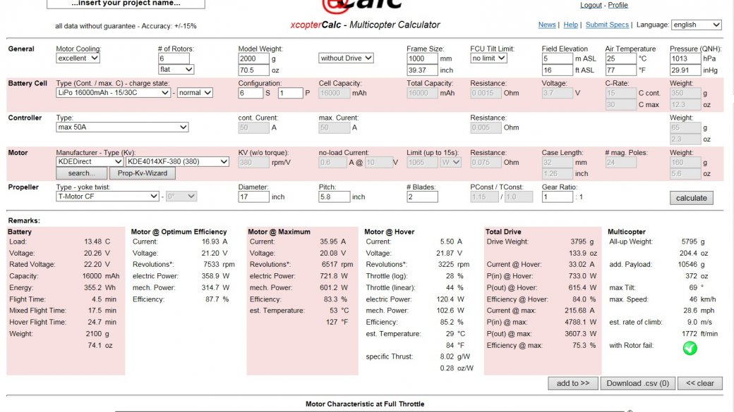

    Hello everyone! I've been looking at the Skyhero Spyder 6 hexa for quite some time now. After loosing my Align M480 last June, I've always wanted to setup another large multi. This time around I want redundancy. But I also want long flight times. So is it really possible to achieve 30+ of flight time with a Spyder 6 hexa? Bellow is the setup I have in mind:
    Spyder6 1000mm frame
    KDE 4014 380KV
    17x5.8 CF props
    Super X FC
    TATTU 6S 16000mah or 22000mah
    Thanks!!

  4. traxx2003
    traxx2003 Member
    111
    6
    1
    Mar 30, 2015
    California
    Posted by traxx2003, Aug 29, 2015 #4
    At this moment it will be for just for some long range FPV and extended sessions of sport flying. But I do plan to carry a gopro/ gimbal setup but not all the time.
  5. traxx2003
    traxx2003 Member
    111
    6
    1
    Mar 30, 2015
    California
    Posted by traxx2003, Aug 29, 2015 #5
    Now this numbers from ecalc, do they tend to be conservative, or do they overestimate potential results?
  6. fltundra
    fltundra Member
    830
    77
    11
    Mar 13, 2014
    Key Largo, FL
    Posted by fltundra, Aug 29, 2015 #6
    With tmotor cf's, I find it to be conservative.

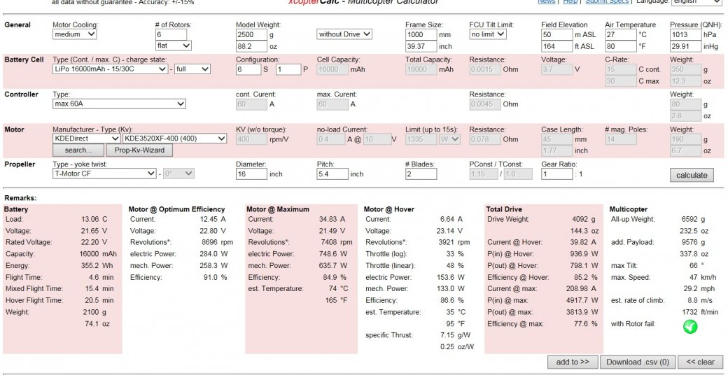

  7. fltundra
    fltundra Member
    830
    77
    11
    Mar 13, 2014
    Key Largo, FL
    Posted by fltundra, Aug 29, 2015 #7
    Here's with different motors and a 1 kg over frame weight. You really need to get eCalc, and run the numbers. Your limited by 18 inch props at that frame diameter also.
  8. traxx2003
    traxx2003 Member
    111
    6
    1
    Mar 30, 2015
    California
    Posted by traxx2003, Aug 29, 2015 #8
    I have ecalc but it does not allow me to input accurate weight for lipos. For instance, did you noticed the indicated weight for a 16kmah 6s battery? 350g; unless I'm misreading, that is way off. My Pulse 16000mah 6s is at least three times that.
  9. fltundra
    fltundra Member
    830
    77
    11
    Mar 13, 2014
    Key Largo, FL
    Posted by fltundra, Aug 29, 2015 #9
    That's per cell weight.:) The tattu 12,000 is 322g instead of 350g with the Eclac default weight.

  11. Chalagi
    Chalagi Member
    588
    13
    1
    Jul 10, 2012
    Central Arkansas
    Posted by Chalagi, Aug 31, 2015 #11
    I have found "Ecalc" to be way off unless your are flying a very small multirotor
  12. traxx2003
    traxx2003 Member
    111
    6
    1
    Mar 30, 2015
    California
    Posted by traxx2003, Aug 31, 2015 #12
    Really! How inaccurate whould you say?
  13. fltundra
    fltundra Member
    830
    77
    11
    Mar 13, 2014
    Key Largo, FL
    Posted by fltundra, Aug 31, 2015 #13
    Then your inputting data wrong.:D
