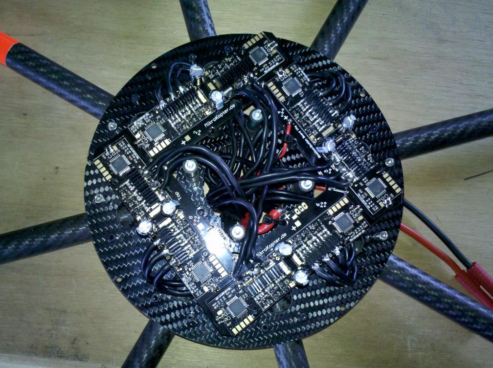

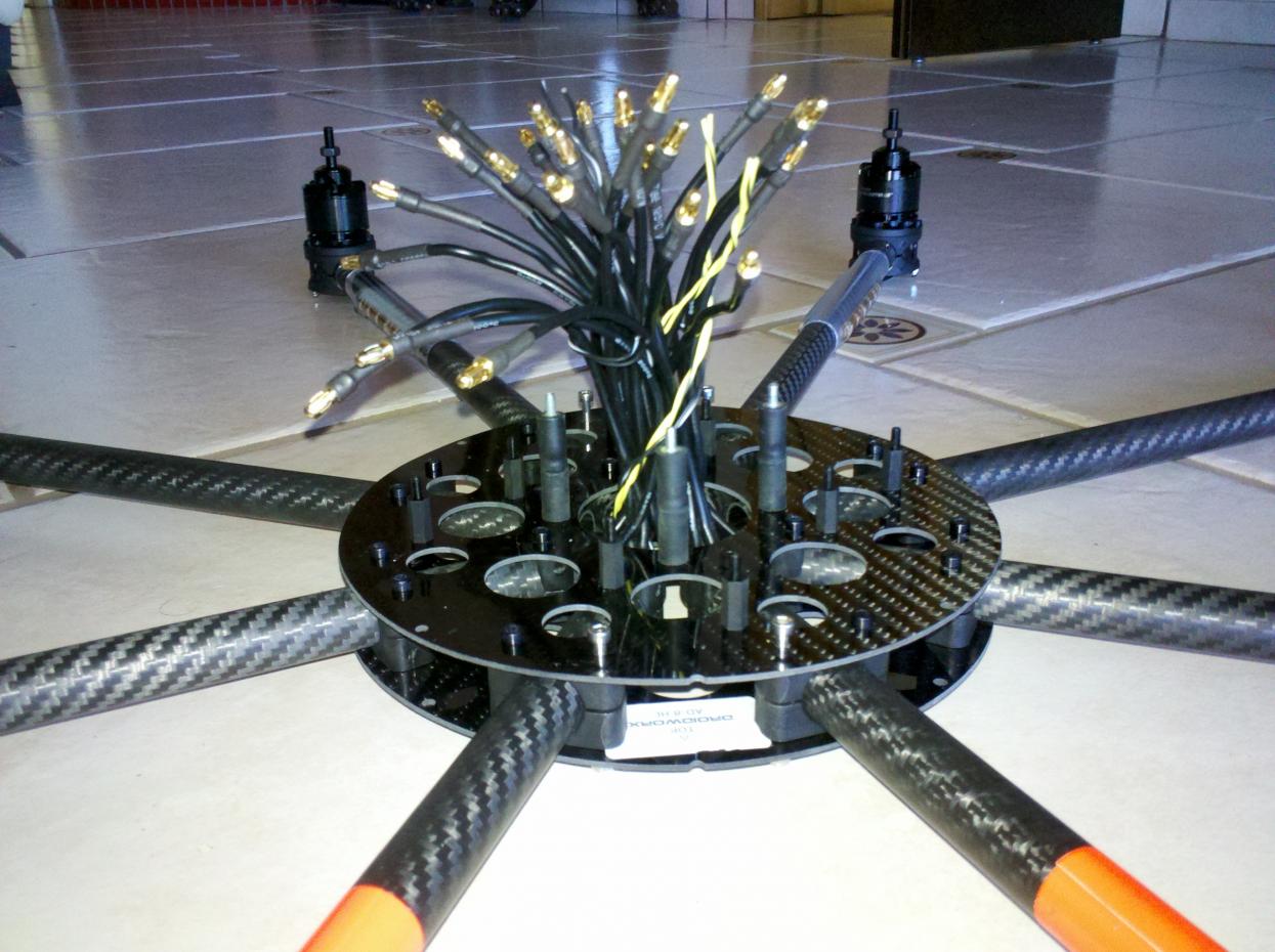

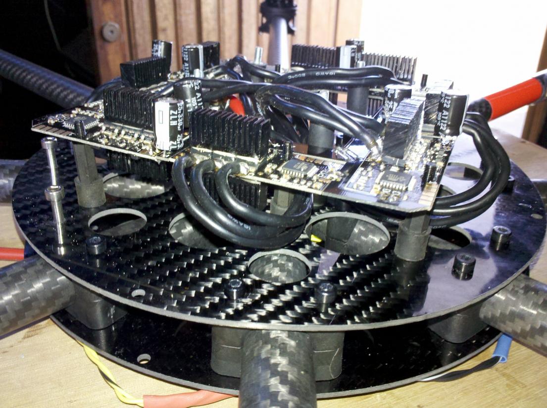

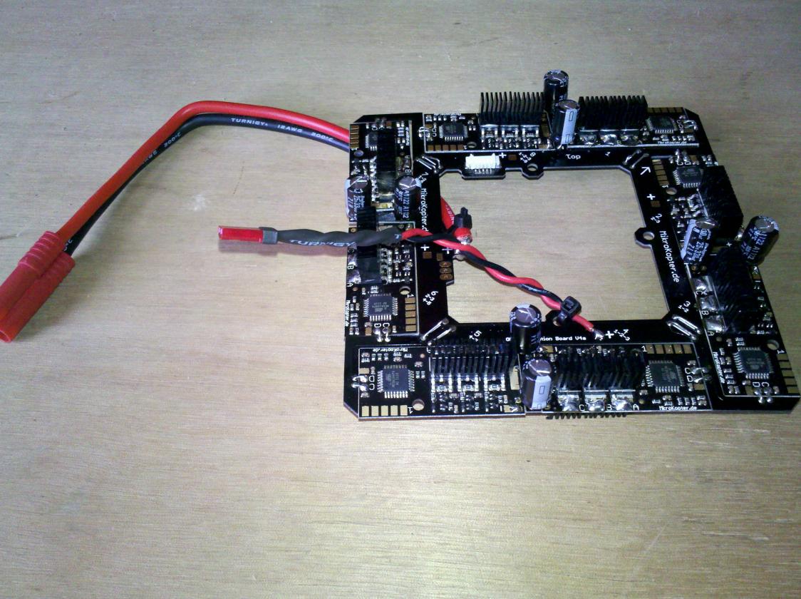

After install the arms into the center-plate and glue aluminum ESC Cooler there is too many wires so I decide shortening the wires where they connect to the ESC's. Like Droid suggestion I´ll solder motor wires direct to BL's.
I must admit that was quiet challenge put all parts of the frame together.

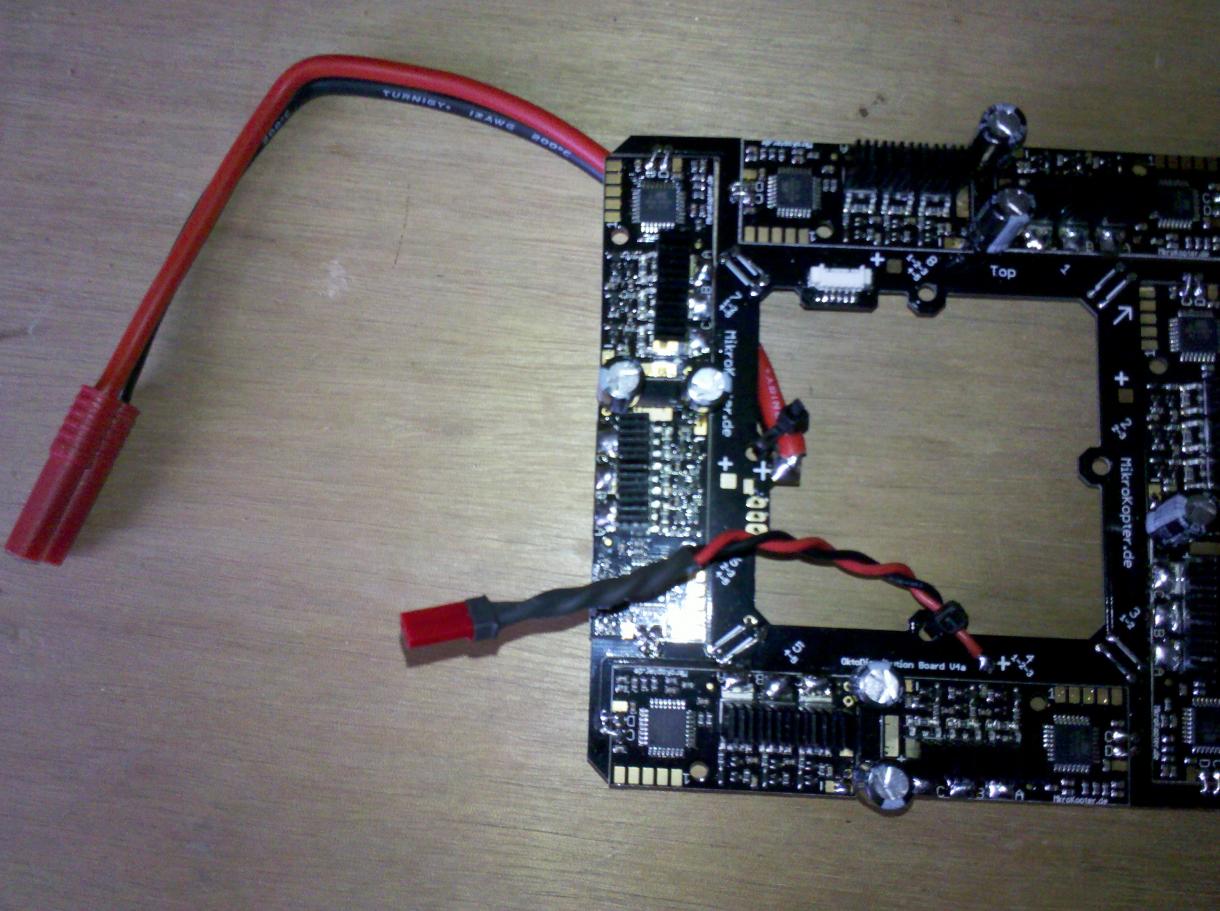

Today I´ll remove the short wires with bullet connectors from the PDB and remove the engine connectors.
View attachment 1600View attachment 1601View attachment 1602
Regards,
Jose Luis
