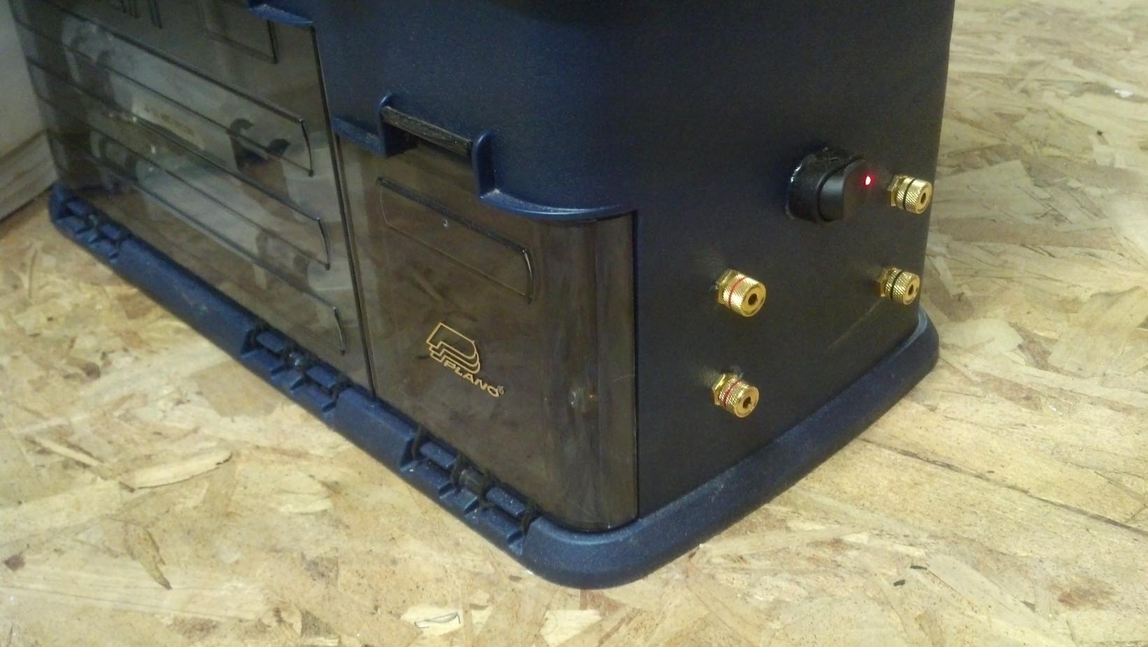

I found myself needing all my lipos to fly with one day, and so I wanted to give up having to use them. I use a 19" Vizio TV and 2 Vrx's with diversity for now, so I wanted more amps anyway. I started looking at motorcycle batteries but they are really expensive, so I poked around and found 12v gel-cell alarm system batteries at Home Depot for half the price of a similar MC battery. I think mine was like $35 for a 7 AH battery, and I just mounted it inside my converted tackle box I use as a tool box with two gold banana plug/clamp on speaker terminals on the outside of it. I put a switch on it to keep the terminals from being "hot" during transport. I also spaced the terminals far enough apart that my clamps can't short against the exposed parts of the terminals.
This might be overkill, but it's as cheap or cheaper than a much smaller lipo. The gelcell just lays on its side inside the small side compartment of the tackle box, and I charge it through the jacks.
