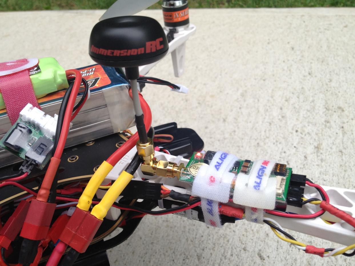

I have setup the ImmersionRC 600mw transmitter - 5.8ghz on a DJI F450 frame. On the frame I have the gopro2 in front and DJI GPS on the back. For receiver, I have the ImmersionRC Uno receiver (UNO5800).

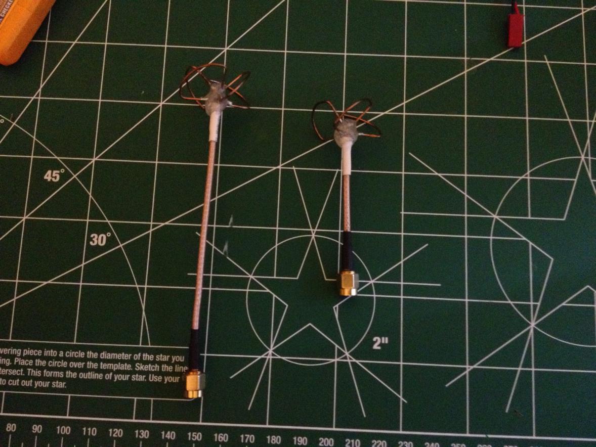

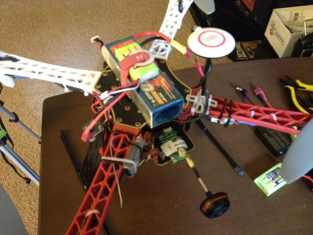

For antenna I have tried using CP antenna and Spironet antenna. With the CP antenna installed on the front left leg, signal is horrible. With the spironet in the same leg, ok until I pass the tree line. Installing the transmitter in the back, having the spironet antenna upright veritical or upside down, signal is also bad but I can go a little higher. Now if I keep the spironet antenna horizontal, video is perfect. Is it recommended to have the anntenna placed this way? Also, I was using a 2s 800mah lipo to power both the transmitter and camera with no issue. I also tried a 3s 800mah and still had the same issue as stated above.
Bad video signal
Bad video signal
Perfect signal

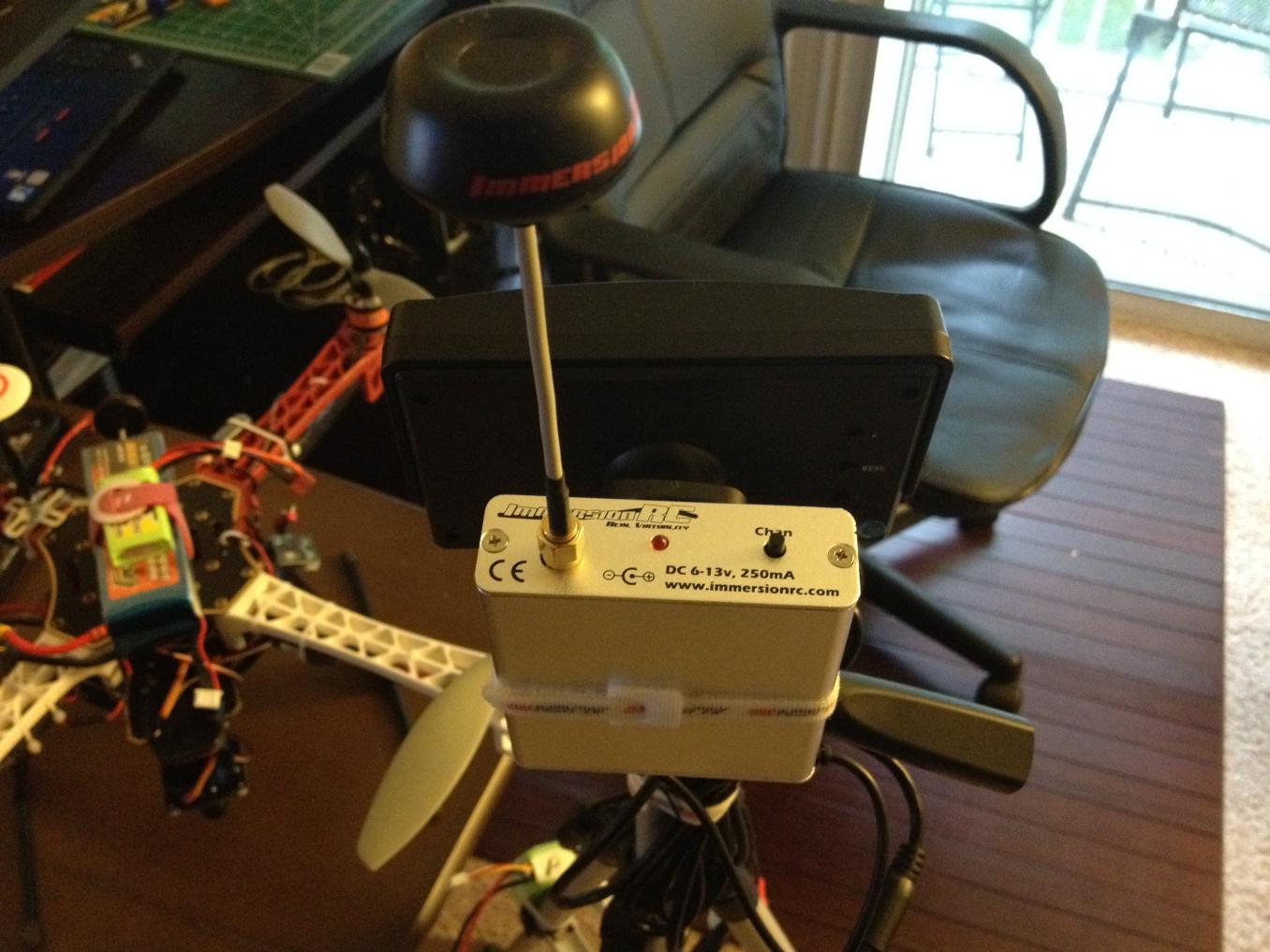

Uno 5800 Rx
CP Antenna

a 5.8 mast should be a wavelength or two up, that is 3.333" and increasing by 1/4 wave is fine meaning increase in segments of .83" at at time. Seems i had the best luck at 1 to 1.5 wavelength up on that system/freq
the top and bottom of cp antennas are null and have no signal, whatever you do don't point that fore or aft, your gonna hit the null sooner than later like that, point it up or down. down is generaly ba on the f450 cause it gets whacked easily

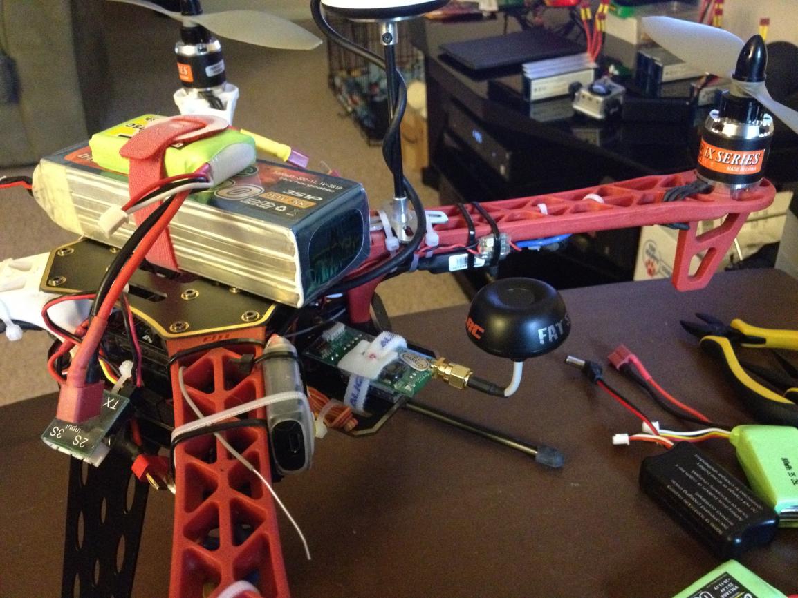

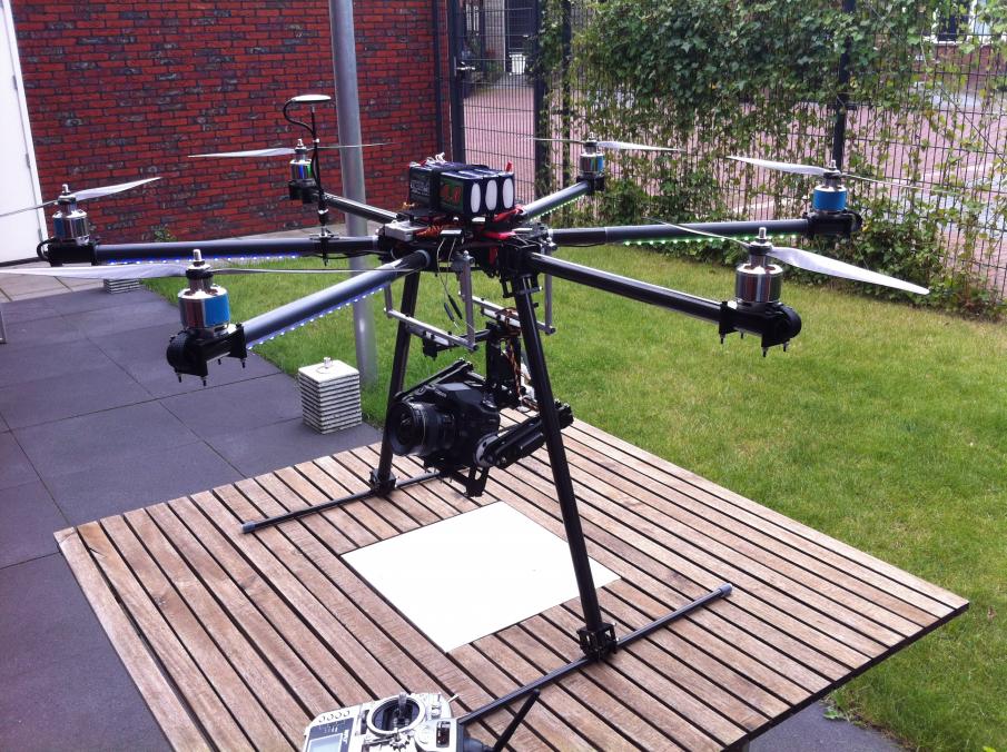

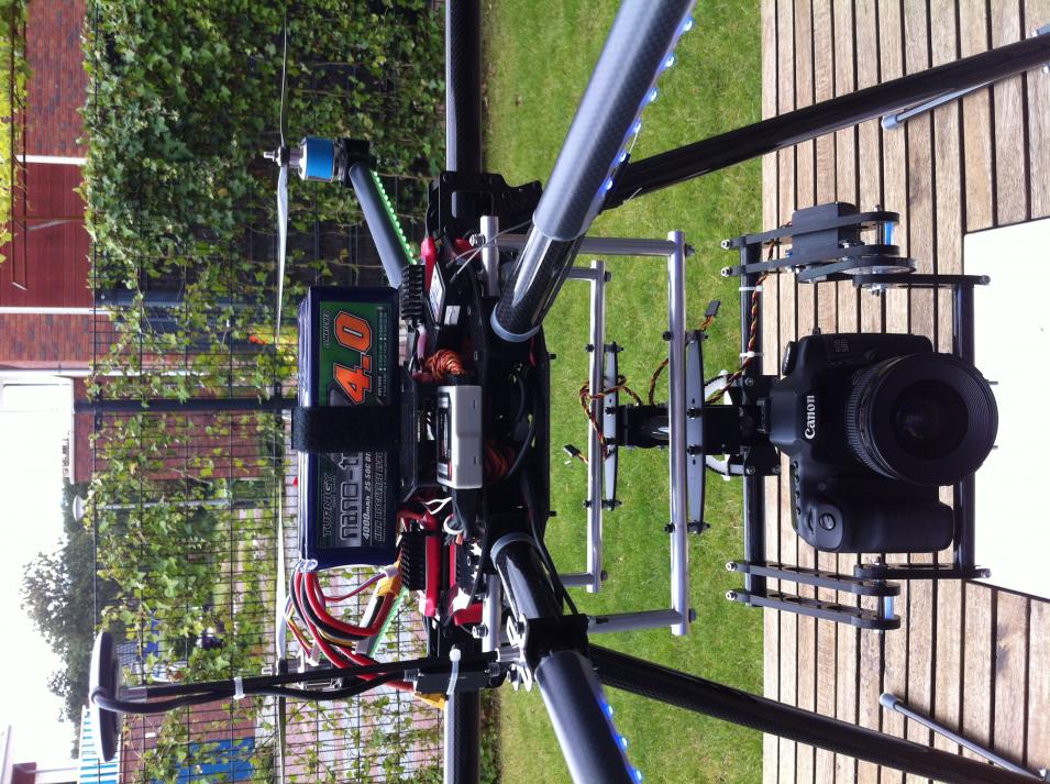

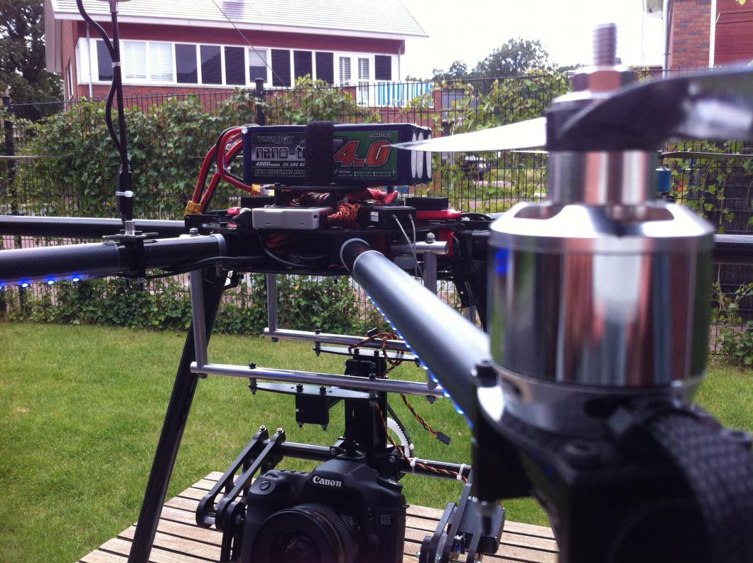

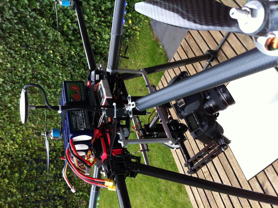

shoot for a layout like this
you can see everything i described in text in them right there....... on my other rigs that had 5.8 and gps the gps is back in the back by the rc control receiver. Flew out to a mile and never blinked
not 5.8, but shows the sat
you can see the modified vu there with the tin sticking out of the wrap. has a hole where the light shines through still. Those switching power supplies are dirty by nature. Your video tx has one too but it's a cleaner filtered setup

Ok, I moved the transmitter over to the right front arm and also installed a 90 degree elbow to the antenna.
Still have same issue. Quad is high above tree line and LOS. If I go higher the staic gets worse. I also tried putting transmitter in back under the quad belly.

you can, the advantage is ease and size is super minimal. disadvantage for 5.8 is it's just not enough to get very far. the 5.8 really comes alive with directional patch antennas like crosshair, helical, etc. a helical pointed to the north can still be flown south of you, i usually get 1200 - 1500 feet when my tracker used to stop before i'd look over cause it'd flicker a couple times. if my expectations weren't so high i'd probably never known. it's just out front is like a xray machine, they really pick up a clean signal, makes kloner happy
yea, 3 to 4.5 turn are super efficient, kinda work all around with an eemphasis on the front. a 12 turn or cannon is super tight, not so good to the sides and rear but man, out front is rock solid, behaves more like a lower frequency but kinda has to be spot on 30-40 degree beam if i remember right. almost tracking material.......
