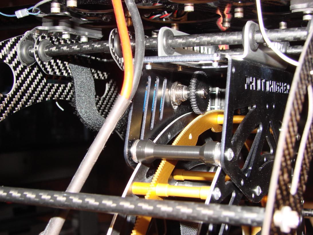

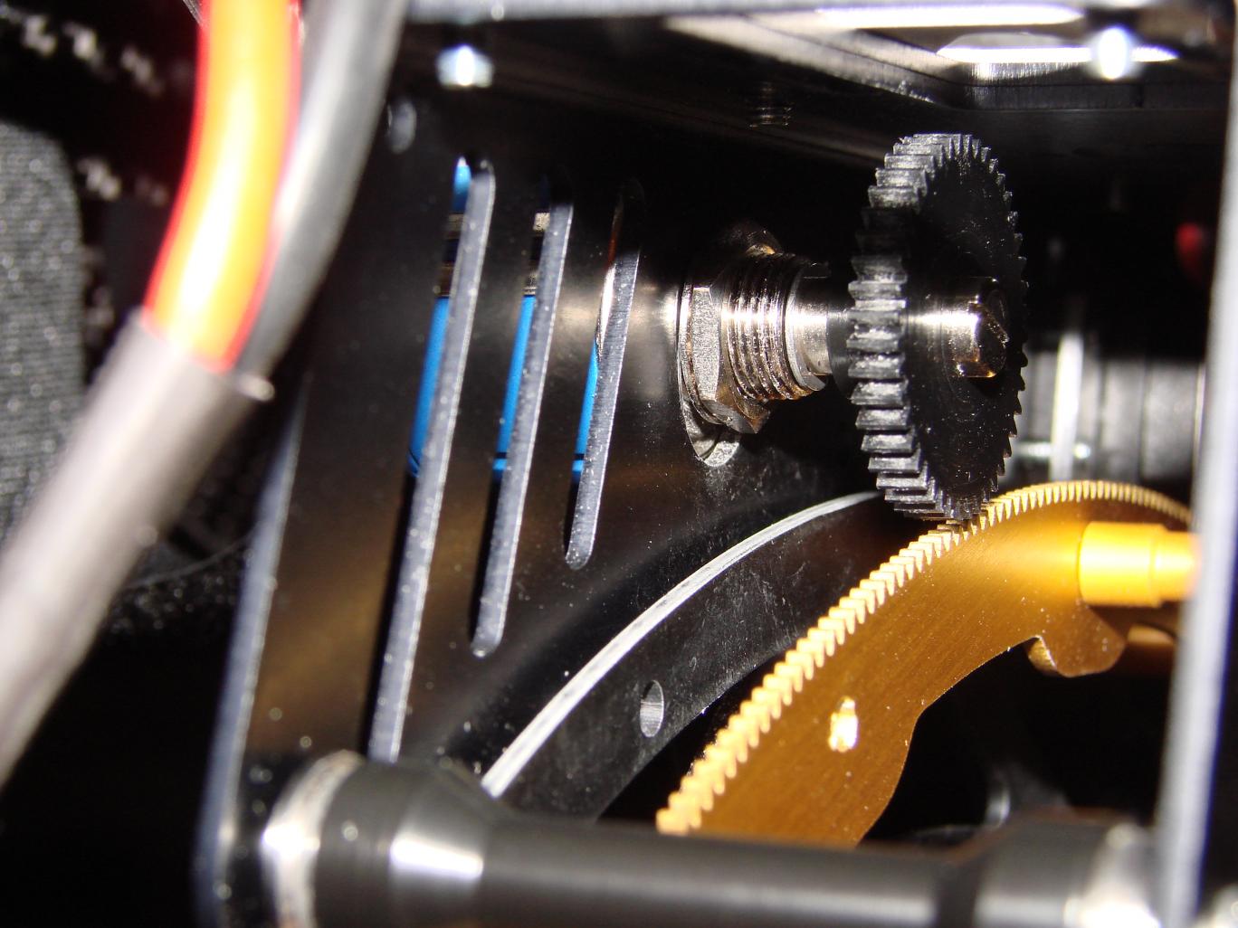

I'm having another problem with the pro200 mount, the nut to hold the roll pot gets loose. The hole that the pot shaft goes through the frame is quite a bit larger than the shaft. When I try to tighten it it loosens after a few flights. The last flight could have been a crash but luckily I had the gopro on and not the 7d. anyone else had this problem and any solutions? thanks Shaun

post some pics of the spot where the pot goes through the frame. i'm sure we can come up with something to make it right.

Hi Bart: here are some pics you can see at the bottom of the thread how big the hole is. Shaun

shaun,
i might be completely wrong but it looks like the hole is oversized to allow you to adjust the gear mesh. I'd cut a piece of 1/16" plywood to fit in that area and drill a hole to match the diameter of the roll pot. use a couple of really small dabs of epoxy to hold the plywood (not so much that it'll never come out but enough to keep it from shifting when it's assembled) and then assemble everything before the glue sets. the plywood will hold the lock washer and keep the position of the pot consistent.
you might get a few more ideas now that you have the pics posted but i'd think a layer of something on the inside will get it back together nice and tight. once you have it all worked out put a small dab of CA on the threads with a shot of kicker to cure it before it seeps under the nut too much.
hope that helps,
bart
baker55
Your right Bart the hole is oversized but it really should be a slot to allow the pot to go up and down. I'll try the thin plywood idea. thanks
