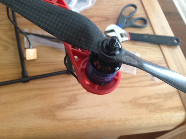

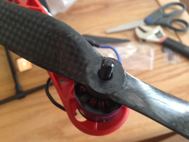

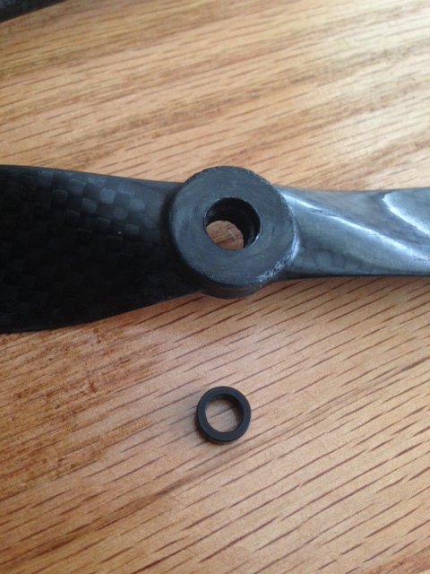

are my propellers too loose? (Video and Pictures)

They don't look horribly loose. Do they feel loose when the adapter is clamped down on it? That disc that goes on top should tighten them down secure once the nut is on there.
there should be a diameter listed with both the motor (shaft) and the prop adapter. Make sure they are not the wrong adapters for the shaft size. Also, grab some Nyloc nuts if those aren't already. They will hold much better than a typical nut.
