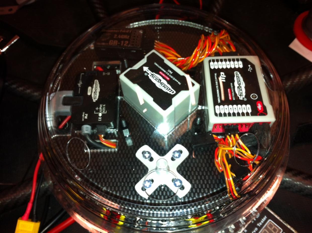

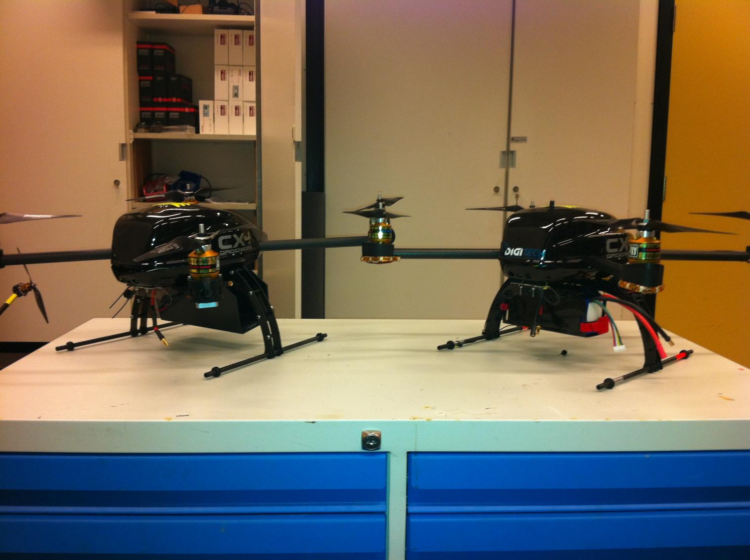

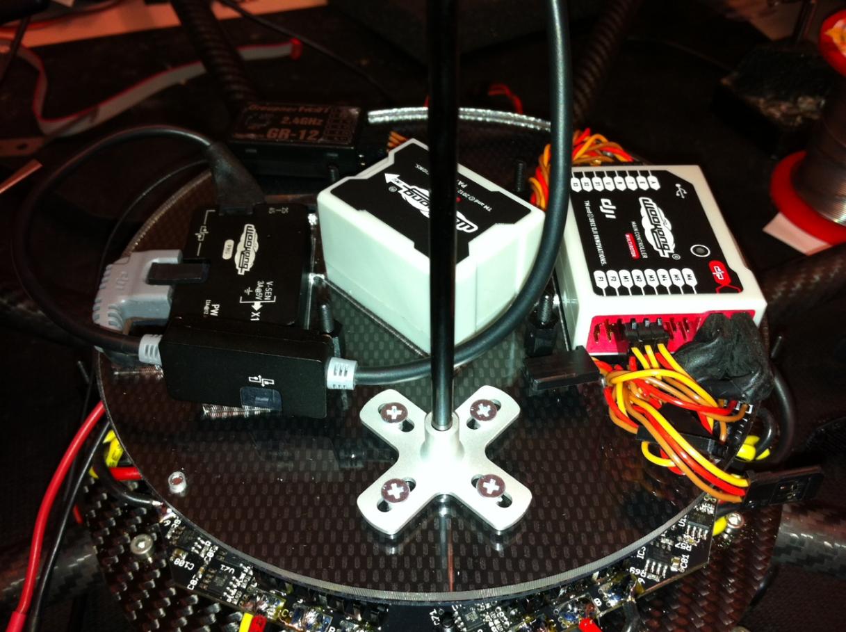

Guest
View attachment 1829its basicly finetuning..
as soon the aerodrons are ready for end users all will work ok on all systems.
i am busy testing all systems at the moment.
my CX has now a 6S 8000 under its belly
i am testing both CX one with MK
other DJI
both have herkules boards
same engines
same props
