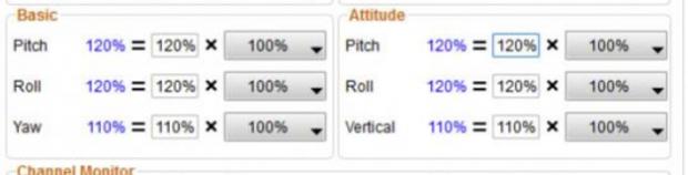

What I am asking is.. looking at this image here (Not my settings, just a random screen shot)
What are the main differences of Basic and Attitude?
So.. what I am asking is... if my rig is flying very nicely but I want to smooth it out just a tad (ie. loosen it up some)
which gain setting do I change?
If it gets a bit touchy in the wind what would I tweak?
I have Basic Pitch and roll assigned to 1 knob and I have attitude Pitch and roll assigned to another knob.
Anyone have some sweet tips?
Thanks in advance!

Basic controls how the craft reacts to external influences, wind, changes in attitude, altitude etc. ATTI gains controls how the craft reacts to stick inputs. Think of it as expo. The higher the number, the faster it reacts to the sticks, lower is less responsive. DJI test pilots like high ATTI gains but they are in their 20's. You do what feels right for you. For me 90+/- feels good with 30% expo. But that said, I fly the P2 and P2V at default settings. If you are getting too abrupt reaction to flight, then you might want to lower the basic gains. If it seems sluggish, you may want to raise them. DJI suggests raising the gains by 10% and test fly. Continue until it oscillates, then lower by 10% I have raised my Basic gains to over 200 when flying in wind. This is where the BTU and the Assistant App come into play or you can use a knob or slider on your Tx to adjust while in flight. It is up to you.

I rekon set the atti gains a touch less than basic, u seem to have them set identically so thats why ur rotor is very aggressive on the sticks. Going of the top of my head so dont quote me, those settings dont look like Dji A2 recommended settings for the S800 Evo. Maybe you used wookong values?

Those are not my settings, they are just a random screen shot from the interwebz. I did use the suggested S800 settings since my rig is 800mm and around the same weight.
