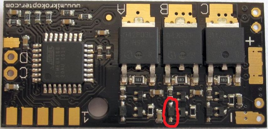

I was mounting my new Okto XL distribution board when I guess my finger knocked the piece circled in the pic below off. Can't believe it came off that easy. Anyhow, can it just be soldered back on? does the direction matter? Bummed:(

i'm so sorry to see this happened. if the part came off cleanly then you should be able to clean the solder pads where it connects and reattach it. use a touch of flux to help the solder flow and stick. if the part that came off also broke as it came off then you can try to source a replacement component or just call quadrocopter.us and ask them how they'd like you to handle it. given your time constraints do you have time for them to send you another one?

Yes it can be soldered.. I had the same issue while soldering my PDB. I splashed solder over one of those tiny IC and while I was trying to clean, that IC was already at loose. I think those are filters. Use a big magnifier while soldering this.
I don't know exactly about the polarity, but I carefully placed it exactly the same way like on the other BL-Ctrl.

The time gun pointed at me is what makes it so frustrating. It did not break, just lifted off at the two solder pads and the two little tabs are still sticking out from it. I don't trust myself soldering something this small. Do you think if I took it to a TV repair place they could do something like this? I know a little mom and pop shop that I drive by and I could go by there tomorrow. Argh...one step forward two steps back.

I believe that is D2 diode. If so, it is polarized and has a marking band on it. I think the TV guy will get it right but check afterwards just in case.

@#&$! Well, the TV repair guy lost the piece! We have both been looking around his bench and can't find it. Does anyone know a part number for this thing? It had a W2 on the top.

Thanks Crash! I also found the first one you suggested used by someone over on rcg with no problems. I went ahead and ordered a couple of each and the smallest tip available for my Weller soldering iron to take with me. I also ordered another BL as a backup and Adam at Quadrocopter.us is sending me another diode he found on a trashed BL which was nice of him. They should be here Thursday so the TV repair guy gets another shot.
