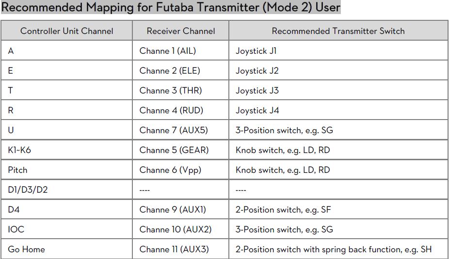

Also I see that it has 10 channels versus the 14 previously available for the T8FG Super.
So I am wondering if 10 channels is enough for the DJI - A2 with all possible A2 functions.

Looks like a lower-cost unit than the 14SG/8FG - but if Futaba are going in that direction then expect to see firmware updates for other models which add that menu. Not sure of the benefits other than saving the irritation of having a picture of a heli or plane on the display ;)
that is there entry level line of radios, love the j series, till now there has never been more than 8ch.....we use 2 man rigs, i dont mess with ioc or return home, i use all the ch for gains and i don't need more than 8. biggest difference in this and 8fg is the is fhss, not fasst
