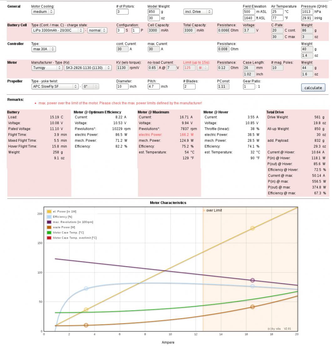

Ho do i interperate this?
it does not take in account theirs r4 motors or 2 Lipo'sView attachment 15984

Motopreserve
You need to change the number of rotors to 4. Put your frame weight in where it now says 850. Next to that change the drop down to "without drive" since you have all the info to plug in (it will calculate accurately based on components).
In the battery section, change configuration to 2P for 2 batteries.
That at should get you closer.
Motopreserve
It has a red section to tell you that the choices don't work well enough. You need to start changing things in there that will make the red go away, and maximize your flight time while being most efficient.
See where the red sentence says "power?" Then you look up And see the box that is highlighted red. That is the issue for your set up. The motor can not handle the wattage that you are requiring if it. It's a sophisticated dance between the battery, motors and props to get a happy balance.
NeilM
So by reducing the prop size to 8" its in the black however it says it too heavy now, or am I reading that wrong.

Motopreserve
Well, the frame weight is listed as 1200 grams which is probably 3 times the actual weight. Which frame are you using???

Motopreserve
If you are plugging in all the components separately - then you choose "without drive" and in the "model weight" you input the weight of the frame. The program calculates the weight of all the motors, ESCs and batteries (you will see this weight listed on the right of each area). Or you can do it the way Jay mentoned - and choose "including drive" which means it will ignore the individual components and calculate based on your total AUW guess.
With the setup the way you have it in the photo above, it shows no red (good), decent flight times (good) but very low payload (not so good). Continue to mess with it until you have the best possible flight time, hover throttle around 50% and the greatest payload. That payload will be for all the extras - like camera, Rx, foam insulation, tidbits etc.
make sense???
If you plug in the Turnigy D2830-11 1000kv motors, with 10x4.5 props, that gets you up to 891 payload, only 43% throttle to hover, and about 24 minutes flight time (obviously that's high because it doesn't take into account gunning the throttle.

If I choose inc. drive (1200gms) I get;
For minimal maneuverability you need Throttle of less than 80%
NeilM
even with 1400gm weight ( I do require 8oz payload) I get the same throttle message and times of;
Flight Time:13.5min
Mixed Flight Time:13.0min
Hover Flight Time: 15.1min
Hover
Throttle (linear): 94%
Motopreserve
Are you still calculating using the old motor??? This is what I get when I plug in your numbers with the Turnigy 2830 drive, but using your number of 1200 gram weight.
