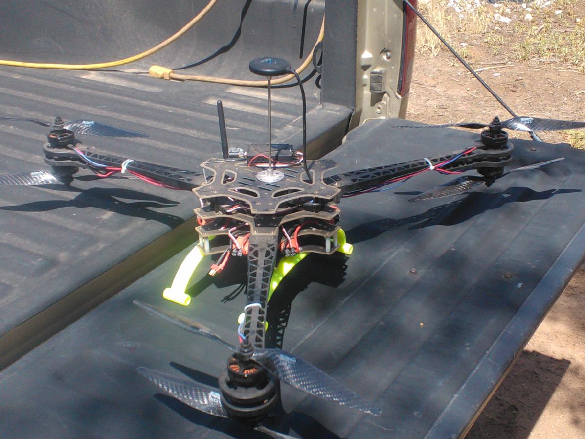

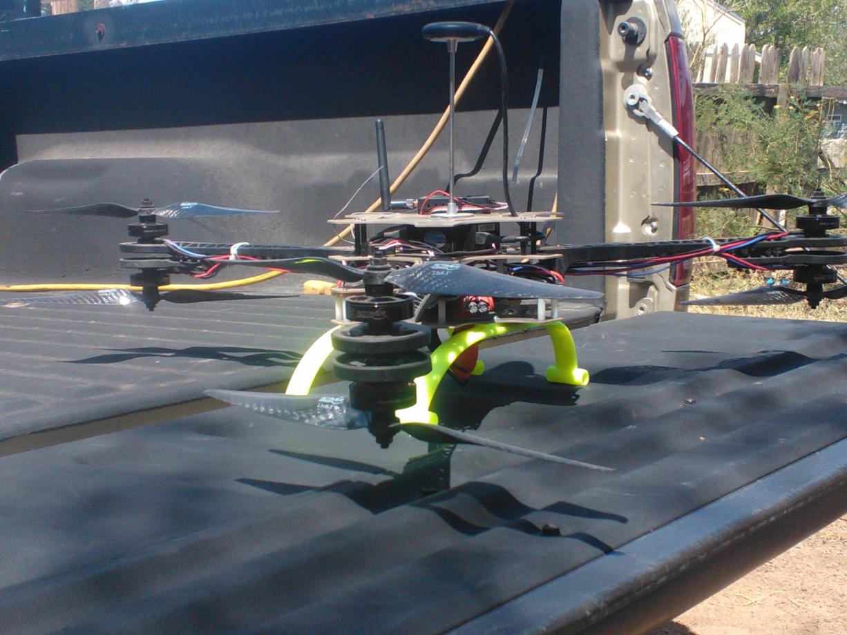

the YS x-4,x-6 while larger in footprint than an naza, are not noticeably higher than the naza, and will fit between the frames of the rct 800, if that is where you want to mount them. i used a second set of mainframe plates in order to mount the fcu away from the distribution of power board integral with the lower frame plate. probably a good idea with any controller. also used the extra plate from that second set to make a LG mount below the power distro that raises the copter up so that the bottom 3 motors of my Y-6 configuration had more ground clearance. coupla quick photos to illustrate. have no video of it flying as yet, and all the video from it is proprietary. when it cools off a bit here, been toping out at 50-51c lately, i will get someone to video it flying.
i use 4s 3000 mah in config shown. go to 4s 6000 or 5s 5000 when carrying a cam. also go to 14 5 props when loaded.
