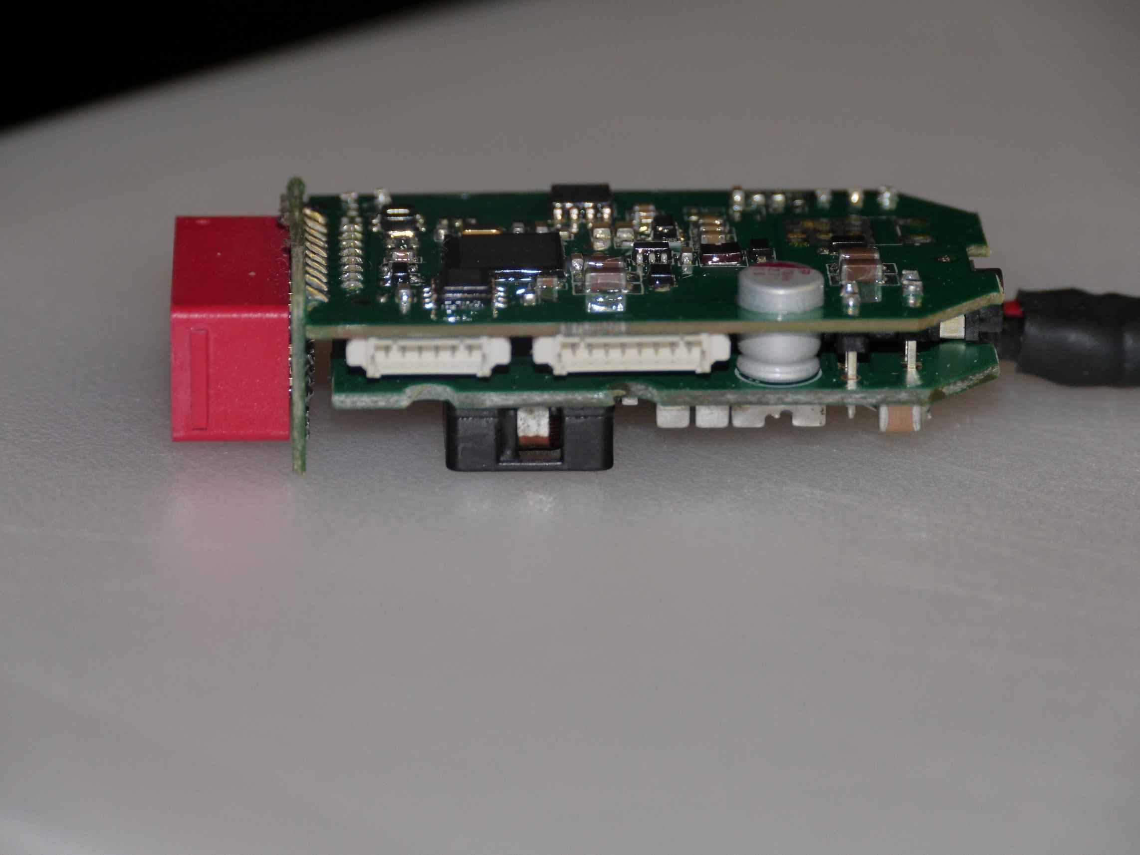

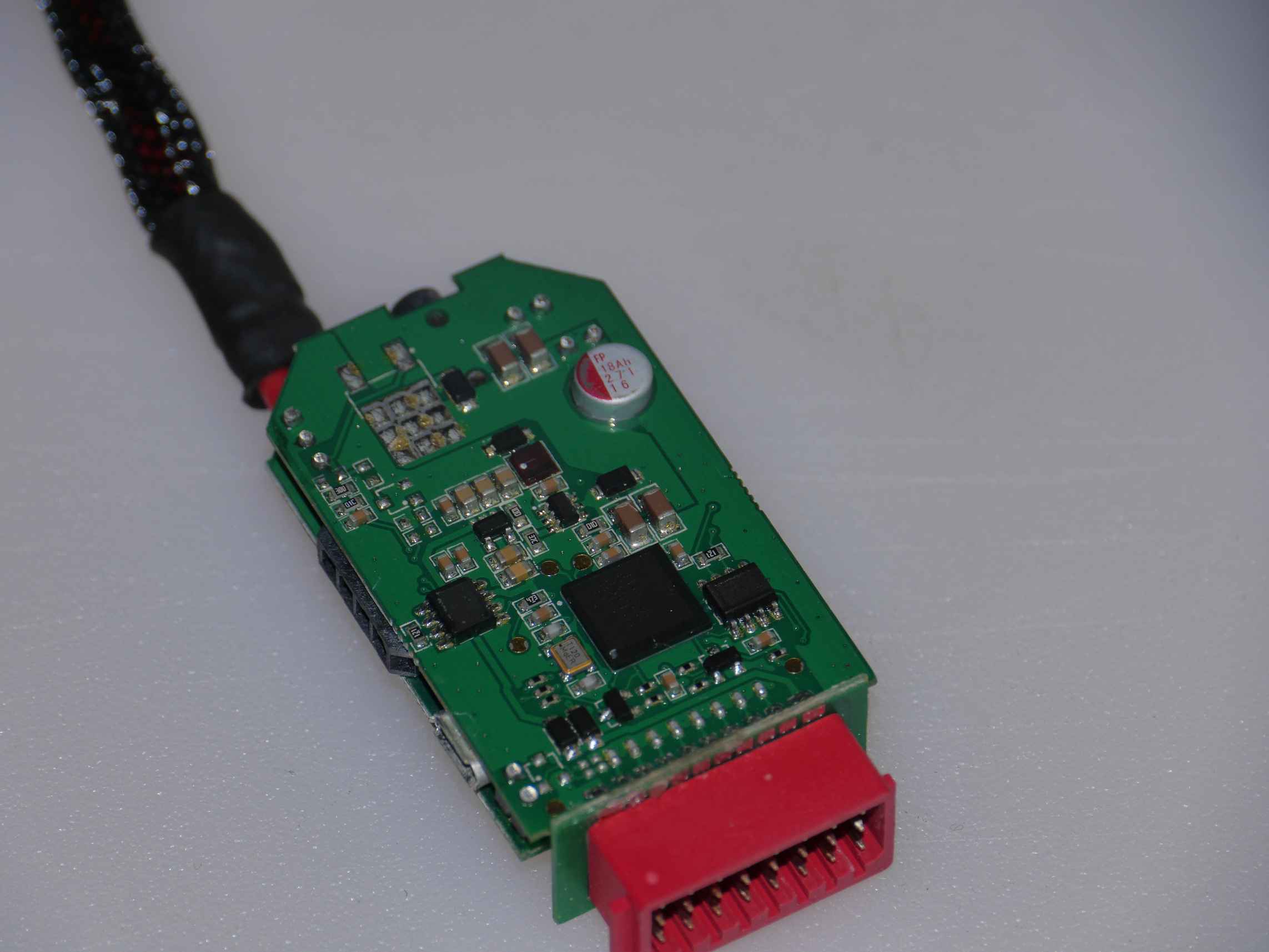

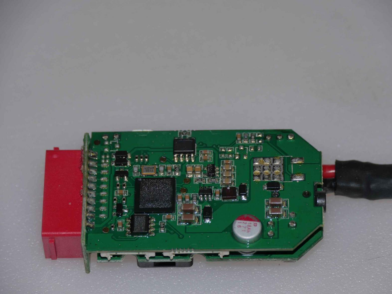

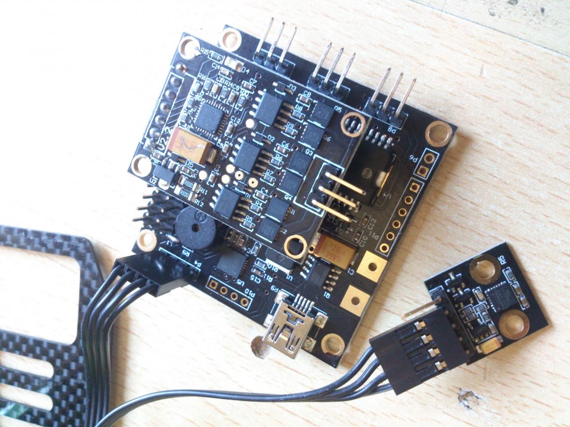

i'd like to see what the components in your GCU look like....feel like opening it up and posting some pics?
ChrisViperM
