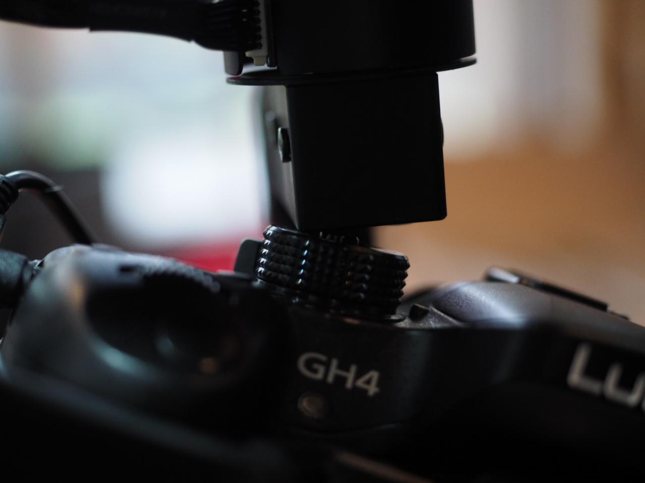

I think somebody mentioned this earlier but I just can't believe what I am seeing. The top of the gimbal touches both the mode and drive select drives which of course screws up the initializing (and completely scratched the dials on the GH4). Is this something that can be tuned? What did I miss?
HELP!!
HELP!!
You mean like this guy? http://youtu.be/_X_ENU8d-rA
Somewhere else I ran across a procedure for loosening the set screws and re-balancing the whole thing. Not DJI approved of course but your alternative is to send it back and wait four weeks for another one I guess, which will probably also have some kind of issue.
Tahoe Ed
Hey thanks! I will try that. I find unbelievable this type of issues for such an expensive item...
I am sorry that you are experiencing this. It appears that DJI switched vendors and there is some calibration issues on some of the gimbals. As was stated, you have two choices to correct this.
