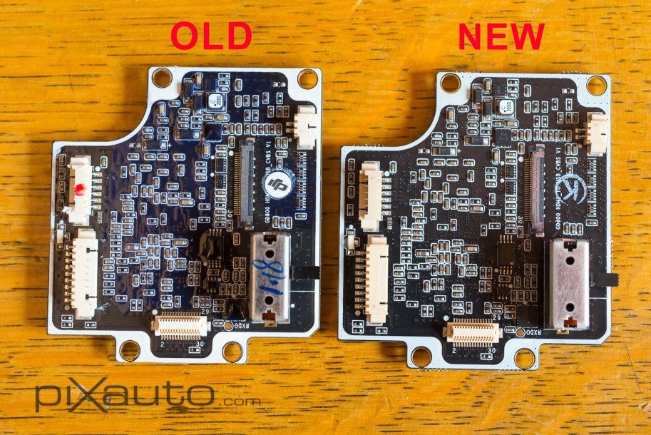

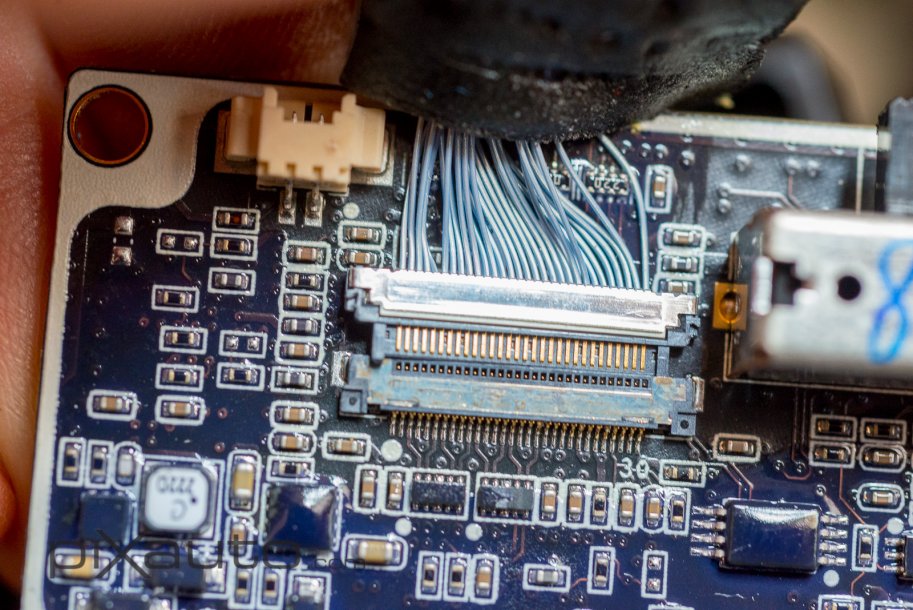

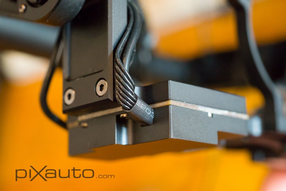

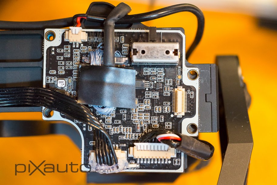

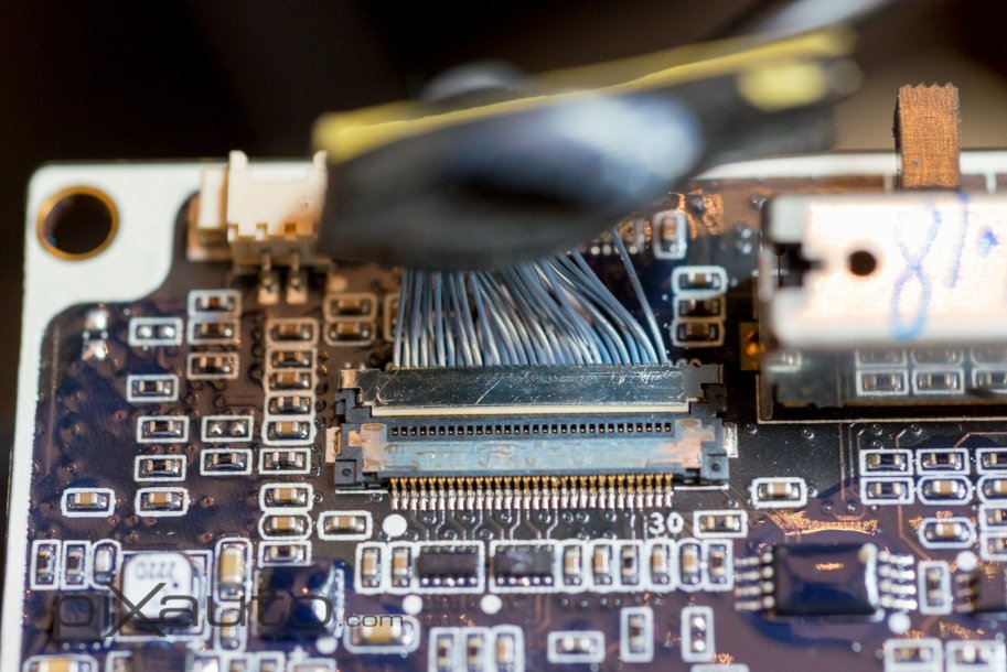

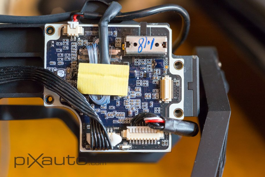

The new HDMI board is here and fitted. Can anyone tell from looking at the boards what's different? The only thing I can spot is the lack of covering on the chips. Maybe this just allows enough temperature from the chips to warm up the other components? Here are a few pix in case you are fitting it yourself. Take care if the ribbon cable is stuck to the cover with double sided foam tape, which our original gimbal had. It's pretty tricky getting those ribbon cables etc out. The white multi-pin connectors catch on the components, so you have to lift them slightly as you pull them out. The image worked straight away at room temperature. Now for a temperature test, except it's now too warm outside....
