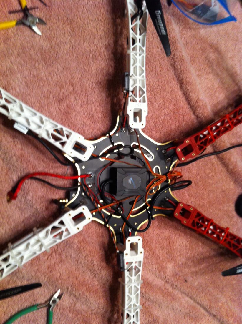

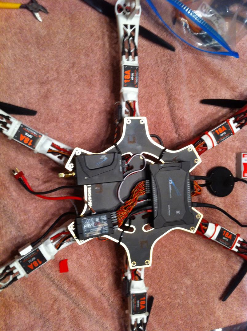

I got mine in today. I agree with the build quality. The mast provided is huge 15cm. I am not sure if I will use it or another one that I have that is half the size. I have mounted everything on my F550 test mule. All I have left is to connect the motors, tidy up the wiring and set up the network. Unfortunately I will not be able to fly until the weekend. I may take it with me to Lake Tahoe and fly it at a proper altitude of 6500'. Lovely views from there and a good place to test without interference. Unfortunately I do not have an Android and I refuse to jail brake my iPhone so I am left with using bluestacks.com for their Android PC emulator. I am hoping that it works better than the Mac emulator that I tried to set up. It was so slow that it would be impossible to use at the field, let alone control the craft. According to V at gothelirc.com the software for PC and Mac are coming soon. He also indicated that Apple has approved the app and the fees have been paid. So now how long will it take Apple to respond and put the app on iTunes? I am hoping sooner than later. But it is good news never the less.
Here are some photos of my build:
View attachment 4370View attachment 4371View attachment 4372

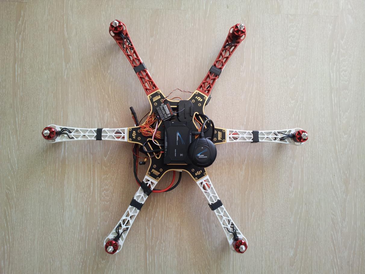

Well I had my first flight too. Mounted it on a F550 with dji esc - motors and graupner 10x5 on 4S.
After I reversed my declination to -4.2 I get much better position hold too. I would say that some gains need to be tweaked a bit but the YS-X6 flies with crap esc a touch better than Wkm with reflashed esc. I need to do some more testing after I get back from a business trip and I will try and do a video as well.
I too am unable to get the mobile hotspot working but the router will do for now.
An updated manual would be nice.
