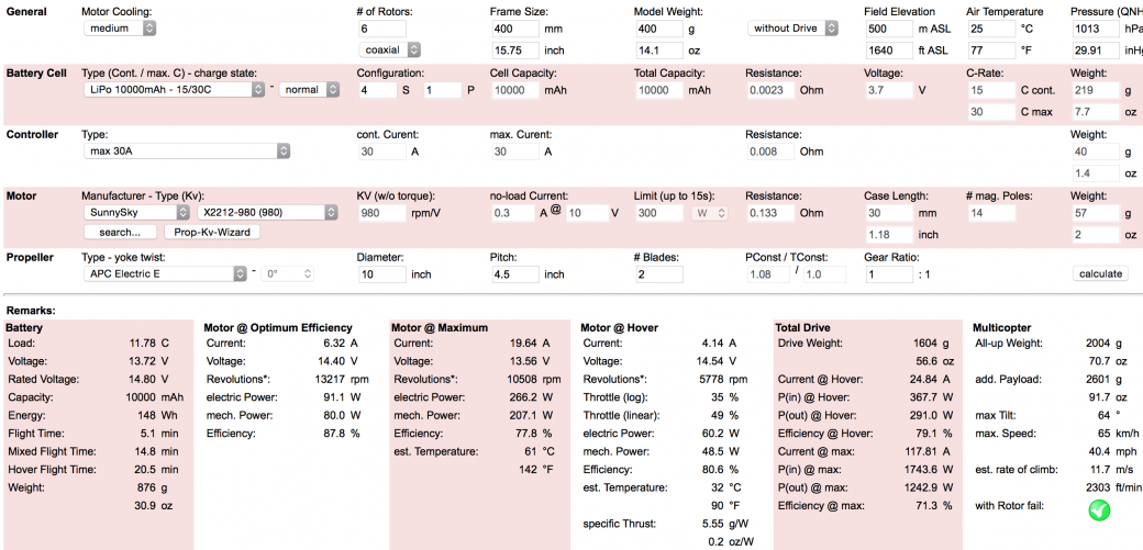

something like this? (auw is a total guess just to give a baseline for comparison)
interestingly to me, switching between 3S and 4S doesn't make a huge difference all things being equal, except for being slower with 3S.

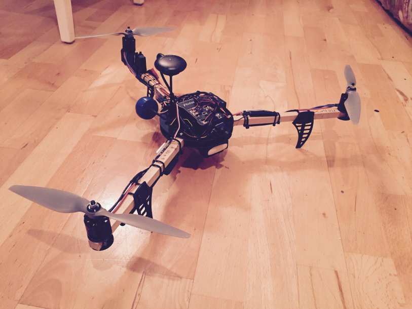

hey @sledge57! I should have it together pretty quickly for you guys to check out (hopefully some video too; burned up a B&H gift card on a GoPro 4 Black). The tricopter we fly is essentially the same config 3 motors shy and obviously with a simpler FPV setup:
If you do go with a "real" Pixhawk I would still recommend the RCTimer M8N GPS. They are great and a generation newer than what 3DR sells. I work with GPS product development and am all too familiar with the differences.
I may not have time for a real build thread but I'll do my best to share results.

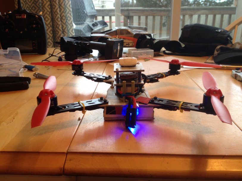

crayfellow
Here's one for you guys - I know per ecalc this guy will be OK with the 804g battery (HK had a crazy deal on MultiStar 4S 10000mAh... flight time!). But do you think I will want to use extended arms to make it stable? By default an Electrohub ends up equivalent to about 400mm.
the battery will be underslung.

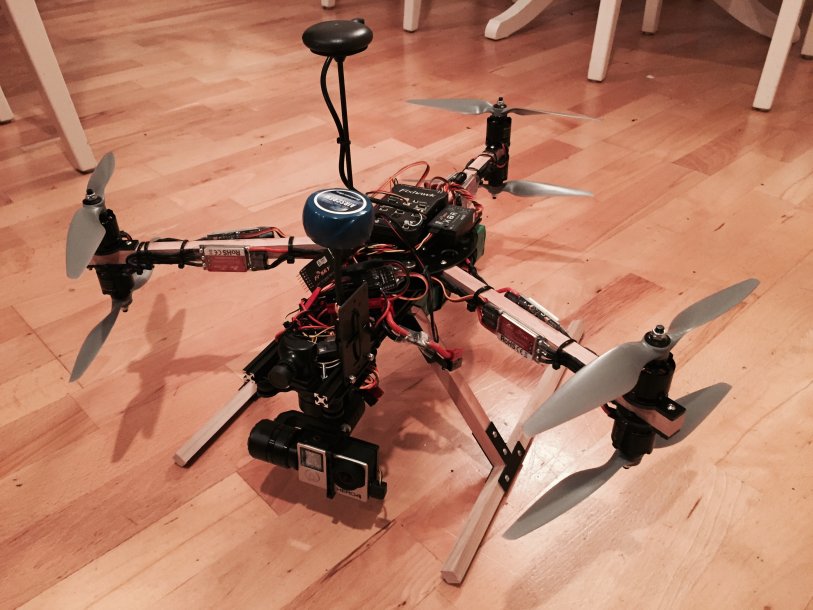

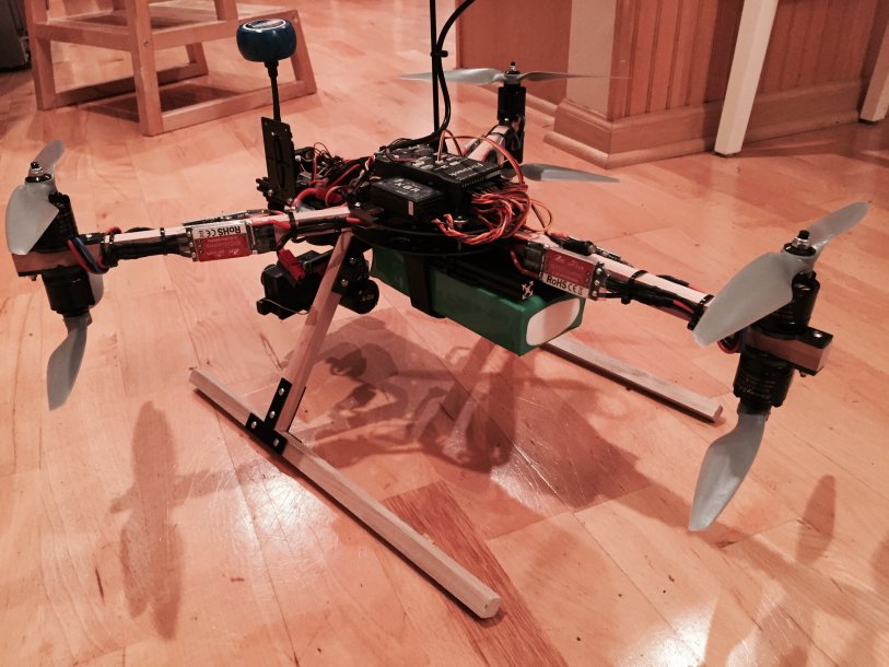

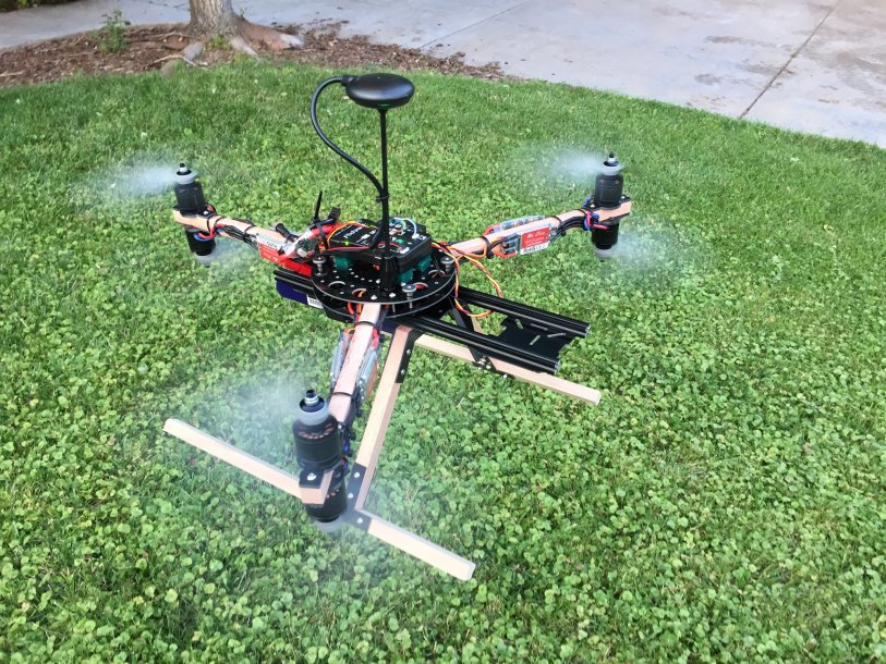

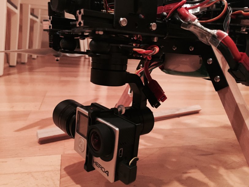

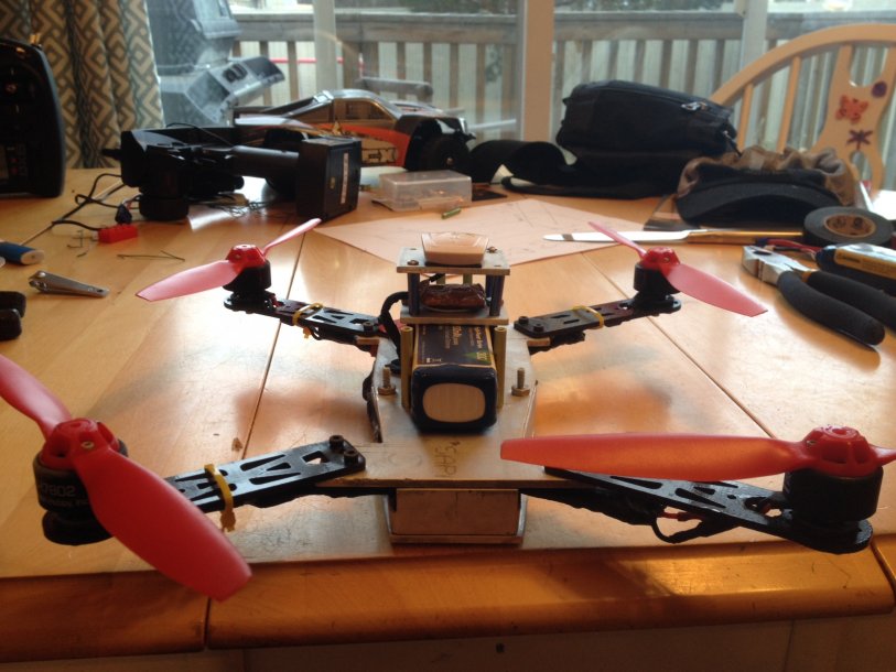

Well here it is! Flying here yesterday on 3S 4000mAh sans payload or FPV:
Today it flew with 4S 10000mAh and full payload. Lots of fun to fly! Haven't tuned anything at all, so that is next. I can already tell this guy is going to be very useful. As you can see it's still very much in 'prototype' form, which is exactly what I need. Flight camera and GoPro are on an RC switch. Between that, UBEC, LC filter, and gimbal there are a lot of wires to contend with up front. But the rails were really nice to work with!
View attachment 26037 View attachment 26038 View attachment 26034
