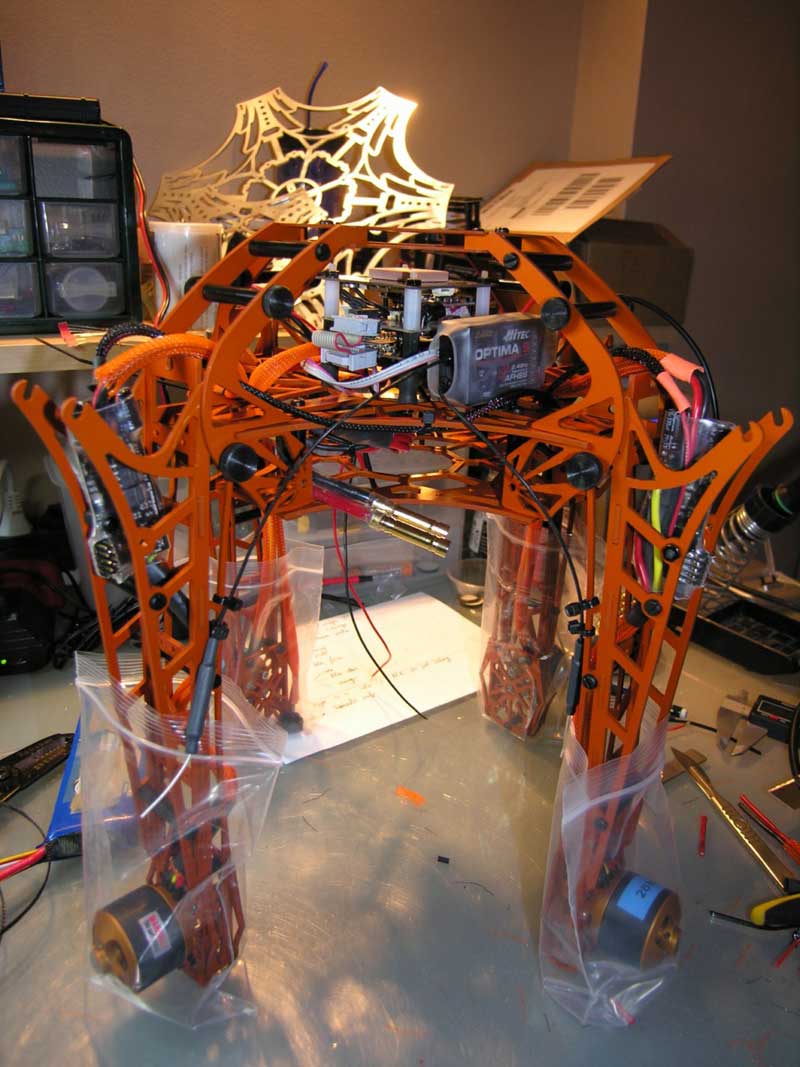

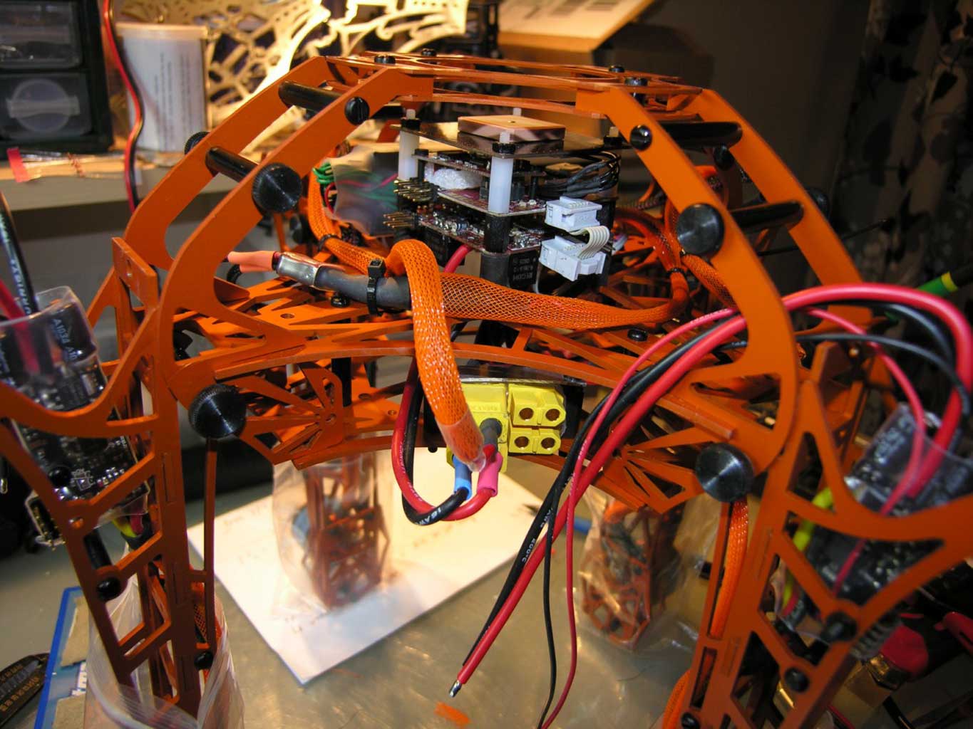

I'm mounting an X8-600 orange anodised for a customer.
Here are some pictures ;)
View attachment 107View attachment 108View attachment 109
I have to finish it (2 arms are fully connected, the 2 other ones will be made this evening)
I made the alim distribution with 6 Xt60 connectors and the I²C distribution with a 2x5 connector.
This will allow a quick unassembling of one arm if you have to change it for some... reason (don't say the word please :D)
