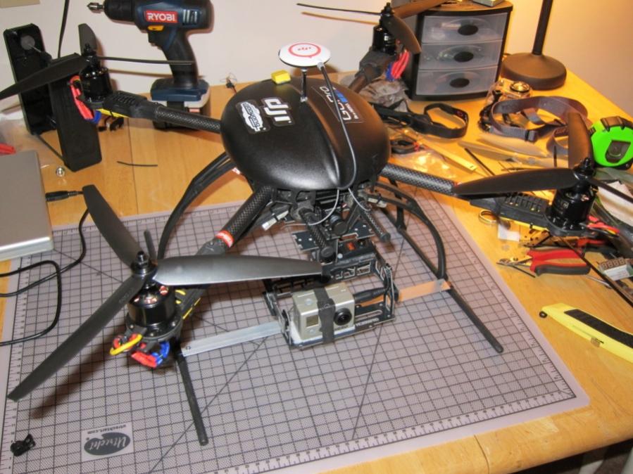

So finally got my build taken care of this weekend. I'll be posting some pics & video soon, but I had to jump on here first and just let everyone know how impressed I am with not only the DJI, but the Avroto motors. They run as smooth as can be and have some great lift! I haven't even begun to dial this thing in all the way, but I can already tell I'm going to be a happy camper! Stock settings out of the box got me some of the most stable flight I've seen to date.
More to come soon.

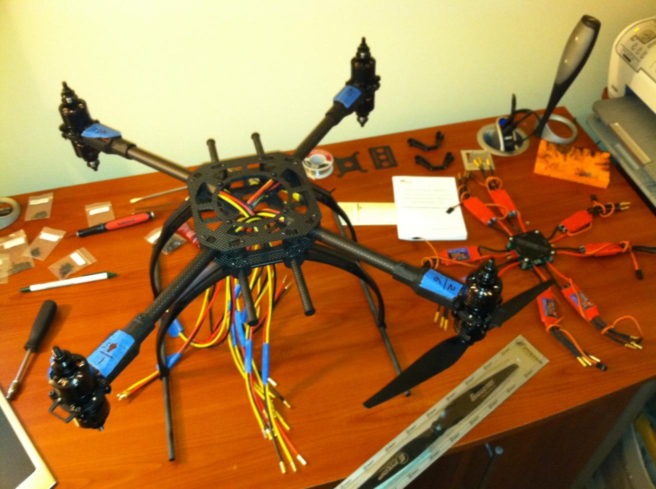

Nice setup Kilby, I've been following you, Dixter, jhardway, Exopackshiu and some others on your setups. I just got a bunch done tonight on my first build (x650 v8). Went with Avroto 2814's, Maytech 30amps, T8FG, DJI WKM, Graupners, a gimbal coming over from Germany, probably going with HX9v. The "Replacement After Market Motors for the xAircraft x650 v4/8" thread was a big help to me. So.....hello! I'm sure I'll be asking you guys some questions in the next couple weeks! Did you mount your IMU in the middle? If so, what did you use to prop it up like that? Maybe a pic with the "lid off"?

How's it going, janoots. You are going to have a ton of power with 8 of those motors spinning! Can't wait to see that thing in action.
I put my IMU dead center on the CF plate that used to hold the FC1212. I think I was getting high frequency vibes there, but I just remounted it and used a zip tie this time also. It seems to be better than ever. I always got 2 flashes for my mode indicator before, but since the remount & new props it's gone down to just one for the first time.
