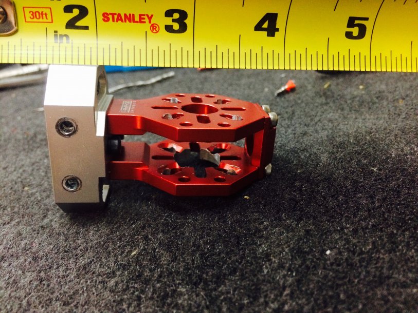

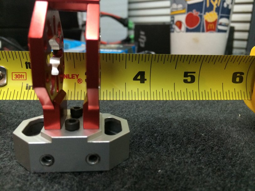

It's about 15/32" from the plate to the top of the mount so 1/2" spacers are perfect.
Pumpkinguy
It can take a max motor diameter of 50mm if you machine the hole bigger like I did for a larger collar.
