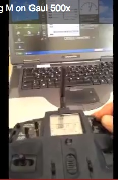

i've posted this in the german section too. As you can see, i a not able to start the Motors on a Gaui 500x with the new installed Wookong M.

I see that your VU blinks fast red when you try to arm. On my NAZA this means "no signal from RX" - as soon as I switch on my TX the red blinks stop.
Looks to me like a TX -> RX problem

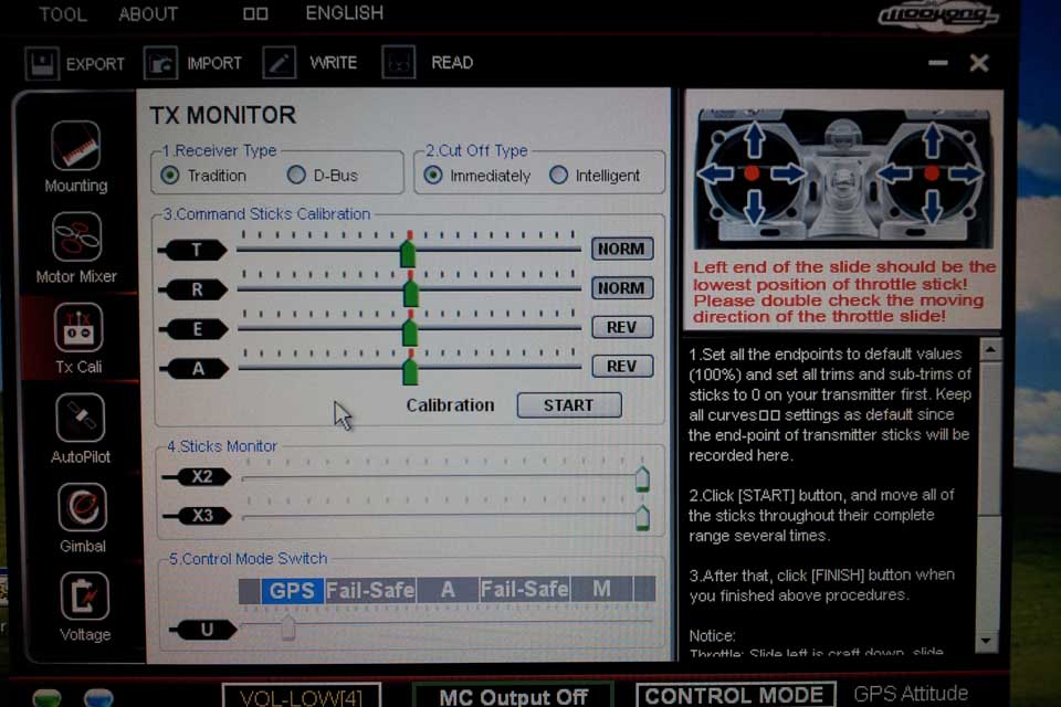

just a thought if you set a failsafe switch , must be turned off before arm the motors, also i noticed on your calibration screen travel stick position all black it suppose to be Green when all stay neutral position ,check all your connection MC to RX
shiu
agreed on the green bars........ at the bottom of the same screen is where you set atti, gps and manual, is that blue and highlighted in the corresponding box? hard to see from the angle of the camera. That red light is generaly low voltage protect, is the Voltage monitor on? is it setup for a diff battery than your trying to use? Is the heli in failsafe mode

cant see if the usb cable is still connected, but if youre connected to the set-up app the motors arent going to spin. you need to disconnect the usb cable, then try.

@Exopackshiu and kloner: See the attached Pic, if i have Throttle at 50% the bar is green, ist that ok? The corresponding blue boxes for setting are highlighted. also when i switch between the different flight modi.
I have tried to re-calibrate my TX. When starting calibration i can not calibrate the sticks, i have to change the Mid-Position directly on the TX to have green bar in the mid and for having movement to the left and right of the Wookomg Assistant....

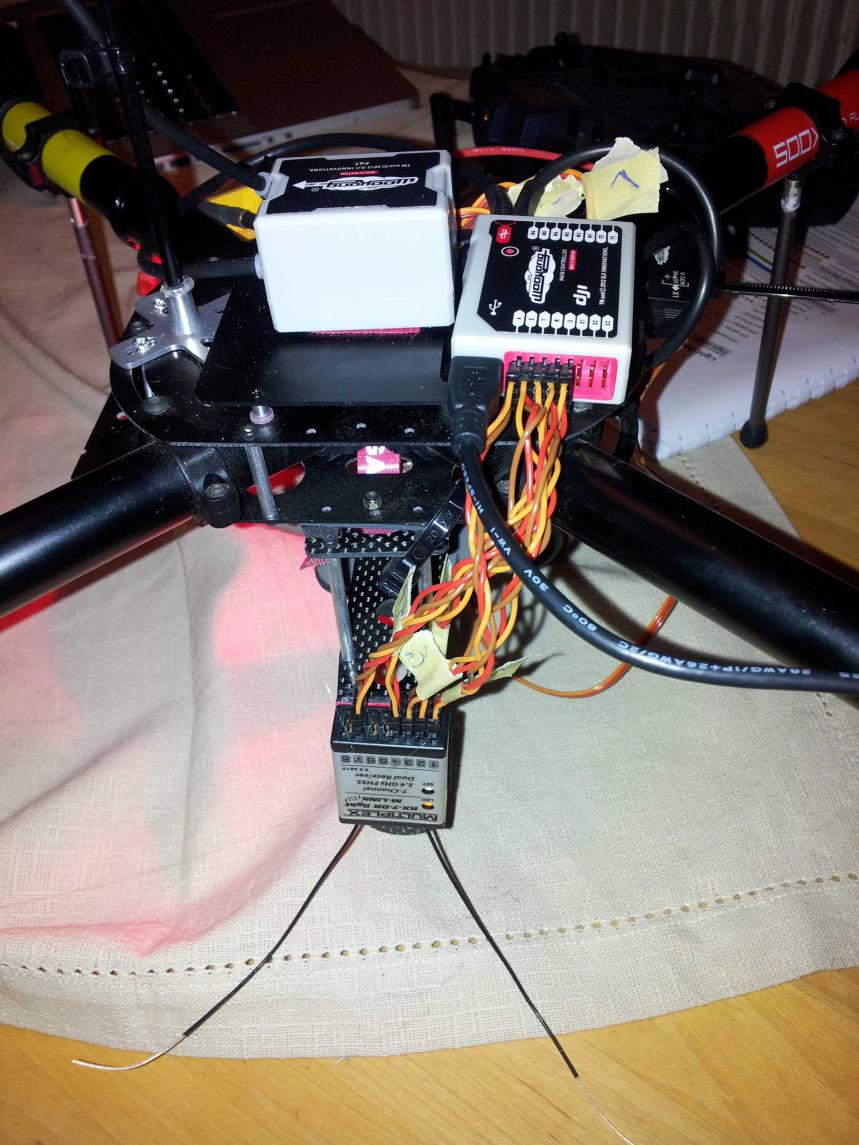

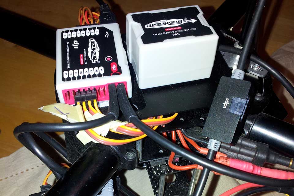

Yes, checked all the Wires again, see also Pics attached.
3 Way Switch is enabled and working. Brought it outside for Sats, the led needs 3-4 minutes to pass from 3 red flashes to 0 in Manual, and yello/blu blu flashes in Atti/Gps Modus. I noticed that the jello/blu flash is not a single spark, but a double spark.....

Aren't the brown wires suppose to be at the top? looks like all the wires are backwards unless wookong is backwards from naza. I'm shooting from the hip
edit, just read your manual, they are suppose to be signal at the top like you have.....

meme wrote this already in the german thread, here again are you sure your throtle is correct and dosent need to be reversed ?
It looks like it in your video: Throttle is up but your slider for the TX is not all the way on the right !
