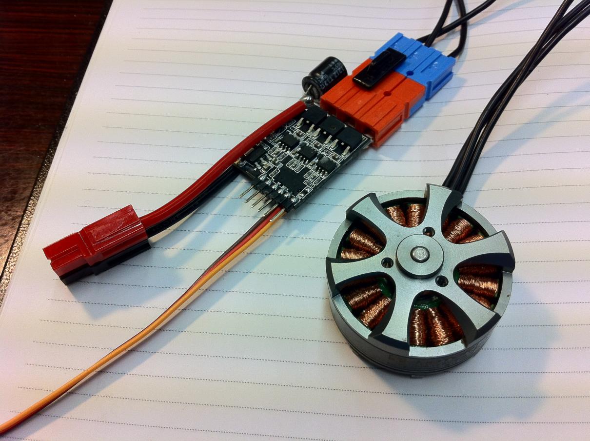

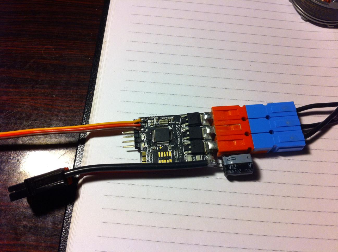

This is an ESC32 I was playing with the other day - Andersons for power and motors :highly_amused:
The black shape on top of the blue/orange connectors is a locking piece - guarantees the connector can't come apart in flight. The orange Andersons are soldered straight to the PCB (using Anderson's special contacts designed for PCB attachment). The blue/red/black ones are crimped.
(Eagle-eyed viewers will notice the middle FET is blown, and one of the legs on the capacitor. Serves me right for buying a cheap copy of the ESC32 - it was just for an experiment so I thought I'd chance it.)
