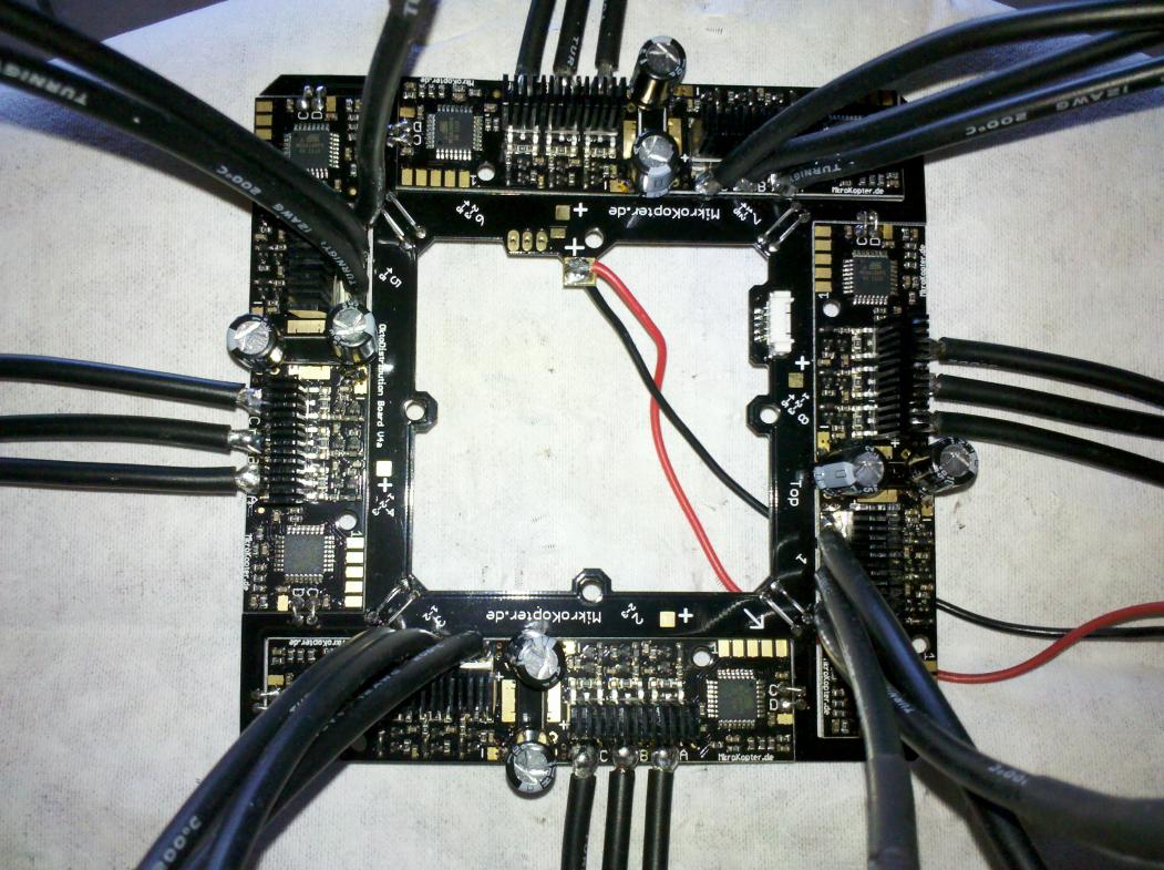

OK so my build is completed, now I need some advice for the maiden flight. Can I assume that with the first flight in attitude mode the hexa will not take off until I am past half throttle? Based on the fact that half throttle is the hover point or will this depend on total takeoff weight/thrust available. I just want some idea of what to expect. Any advice on gain settings/adjustment, I have them all at default for now, should I have other setting dialled in on my spare TX 3 position switch ready to switch to increase or decrease gain from default.View attachment 1679
Pulso U28s, 30amp ESC, Hyperion 5000mah 4s, 13 6.5e APC props, DJI WKM, AV200 360 mount, Droidworx AD6 360 frame Not sure of total all up weight yet but it feels heavy! will it fly? Haha.
