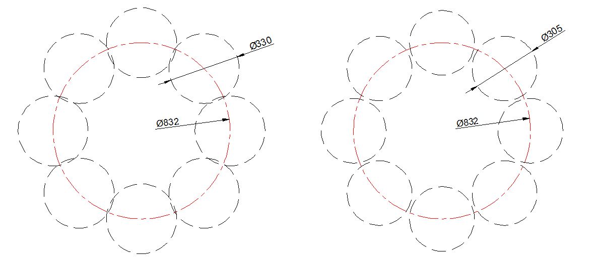

Someone else might be able to help sooner, but if you can tell me motor to motor dimension, I can draw it to scale and tell you if it will fit or not.

Measurement from Center motor shaft to the Center of the next (to the right ot left) Motor shaft is 32 3/4 inches. Is that the correct info needed?
Not sure...what I need is the distance from the center of the motor shaft, across the center plates, to the motor shaft on the opposite side. It sounds like it is the correct dimension though, that's about 815mm which seems about right.

I have drawn it up - if you have measured it like I think you did, then 13" props won't fit. 12" do fit, with 13mm distance between tips.

13" will not fit the old frames. The old frames are still being sold because reseller want to get rid of the first....
New ad frames have 430 booms wich will support 13" they say.
What motors will you use is the question... Ecalc it first.

I just bought an AD-8HLE and was not sure which props would work best and, since the Droidworx spec sheet indicates either 12 or 13" props with 430mm booms needed for 14" props, I ordered two sets of 12" and two sets of 13".
The 13" do NOT fit 410mm booms.
