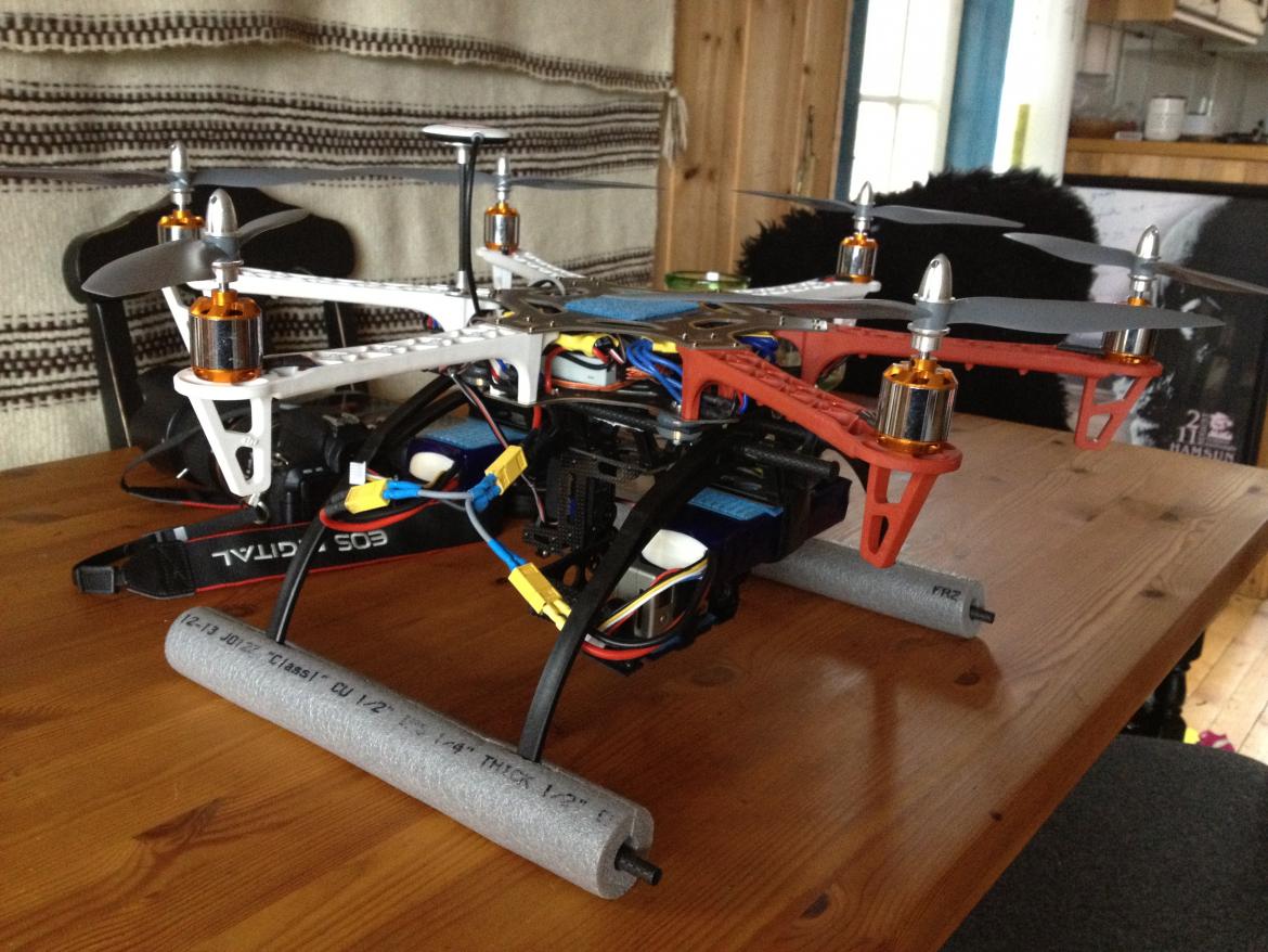

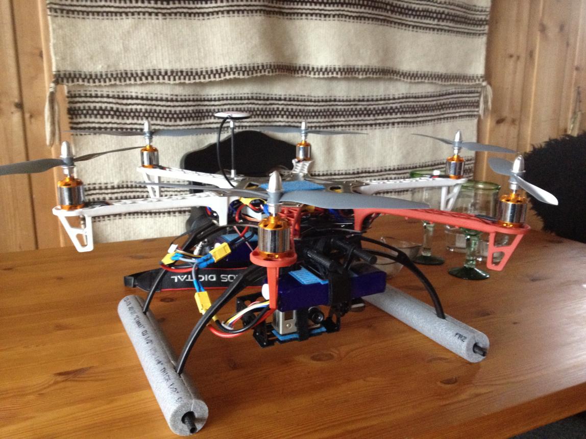

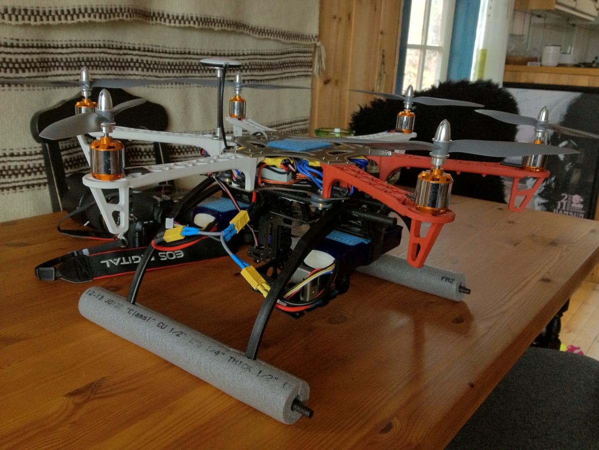

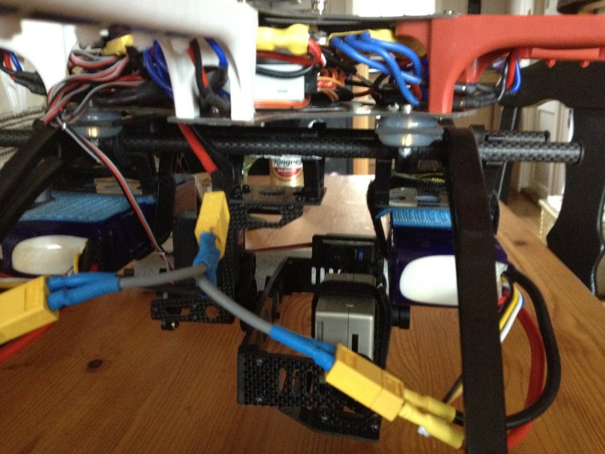

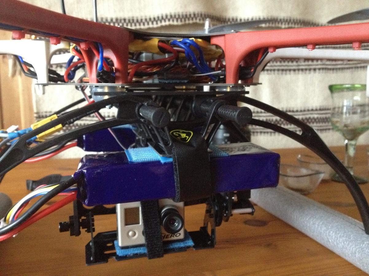

While I´m waiting for the S800 and the Z15 I use this F550 with great joy.
It has the folowing setup:
DJI Wookong-M
JDrones 880 kva motors
JDrones 10X45 EPP prop
JDrones 30A esc
XAircraft 2 axis Gimbal
XAircraft frame with suspension for batteries and gimbal
Homemade attachment between FW550 and base with silicone dampers
GoPro with Sunex lens
Turnigy nano 4500 mah 4S 25-50 Lipo (x 2)
Spektrum AR8000 RX and DX8 TX
Waiting impatiently for new stuff from China.

Kilby
I'm in the process of building something very simular. How is this working for you? Shot any video yet?
Tomstoy2
A great match-up! The bottom end of the XA is the best part about the Hexa, the only lacking area is that I would love to have the heavier arms and clearance between plates that DJI Hex offers.
I'm still playing with mine, so only using one 5000mah 4s now, buy plan on going to 2 of them, as it can easily handle more weight being added, so seeing how you mounted yours was good timing.
How do you like the Sunex lens on your GoPro? Any chance to post a vid, see what it looks like thru the camera, ( something else I'm considering )?

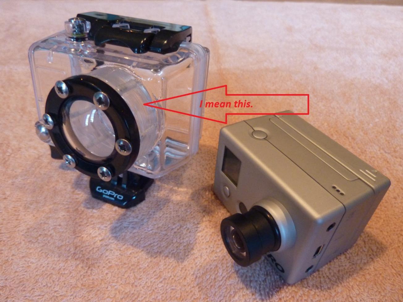

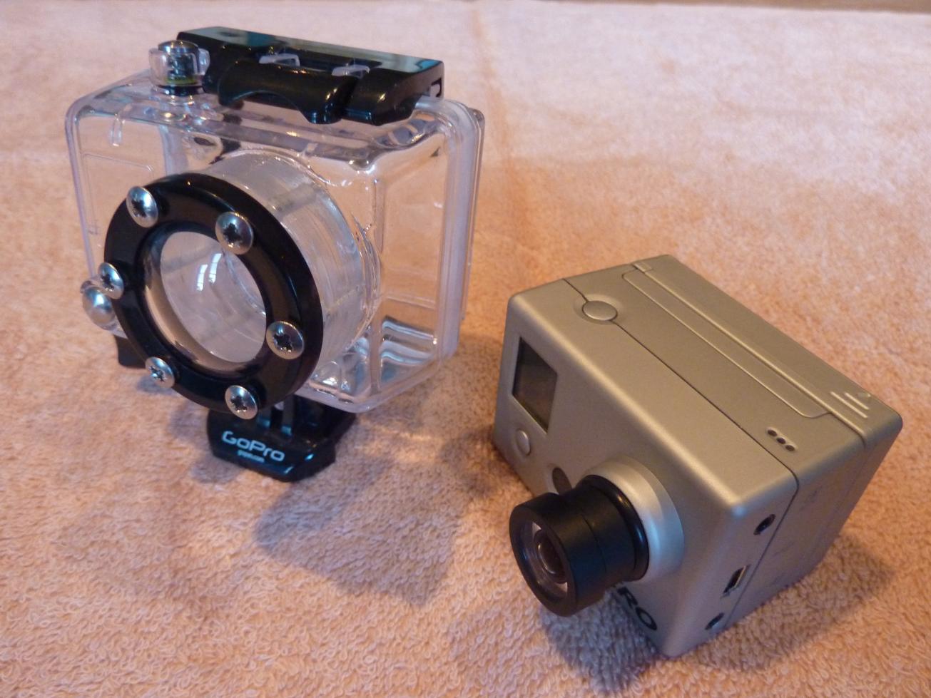

I do the same and now I am looking for a extension for the "hublot". where did you find it?
See the picture.
Oylore
Got hold of a 3mm plexiglass plate. 4 layers glued together. Cut out and drilled a hole corresponding to the origianle the GoPro case. Glued on GoPro box. Used clear epoxy. I have tested in water. 100% waterproof!

Oylore, how are you getting on with the XA 2X mount?
I like your DJI/XA hybrid, best of both worlds there. Also like your case mod for sunnex lens.
jhardway
Oylore
quick question, where did you get what looks like gel pad used for cushion between frame and the landing gear? How do they work? thanks Jack
