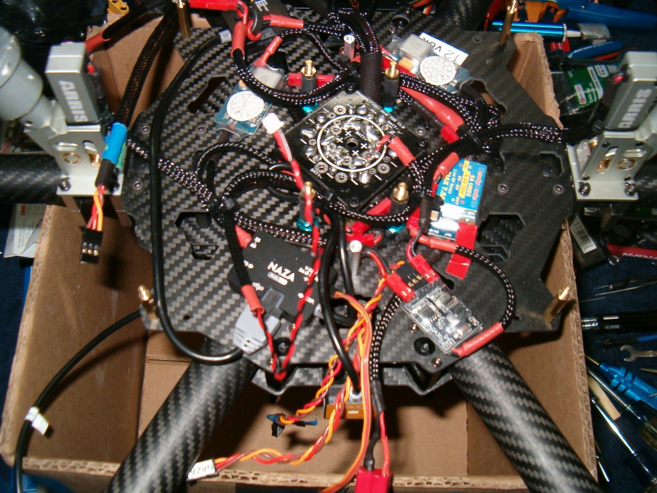

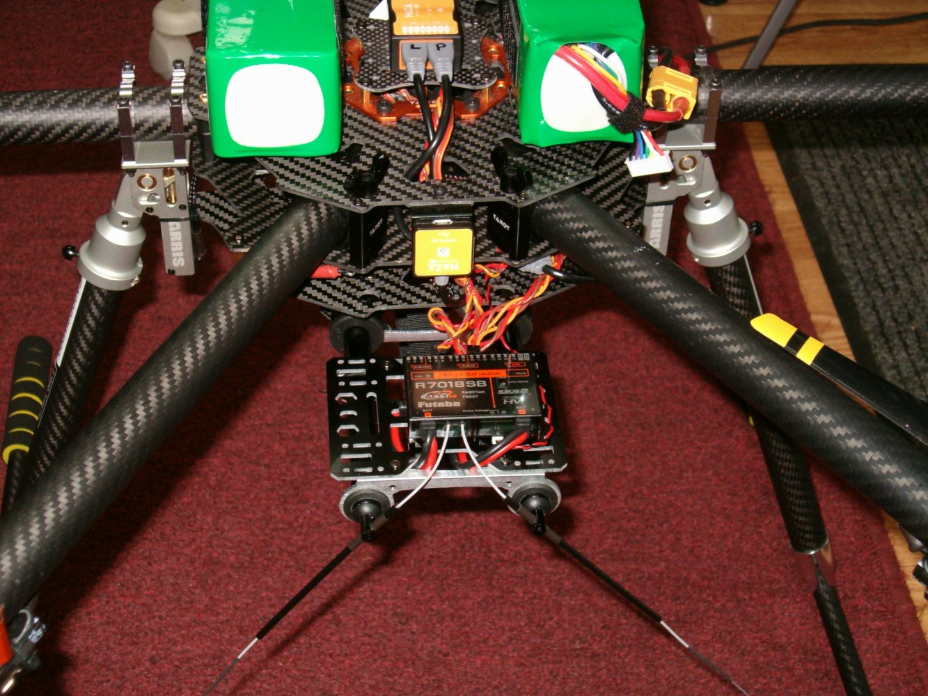

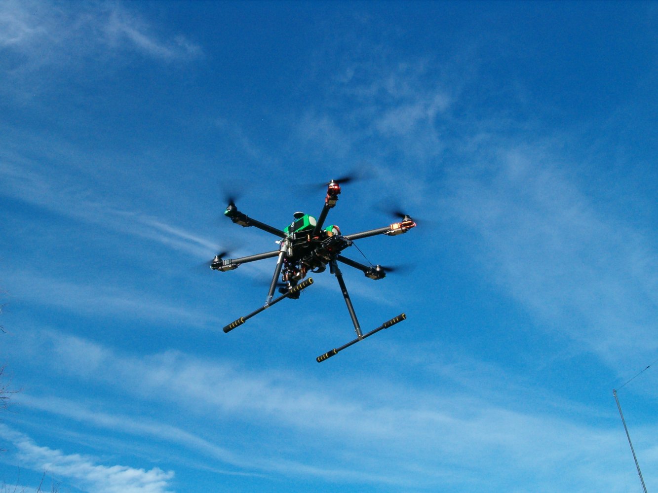

I am running the Naza v2 and the E800 motors. I used an extra bottom plate to hide all
the electronics and with the Arris retracts and two 6600 6s batteries weighs around 5000 gr.
With the two 6600's- 19 min flight and with a 10000 15 min. I think DJI under rated the
E800 system. I have not had any problems and flies fine. I mount the 2 batteries on top
and when I use the 10000, it mounts on the bottom.
View attachment 27841 View attachment 27843 View attachment 27845

your drone look cool, and just want to know you did with extra bottom plate, any change can provide more picture?
Alwil
Since there is not much room between the top and bottom plates, I decided to add an additional bottom
plate. You can see the standoffs in the previous picture where the plate attaches. The camera gimbal and
rails attach to this plate and I did not feel comfortable with just the corner standoffs- hence the four in
the middle. If I have to service any electronics I just take off the 8 nylock nuts and drop the plate. I will
try to get you a better pic.
