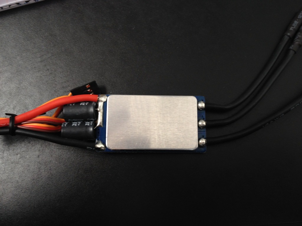

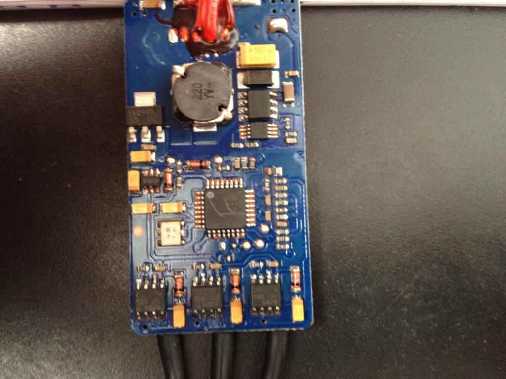

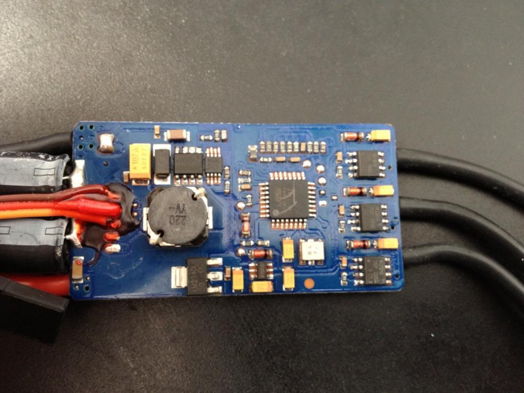

Which ESC it is?
Tonphis
Tonphis
Thats Right, it looks a bit like it. But with less chips.
I think my modul is an 50A version.
Can i flash it with simonk?
jes1111
You need to identify the processor on there - the SimonK only works with certain types (I'm not familiar with the subject, but I'm sure that info is easy to find).
it's the certain atmel chips......... i'm not real familiar with this in a succesful way.
Tonphis
Now i have read the details with a Magnifying glass.
It is an ATMEGA8A AU1039 Chip.
But i could find nothing about simony und these chip.
It is compatible, and which hex file i have to use when i would flash it?
greets and thanks!
Tonphis
Thanks Bartman,
i also know these Page, but there is these typ of esc not shown.
I search for a few days all threads in the web but nowhere is something helpful shown.
At least i have flash the esc with kktool. Finaly i will test my result and the esc starts to burn. :-D The elkos are burst.
