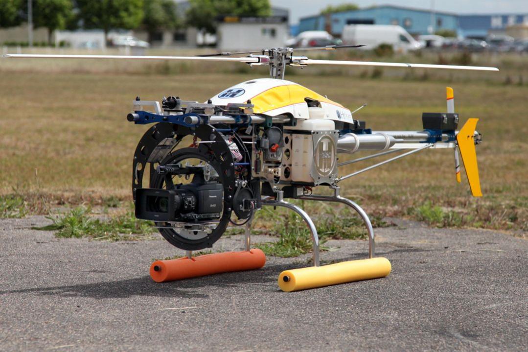

After an initial brief look around I too was keen on a Droidworx airframe but knowing FA about drones and needing to get going in a hurry I plumped for an MK Octo kit just to learn the ropes and see if I liked the platform. If the experience proves to be positive I then plan to go Droidworx with a heavy lift as a backup/alternative for my main machine ...
Your SkyJib sounds just the ticket. Didn't know they were actually available yet. My biggest ***** with electric power - regardless of the type of airframe - is the battery nightmare. Specifically the short flights and endless charging regime. That's why I went gasoline in the beginning. However, that big one (named Sally after my late Mum) is decidedly overkill for a lot of situations, which is why I am looking to add the drone option.
The FC2.1ME is what I was supplied with three weeks ago, along with the NC2.0, and they are both the newest versions. A quick look in KopterTool will show you what firmware version is installed.
Beyond that it's no good looking to me for sound advice with these insects ... apologies ... multi-rotors, because I am as new to them as you I reckon.
And er ... sorry, no B/S this time. We're heading to the Penzance side. :cool:

I take it thats a 26cc gasser in that bird? I did think that route or even a maxijoker 3, but opted fort he octo after seeing some seriously good aerial video. I'm sure someone told me the FC2.1ME comes with navi control built in?????
So your off to see the pirates, enjoy & maybe catch you next trip
