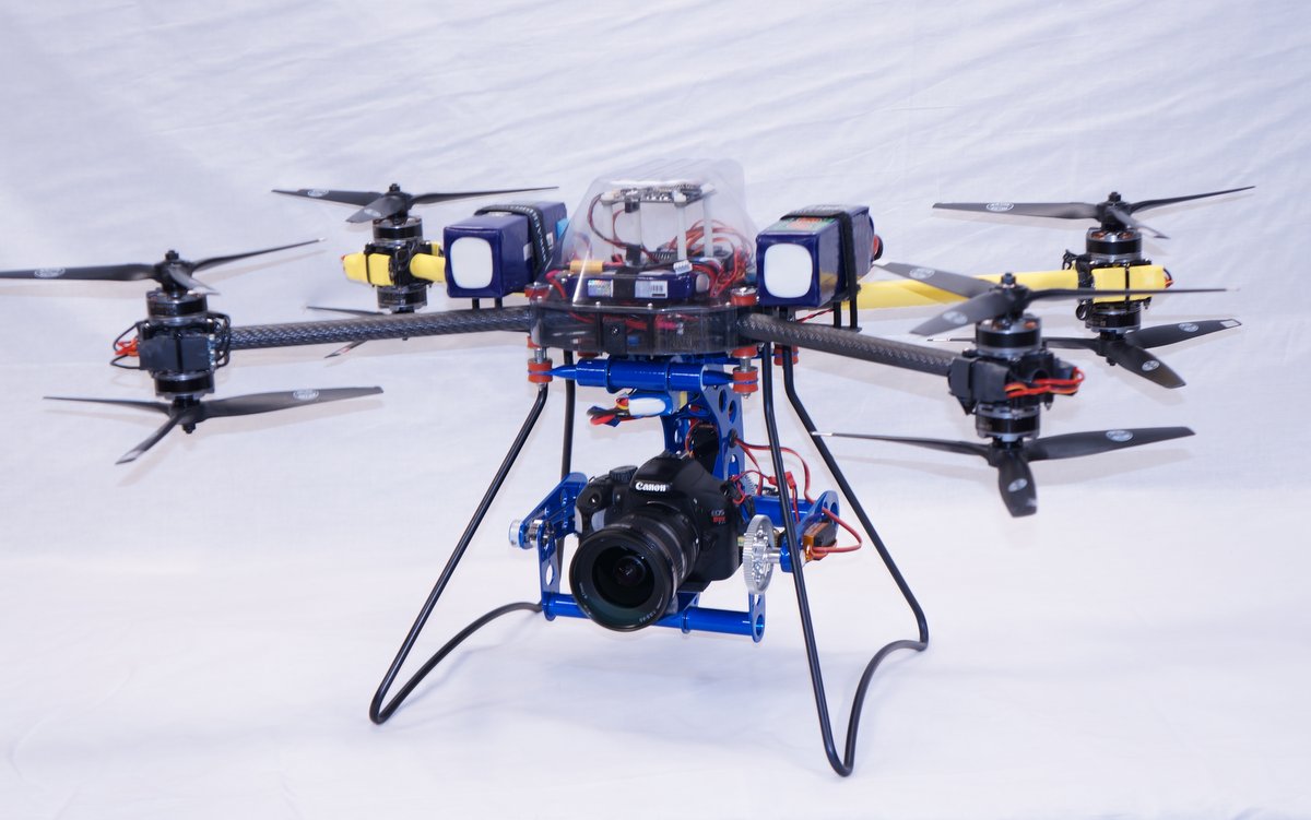

I actually make the gimbals I use.
The one pictured was done in blue on request but they're usually yellow along with the dome so I can have a shot at finding them if they were to ever fly off. Making everything black looks cool but black equipment is hard to find when it's stuck in a tree, crashed in high grass, at the bottom of a stream, etc. :)
The frame is my design too. I've been trying to get a shop set up but that goes back to my comment that it's hard to do anything well when you're doing too much.

Seriously, I like the idea of the machine and the Octi X with 3 bladed props is a little unusual. Does that give you better lift with shorter blades and more efficient flight?
