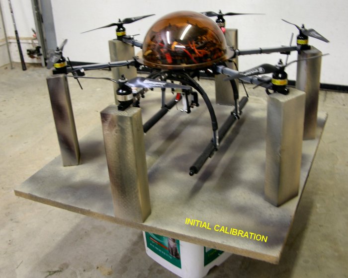

Buzzed
If you don't want to use a cardboard box for the level calibration it's pretty easy to make one of these from some scraps of wood. Mine hangs on the wall in the workroom when not in use.
Guess you could turn it upside down for a Heli Pad to practice landings too.
