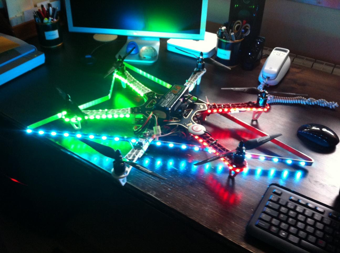

AEA737
Turn some lights on and off?
You can install these lights from Hobbyking:
http://www.hobbyking.com/hobbyking/store/uh_viewItem.asp?idProduct=23792
Plug them to the spare channel of your receiver and power them with your flight lipo. I bought a 2 meter long aluminium rod and bent it like a Christmas tree. It is locked to the F550 arms with zip ties. I fly it at night and the kids (an not so kids) love it. You can cycle 9 combinations of colours/flashing patterns with your receiver. People think they are seeing an UFO:nevreness:

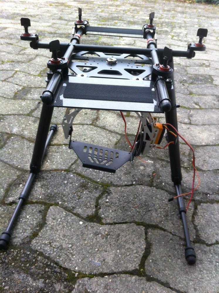

If you want to drop something from the F550 this is what I made to drop water balloons from my Trex 550E helicopter:
http://www.helifreak.com/showthread.php?t=386669
I bought this quick release mechanism from BVM:
http://shopbvmjets.com/zencart/index...qj0dbt5899c652
Have fun!
Javier
