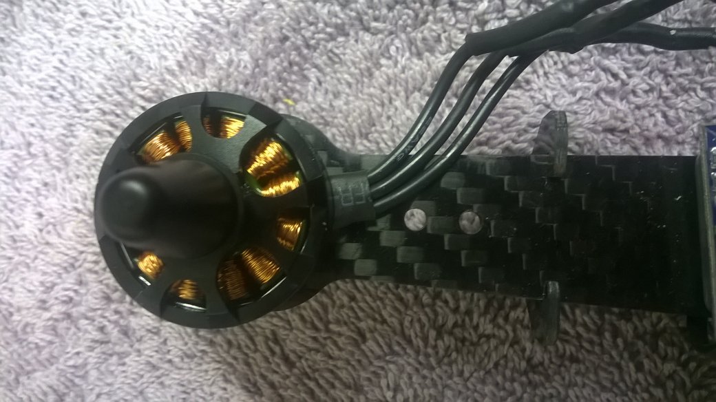

Thanks everyone! I def plan on it. I kinda need help now though, my ccw motors aren't spinning ccw. So I need to reverse the polarity. Could you take a look at my photo and tell me from top to bottom which wires are what? I'm afraid to cut and splice without knowing 100%

If they're not running the correct direction, you just need to swap 2 leads. Doesn't matter which ones. If they are soldered, you'll have to cut them. If there are bullet connectors under that heat shrink, even easier.

For the sake of the quick fox: In the photo, there are 3 motor wires connected to 3 esc wires. Forget the idea of signal (that's on the ESC servo cable).
Any 2 wires can be swapped and will reverse the direction on these 3 phase motors. Doesn't matter which two. Just as long as 2 are swapped from how they're connected now.
Make sense?
Makes perfect sense. I think it goes without saying I'm not the most technologically literate drone builder yet haha. Good news though, got the ccw motors running right! Got 2 liftoffs before breaking 3 props. It didn't have any problem whatsoever getting off the ground but its wandering backwards. The first time I caught my blanket and luckily saved the props. The second time it caught the wooden blinds... Not so lucky. Sucks because I don't have more props but its officially flying. Need to add a bit of counter-balance weight and ill be good to go!!
