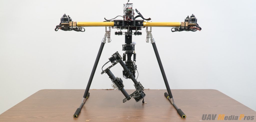

Here's a shot of my 810:
uav-media-pros-5-jpg.27505

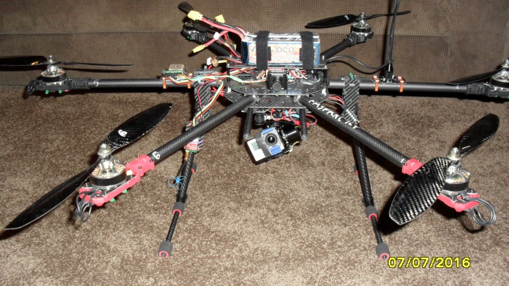

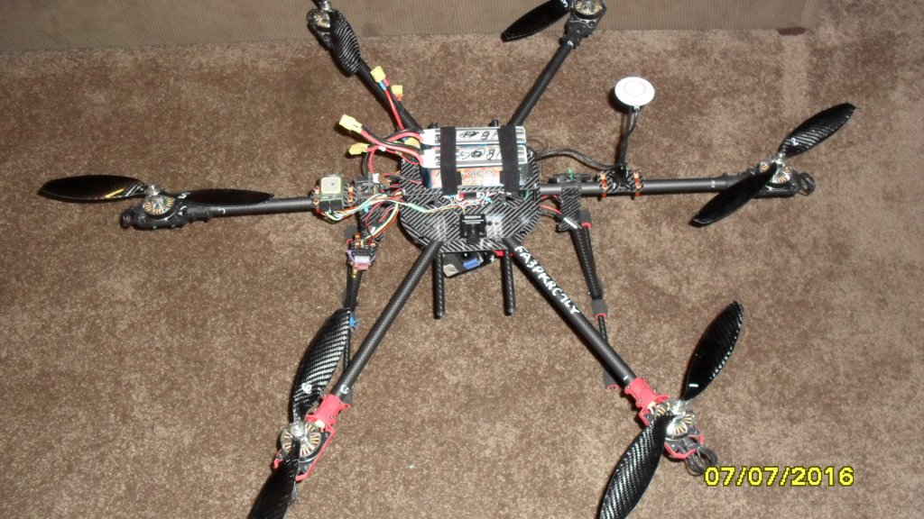

I took an Arris 680MM hexacopter and added longer carbon tubes to make it a 810MM but the actual dimension is 819MM. I only use a cheap 2-axis camera gimbal right now until I decide what to replace it with. I don't think my copter sits as high as yours but its high enough for me right now. That's a really nice looking copter you have Violetwolf and that gimbal is huge lol
