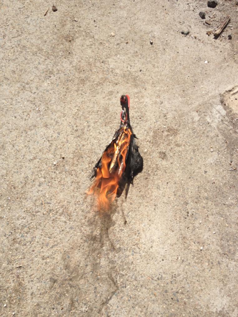

Completely my fault, one of them packs that got left on a ground station too long. When i went to charge it was 6 volts, 3s...... got it up to 7v on 2s settings, switched to a 3s input and about a half hour later she shot fire a few feet a few times in the kitchen and made a bit of smoke. i had it outside like that by the time the fire alarm 10 feet from it went off...... live and learn, got a couple more packs i'm gonna replace asap that have lived a similar life... my flight packs are babied but the ground station packs are abused, gotta change my ways

I looked at the attachment, before I read your post - I thought it was a bird or something feathered... Ha!

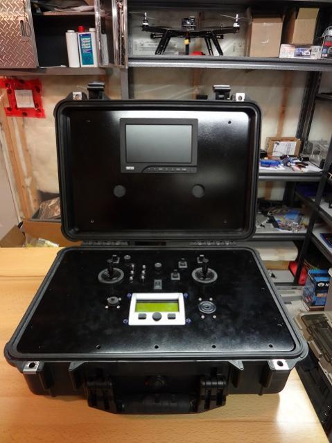

When I built my GCS, I was of course planning on using LiPo, because... that's the only battery available right? My batteries are quite built-in and inaccessible, so I had to figure out how to make the balance plug accessible, etc.
Then I realized... wait a minute... this thing is staying on the ground, why make life difficult? I bought 16 AA 2200mAH NiMh batteries and soldered up 2 8-cell packs, for a total of 4400mAh. I never need to look at them, I just leave the box on a trickle charger until it's time to fly.
Just out of curiosity, what is the advantage of those Anker packs? They are also LiPo? Don't they have the same problem?

Thanks. I wanted something rugged and simple, built specifically to fly Arducopter. Every button has a function, and every function has a button. No extra switches to confuse the operator. And ergonomically laid out. The only issue really is that it's actualy 90% empty space in the bottom. I have to figure out what to do with it! :)
If I could find a small (7-10") super bright LCD display I'd build-in a computer to run Mission Planner.
