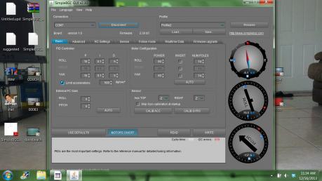

maybe one of you can help me. I've got the three axis rc-timer asp gimbal, was working great for a flight at a local spot, landed and changed batteries. and then the pitch motor started going NUTS when i plugged back in. I've got it home and I'm getting i2c error 878 and the pitch motor has been blanked out in the software.
