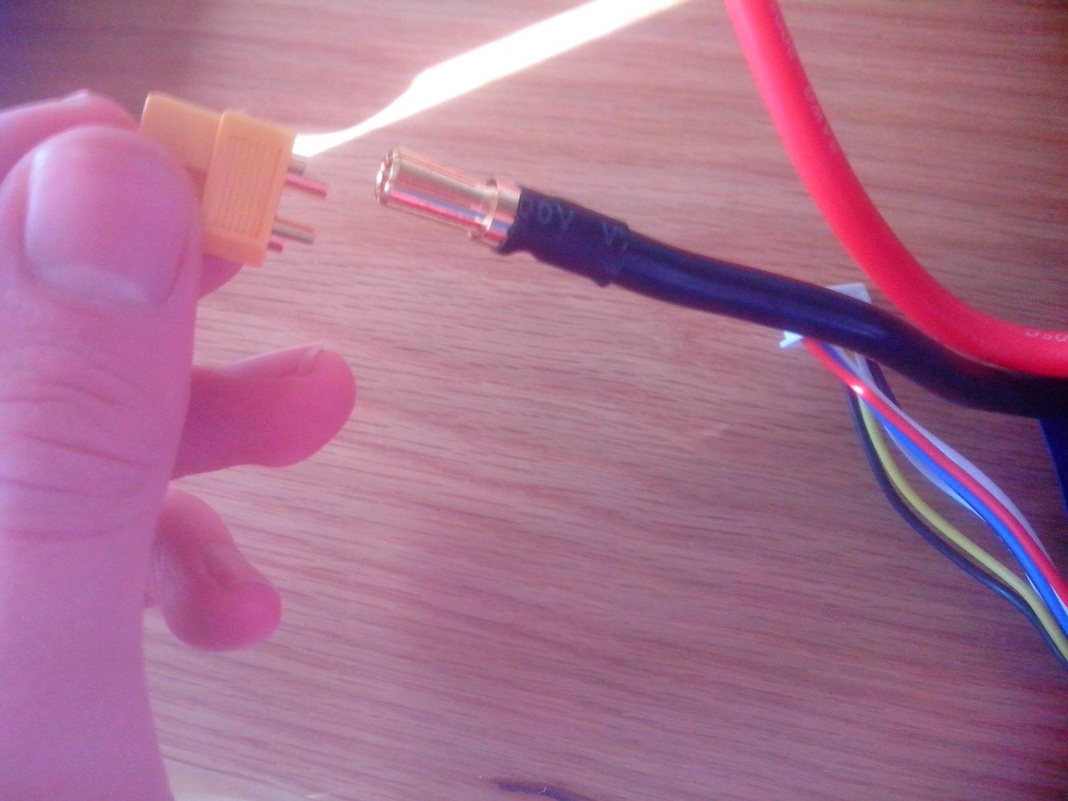

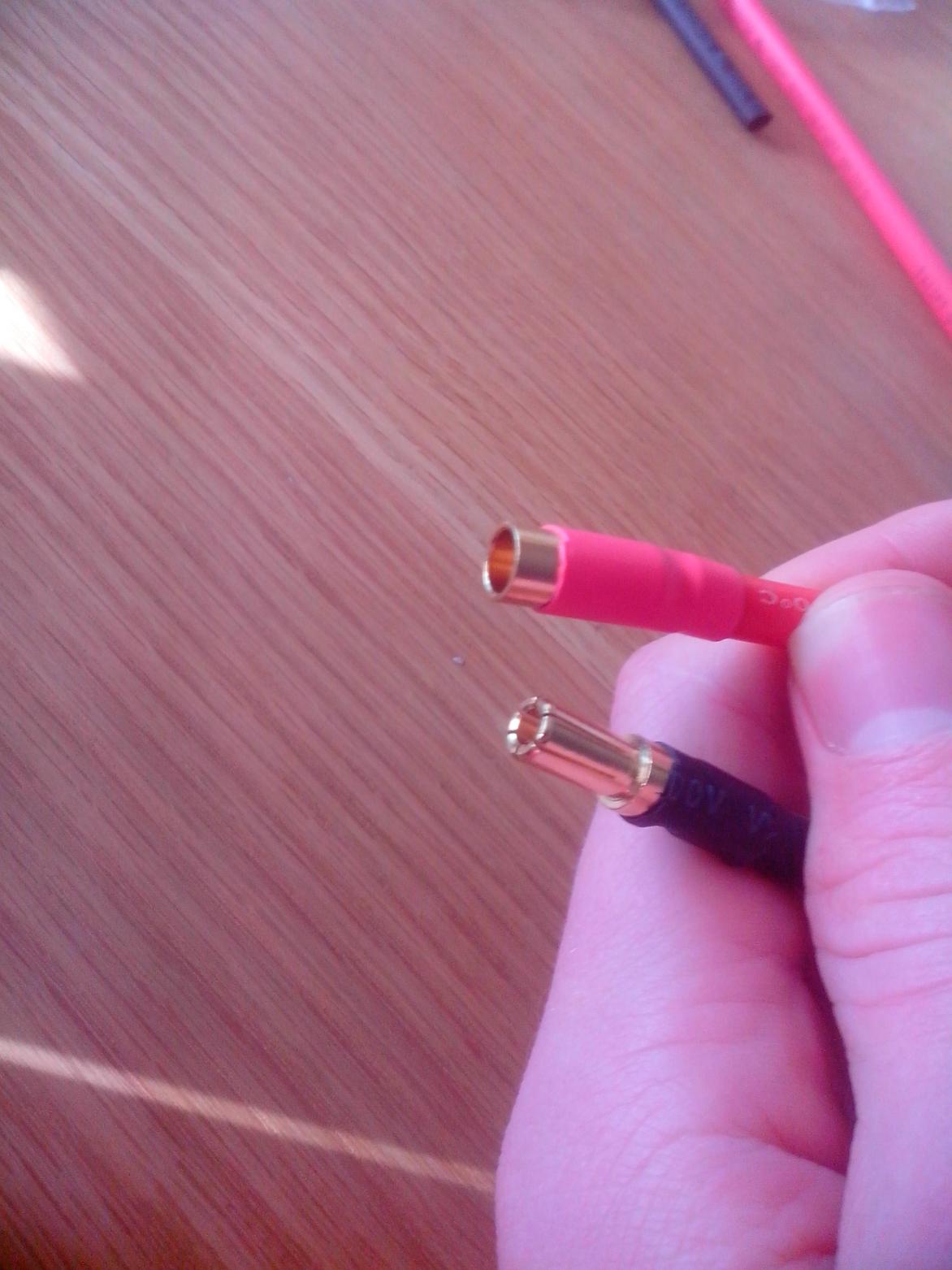

I've built the dji s800 evo and was just about to solder the (zippy 5800mah 6s 30c) battery terminals (5.5mm bullet connectors) to a female xt60 so that its compatible with the s800, however, i dont know what i really expected but the battery came with bullet connectors which i thought id be able to strip and solder to xt60s but the wire is 8awg (3.43mm diameter) which too big get a safe and direct solder to the xt60 (3.0mm diameter hole). Anyone been in the same situation as me or have a solution?
Would rather keep to using xt60s for convenience sake.
Where have i gone wrong?View attachment 17835 View attachment 17836 View attachment 17837

Have you done the math to see how much amperage you'll be drawing through the connector? If XT-60 is safe, then you'd want to snip those bullets (one at a time!) and solder the wire directly to the XT-60. No need for another solder point to potentially go bad.
ive cut back a bit of the wire to make the exposed part a bit smaller diameter to fit the XT-60, but only when I knew the amperage wasn't exceeding the connector.
dazzab
I've done just as @Motopreserver described on all my copters without any issues. Just make sure you tin both the XT60 connector and the wire before soldering them together. Also, make sure you have a male connector connected to the female side when doing the soldering. If you don't do this the pins move inside the connector when they get hot and don't line up properly when you try to connect it.
jes1111
:upset: Image #2 - is that the battery leads you're holding there? That's a nasty accident waiting to happen - the positive and negative can short to each other and you have no obvious way of preventing it during storage and transportation.
Please don't cut down the 8AWG so it "fits" an XT60 - that's just wrong on so many levels! The power system is what's going to keep you in the air - no shortcuts, bodges or lash-ups permitted :)

I use similar Zippy batteries, and I use EC5 connectors for my copter. I would not cut off the Zippy bullets, but instead trim off the heat shrink and desolder the bullets. You then have a nicely-tinned end, and don’t lose a half inch or so of the already-short leads. And as others said above, do them one at a time. Don’t leave open the possibility of shorting the LiPo leads together. I keep a long Velcro strap handy and keep one of the leads snug away from the other while I’m doing this.
I do not recommend using XT60 connectors for a 6S copter. EC5 is better IMHO.
econfly
To change the connector on a battery, de-solder or cut off the old connector and solder the new one directly to the wire. One wire at a time -- no big deal, but just be careful. I use XT90 connectors on my 6s batteries and do this routinely.
Is that wire from the Zippy really 8awg? It could be, I guess, but that would be overkill for a 5800mAh 30c battery. I would have expected it to be 10awg, at most, and that solders to an XT60 well enough -- about as large a wire as possible, but it will work.
If it is really 8awg wire then I think you need a bigger connector. You don't need it to handle the amp pull of an S800, but just to get a decent solder joint. The XT60 is too small for wire that big.
By the way, an Evo pulls anywhere from about 40 to 135 amps (max, full-throttle) in total, and for most flying the real world power consumption loaded with batteries and a Zenmuse ranges from around 50 to 75 amps. You can use an XT60 plug and be fine (and I think that is the plug that the S800 Evo uses by default). I like the XT90 better, for what it's worth.
