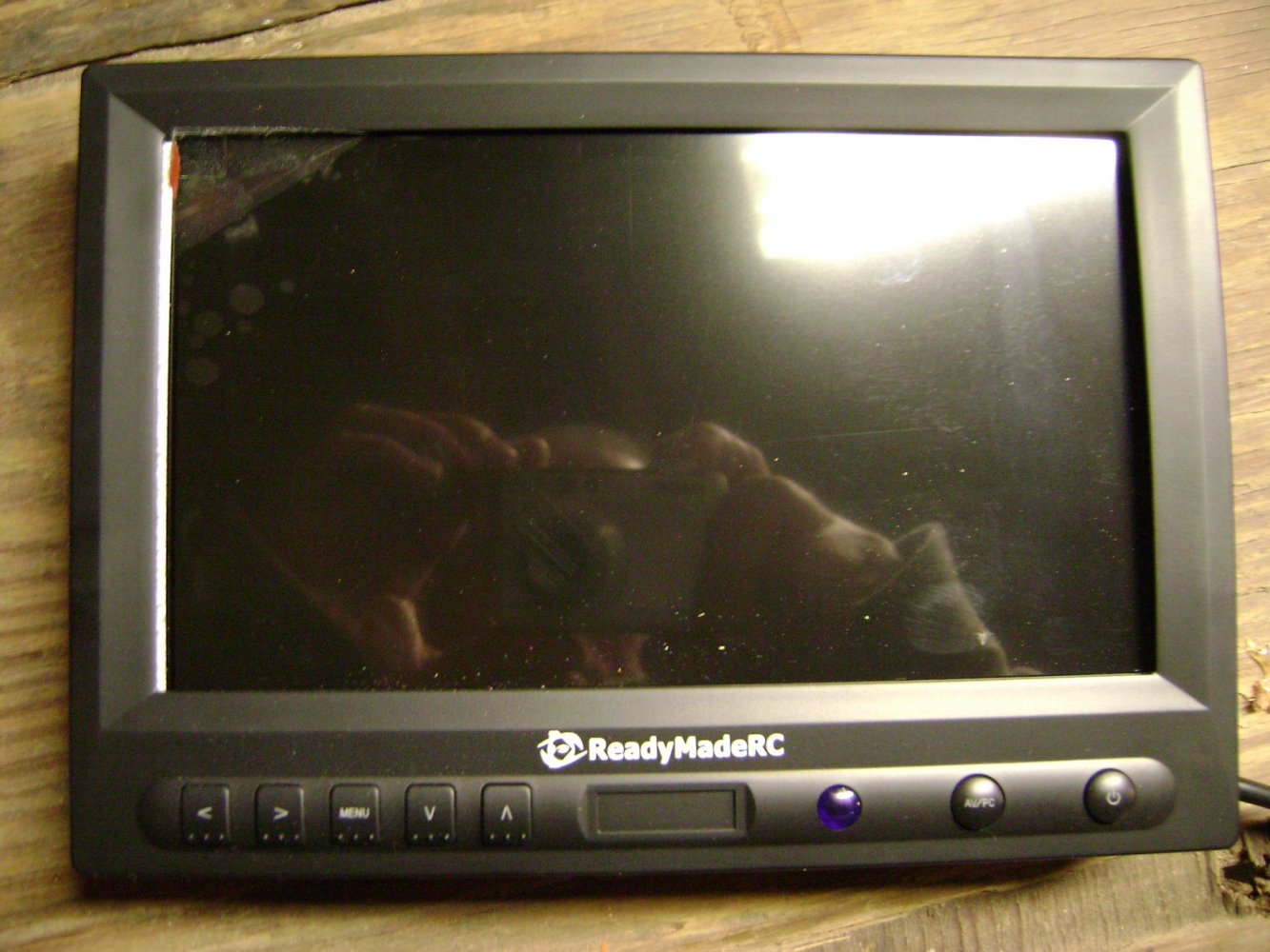

The monitor is an 8" rmrc FPV, VTX is a FX795T (5.8 gHz 40 channel), the VRX is a FR632 (diversity) and the FPV cam is a RunCam 600TVL Mini. I think the monitor is bad. Looking closely it appears as thought the entire display has shifted to the right opening up about 1/32 of an inch gap along the left edge of the basil. It may be that something is disconnected inside and it gets nothing so it just default to the no signal routine. Might have nothing to do with it, but then again it might. Any ideas would be welcome.

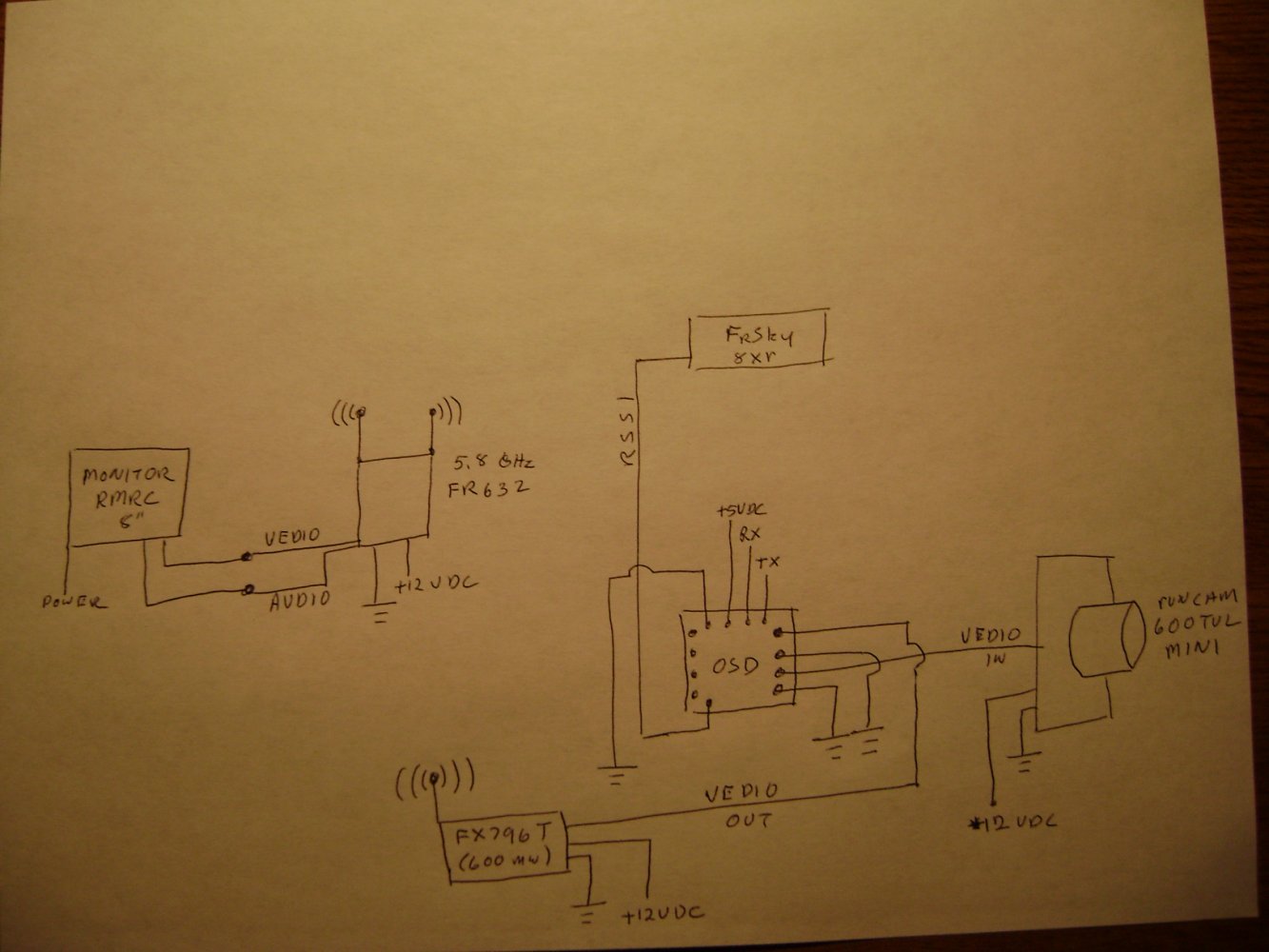

Could you show us a diagram of your wiring? This should be really easy to figure out. I
have two of the RMRC 8 in. monitors and they work fine. And your channels are right?
Your monitor acts like it is not getting a signal from your receiver.

View attachment 27900 I will try and draw something up tomorrow and you're exactly right, it acts like it's not getting any input at all. Even if the quad wasent sending a sig, the VRX should be outputting something to the monitor even if it's nothing but a carrier, which should result in "snow" or "static" on the monitor....but alas....nothing but the blue screen of death...... The pic shows how the screen has shifted to the right....might not be the cause of the problem, but it still isn't right.

Not really sure about your OSD. I usually before going to the copter- lay everything
out on my work table to see if it is working. Have you tried just using the camera to
the video transmitter without the osd? That would narrow it down a bit. The 5 volts for
the OSD is from a BEC? Make sure everything is set to either NTSC Or PAL- not mixed.
Also make sure the video transmitter and the video receiver are both on the same channel.
Alwil
There is something about your grounds that is bothering me. You may have some loops there.
Usually the video ground is separate from the 12 volt grounds. I may be wrong- maybe
someone will chime in on this.

Your sketch just came through....basically the difference between yours and mine is that you DO have a dedicated ground and going through the PDB I am not sure the ground for the FPV is isolated from the grounds for the rest of the system. But even if it's not, I would think there would be a signal, abit saturated with interference. Oh well....the raccoons turned my garbage can over last night.....got a mess to clean up...will check back later ....thank you for all your help.!
