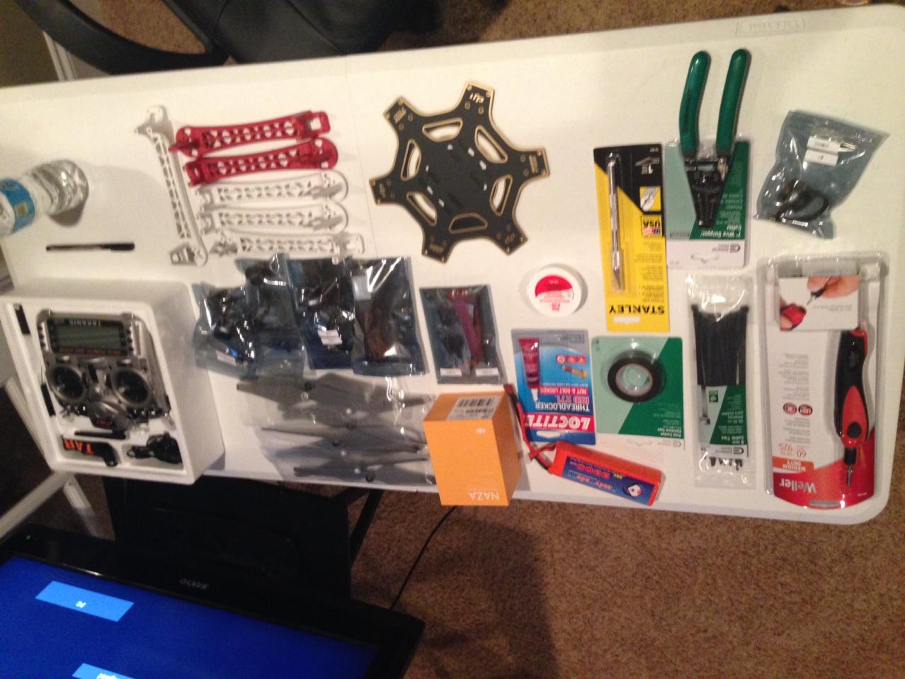

Hey everyone! Excited to post my first build thread. Wouldn't be anywhere without the help of this forum, and people like (@Motopreserve) and more.
After months of scouring and researching for the most cost effective and functional rig for AP/Cinema for work I landed upon the good ole' DJI F550. I'm sure you have seen a million of these, but this is my first time. Read Many mixed opinions, reviews, and comparisons to other bigger & better rigs but this seemed to be my BEST start for the budget & beginner. I will be shooting small (Rx100/GoPro/Nex5). I know nothing about soldering and never have, so hang with me
I know this is something I can search and post separate threads for each component and tiny question, but I decided to keep all of MY questions here for everyone to see as I'm going. Let me have any comments/critique/opinions/No-No's you may know!
Pictures to go along by tomorrow. Right now everything is in a million boxes on my desk ready to work. Also I'm over budget so I'm hoping this is EVERYTHING I need (minus a charger which I'm purchasing this week). Below is my current list of parts, pictures coming along this week!
RIG ASSEMBLY PARTS:
-F550 Frame
-30A ESC's (6)
-2212 DJI Motors (6)
-DJI Landing Gear
-Naza V2 W/ GPS
-FrSky Taranis w/ X8R Receiver
-RMRC 4s 3300mAh LiPo
-HQ 1047 Slow Fly Props (6)
TOOLS:
-Weller 60w "925f" Soldering Iron
-Loctite Red 271 Threadlock
-H20-5 Water Soluble Flux Paste
-7" Wire Stripper/Cutter
-Hobby Knife
-60/40 leaded Solder
ACCESSORIES:
-XT-60 Male/Female Pair (3)
-3.5mm Bullet Connector Male/Female (6 Pairs)
-12ga Wire (Red & Black)
-Assorted Heat Shrink (1.6mm, 4.5mm, 9.5mm, 2.4mm
Thanks for looking!

I have some cautionary thoughts....
The Weller 60W soldering Iron is extremely hot for what you will be soldering! You won't need more than 40. Even with that you may be melting some things unintentionally (ESC circuit boards, etc.). 60/40 solder melts at about 450°.
Red loctite? I wouldn't use it... I'd use blue. Blue will allow you to remove fasteners later. Red is extremely hard to take apart. It usually requires heat.
I have never used H20-5 Water Soluble Flux Paste. I hardly ever use flux at all! When I do it's because I have unclean conditions and I can't clean it. The flux sill help with that. I use La-Co flux.
The reason I don't use flux is because I use flux core solder. It has the flux built into the solder eliminating the need for any extra added flux.
Make sure you buy plenty of props of both rotations! I went through 6 in my first two days...

Glad I read this! 5min before opening my soldering iron. So I should be able to take that back tomorrow and exchange for a lower watt soldering iron. Would 25w work? Or should I stick closer to 40w.
Good call on the loc-tite, it was the only one at the store I went to. But I will go out of town to a home depot tomorrow and get the normal blue type.
Should I avoid the flux all together? I've been told it helps the connection, but this brand was all I could find. Thanks alot for the info man. Just saved me a bit! I'll admit I'm definitely a noob at this

Ideally you need a 25 and a 40watt. It depends on what you are soldering. If you are soldering 3.5mm connectors use the 40 watt if you are doing any type of circuit board soldering use the 25 watt.
If you have 60/40 flux core solder (most small diameter electronics solder is) you won't need flux. You wires will be new and clean and the 3.5mm connectors are normally gold plated and clean as well.

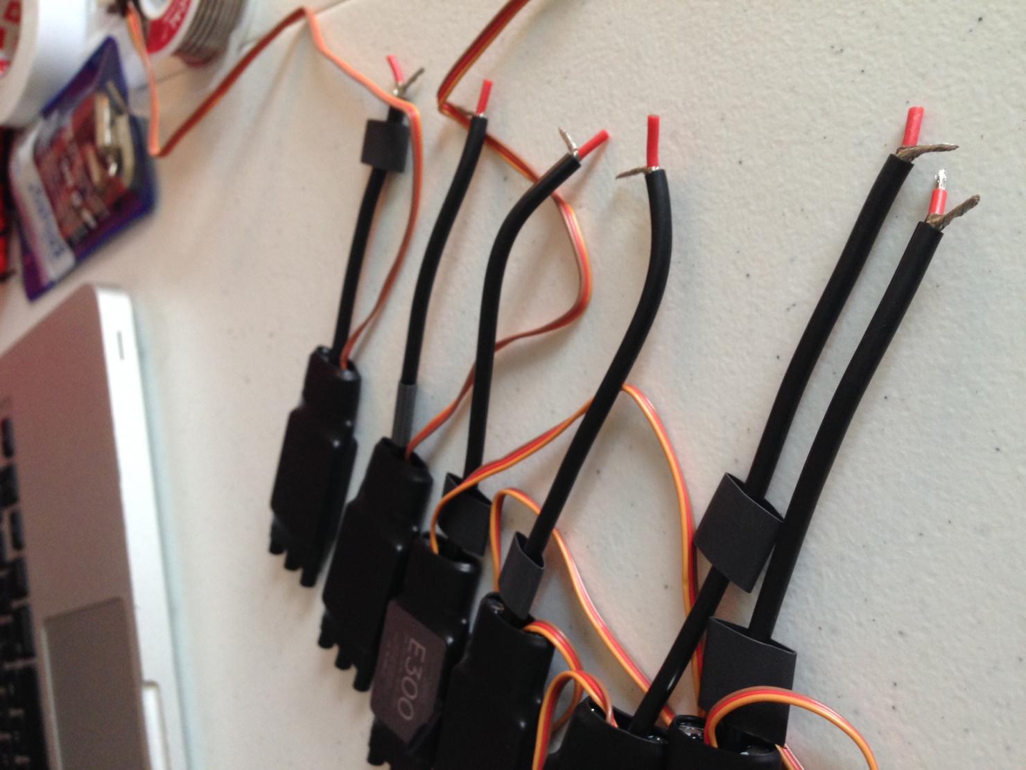

So I just began to tin my terminals, and solder my ESC's...one of my ESC's cord was shorter than the others, I tried to trim a bit of wire. DID I RUIN MY ESC??? Pics attached. Is this functional? I only see a red marked wire, and the rest of the "black" is meshed around the positive. Is this normal or did I ruin my esc wire?
I may be a super noob and just looks scarier than it is. Anyone know this simple answer?

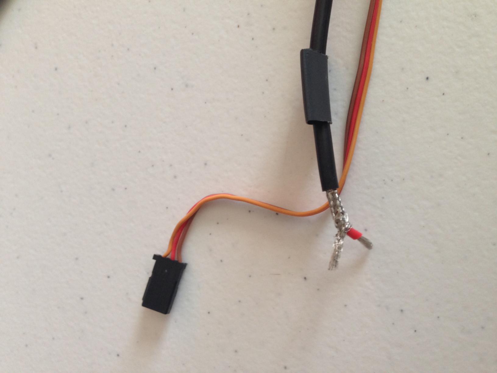

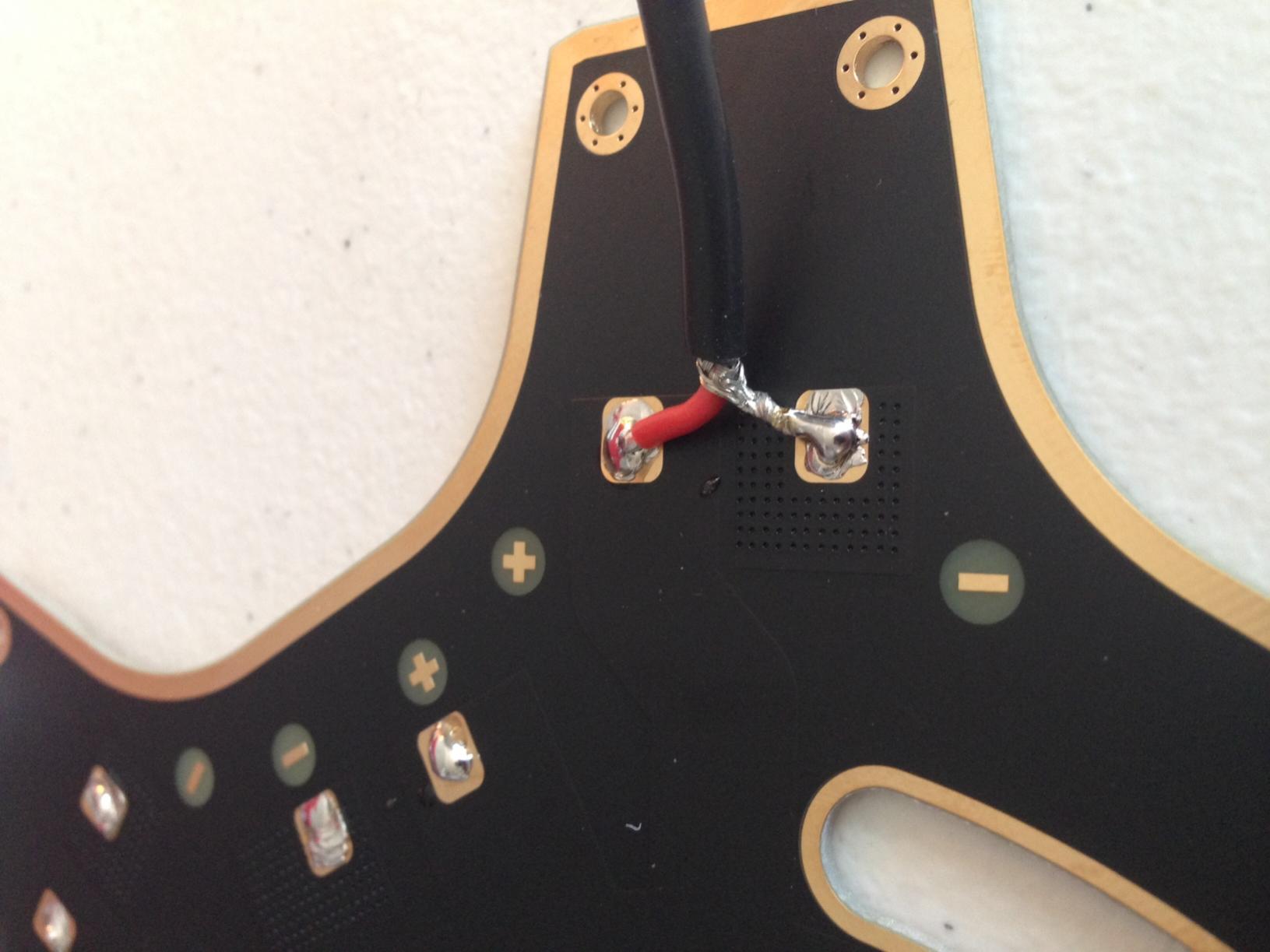

How does this solder look to anyone??? First time ever so I can definitely re-do. But I'm confused on these positive/negative wires coming from my ESC. The ESC's are also longer than my hex frame arms. So im wondering if i need to trim back the entire cord completely. Is this "wire mesh" actually my black(negative) wire?
Are my ESC wires correct?

where are those wires coming from? i've never seen ESC wires that were braided like that.
have you seen the video in the group build where I demonstrated some small soldering tasks?
http://www.multirotorforums.com/showthread.php?14280-Group-Build-DJI-NAZA-F450-Quadcopter!
it's the sixth video down in the first post, or vid 4 of the group build project
ESC came from Aerial Media Pros. The Opto E300 and says www.Dji.com on the esc. And im logging onto the soldering videos now! Thanks man

Looks fine to me, although I'm surprised they don't provide any strain relief for the wires so they don't pull the solder pads off the board. If there's anyway to provide wire support so that it's not pulling right on the circuit board as you go through the build process it should be done..
ive definitely never seen anything like this either except in home wiring and a few audio cables. That's why I suggested he ask. Every photo on the web shows the DJI having 2 separate wires.
Toymaker
Crashologist
Laptop computer power supplies use this type of wire for the DC feed to the computer. It's kind of a PITA to work with, and you have to be careful not tho nick the braid otherwise you loose conductor size.

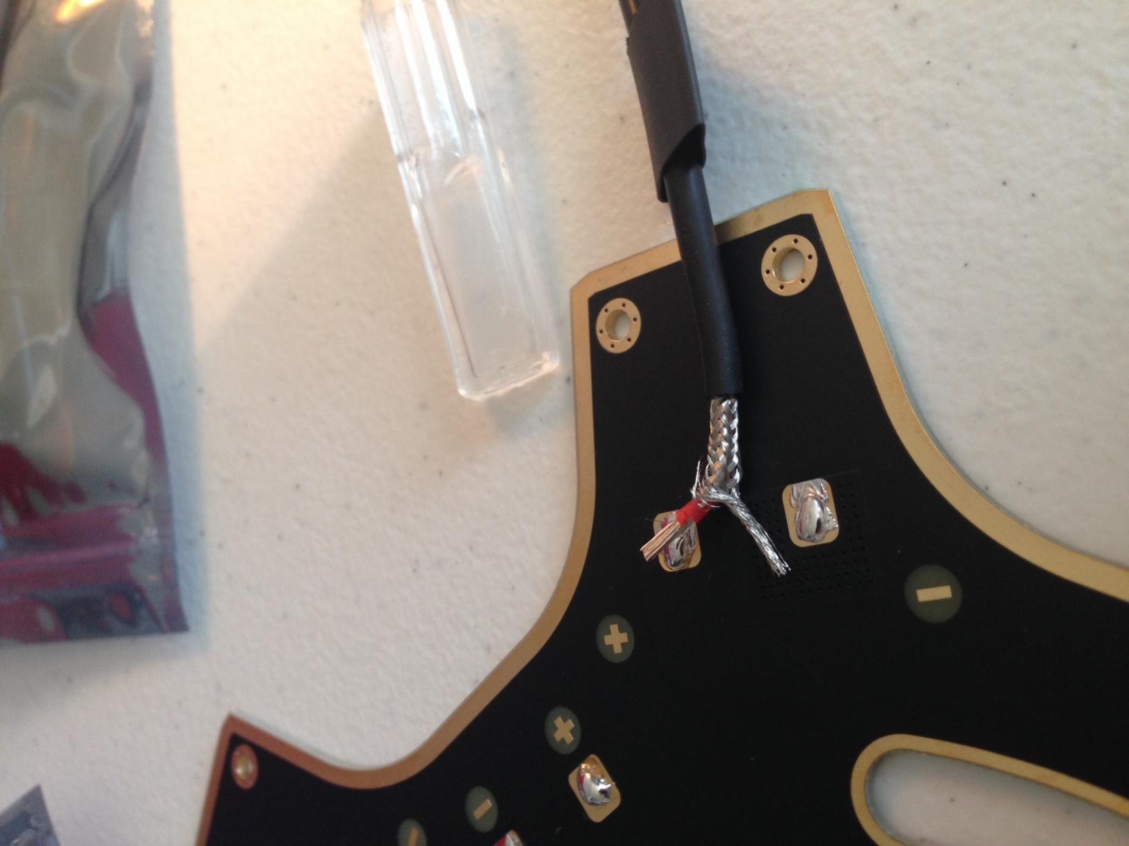

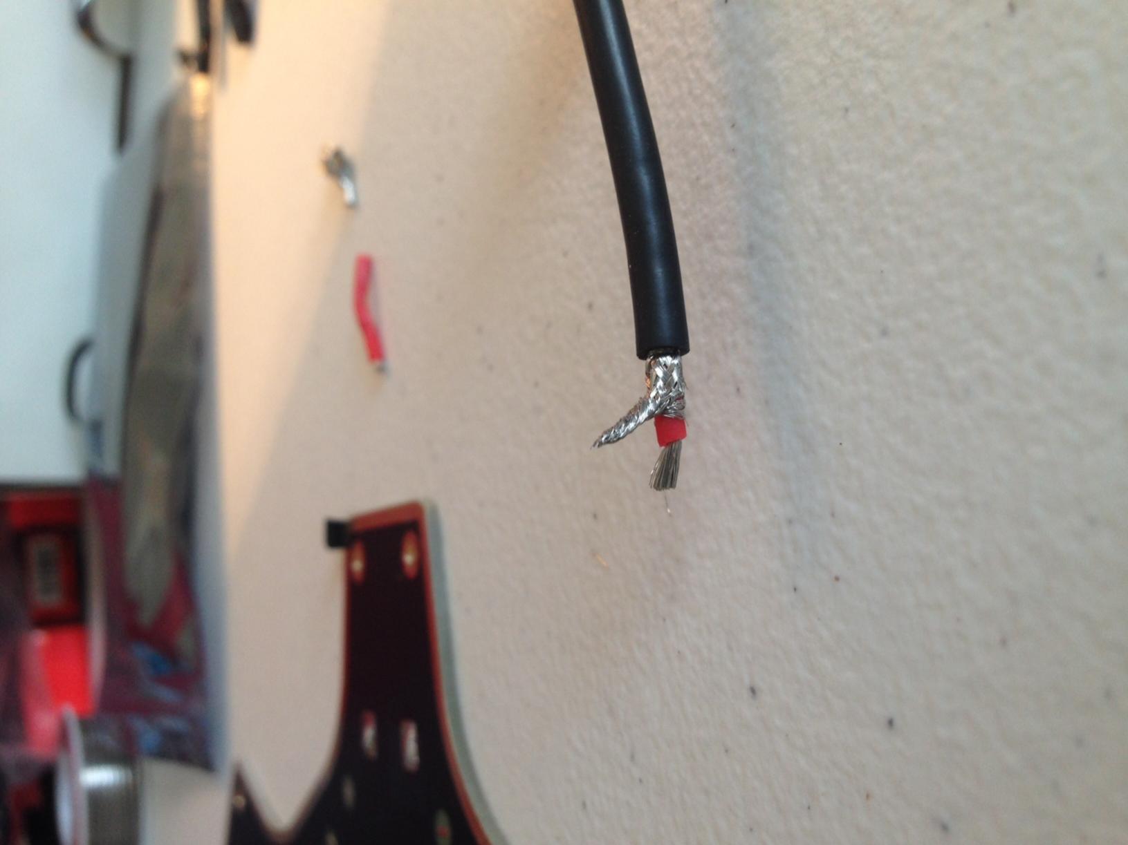

So my ESC wires were too long (longer than my frame arms) and I cut them back shorter. Then twisted the mesh (negative) wire, below is a picture. Does this look safe to solder and hold a connection to anyone??
