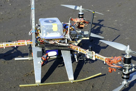

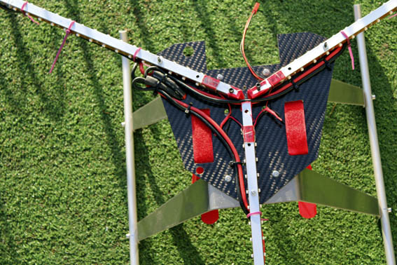

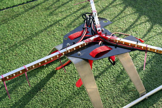

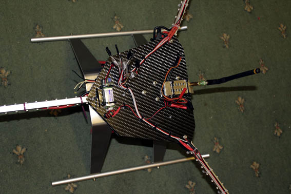

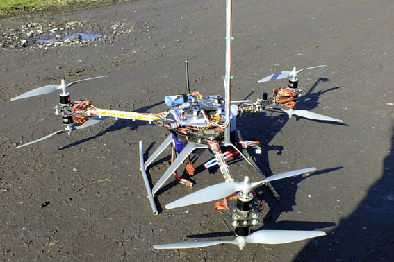

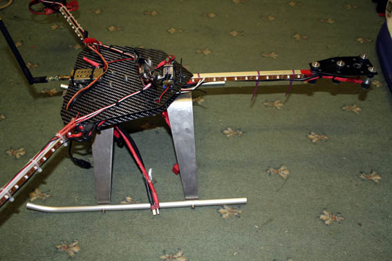

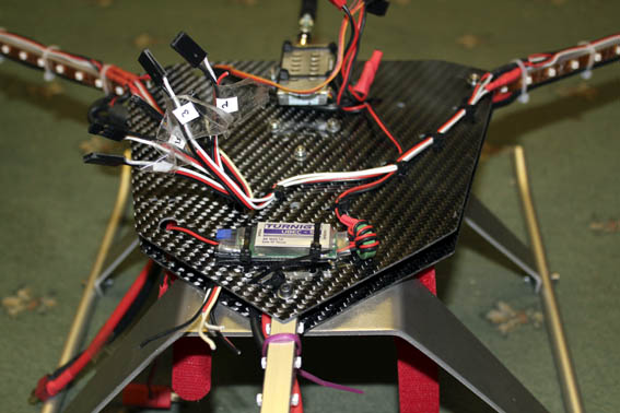

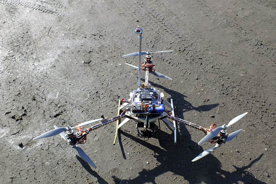

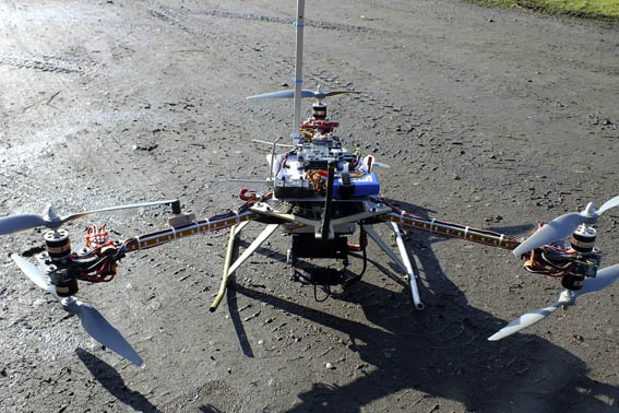

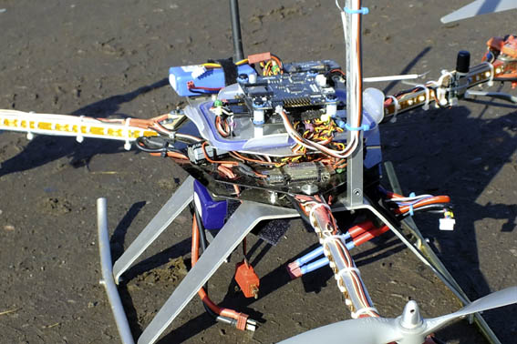

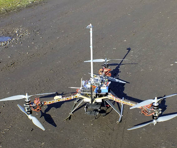

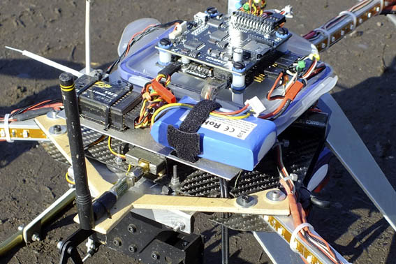

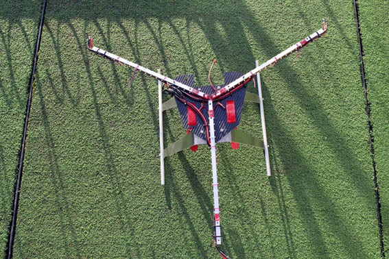

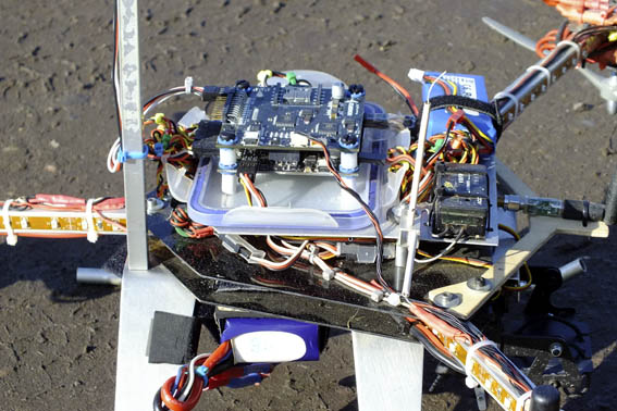

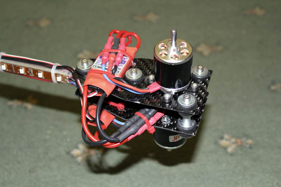

can you please post some pictures of your Hoverfly installation?

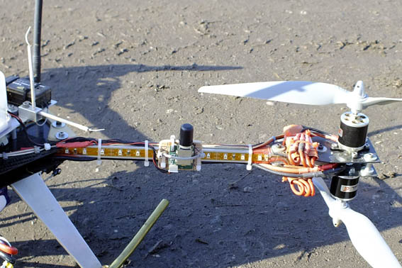

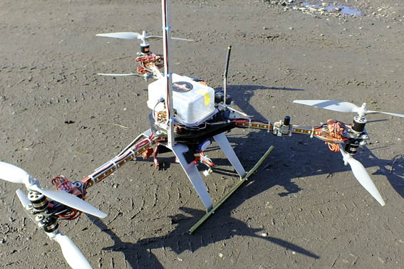

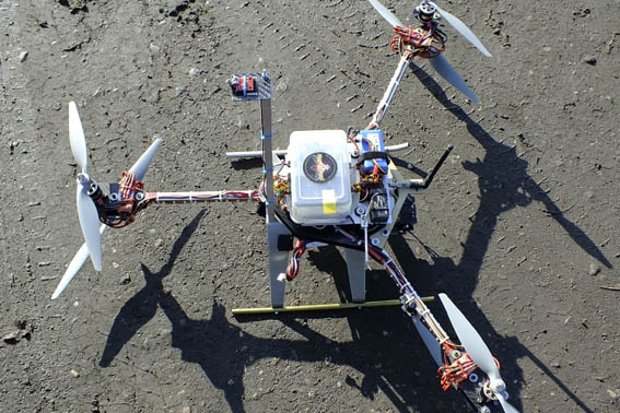

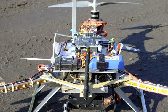

Arm length centre to motor 39cm ( 15.5 ins )
Wt 3.2Kg
Motors JP Energ 4800 890Kv 28/20
3S 8400 60C Lipo
12 x 6 Apc props top
13 x 6.5 Apc props bottom
FrSky V8Fr Rx
Futaba T9CP Tx
Jakobs Gimbal / GoPro Camera
Turnigy Plush 30A Esc
Hover at 45% power
HFP/GPS controller
Entirely home designed and built.
