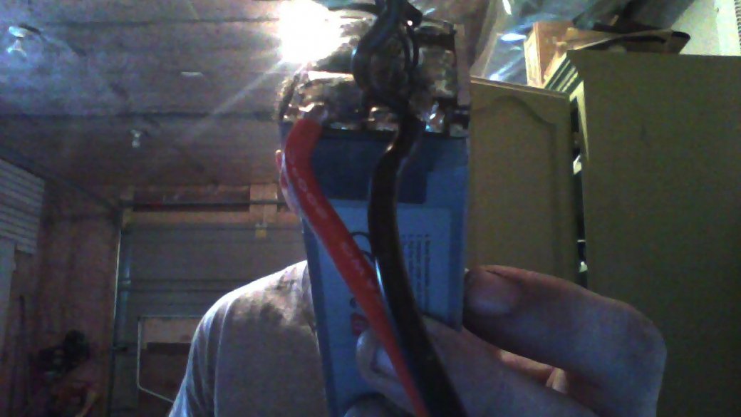

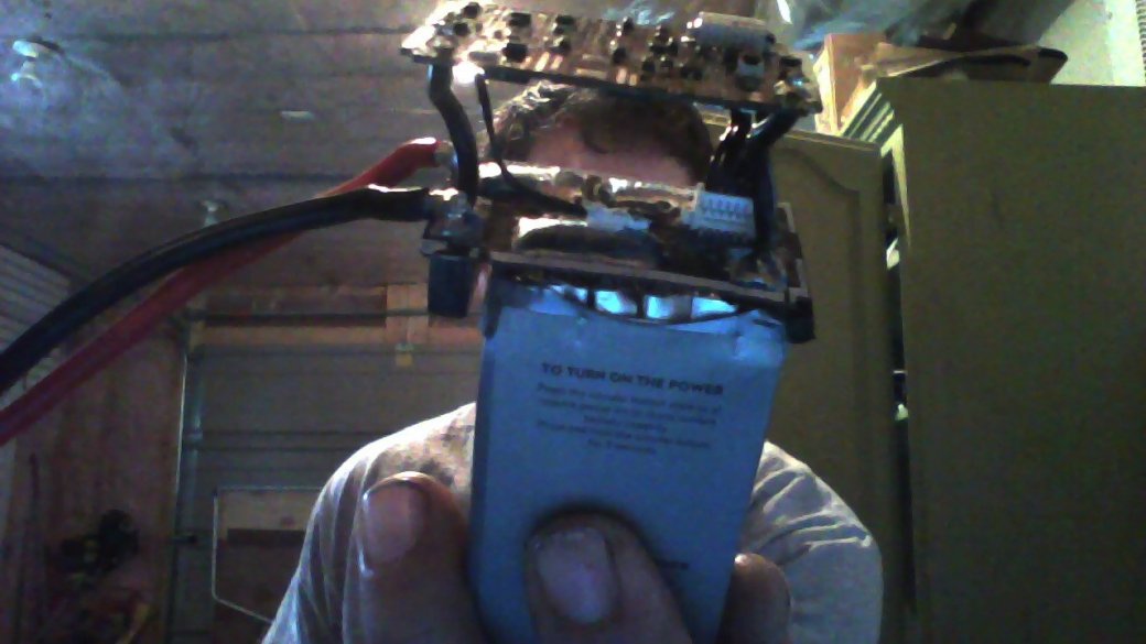

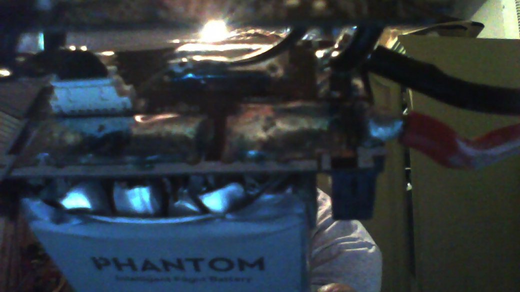

Hello, I still would do what Carapau recommended, but from personal experience you can re-purpose I dji smart battery to work with any multirotor that is big enough to fly it. But with this being said there is a marginal improvement on flight times. But its not worth buying a new smart battery to tear it apart to gain an extra 2-8 mins of addiational flight time.
But in my case I had a friend who crashed his phantom and the phantom wasn't recognizing the battery, so 10 dollars later I had a battery that would turn on but wouldn't work in a phantom 2
After tearing it apart I noticed the 2 pads for the smart port on the battery had shifted out of there designated spot. Im guessing from the impact with the ground.
I also noticed this wasn't your traditional 3 cell, it actually has 6 cells inside the battery.
Anyways long story short I just soldered on an xt60 connector with pigtais right to the pads on the battery and bam, a universial smart battery with built in balance board that can be charged with any 15v dc power supply, I just repurposed an old wall plug dc transformer into a adjustable buck converter
