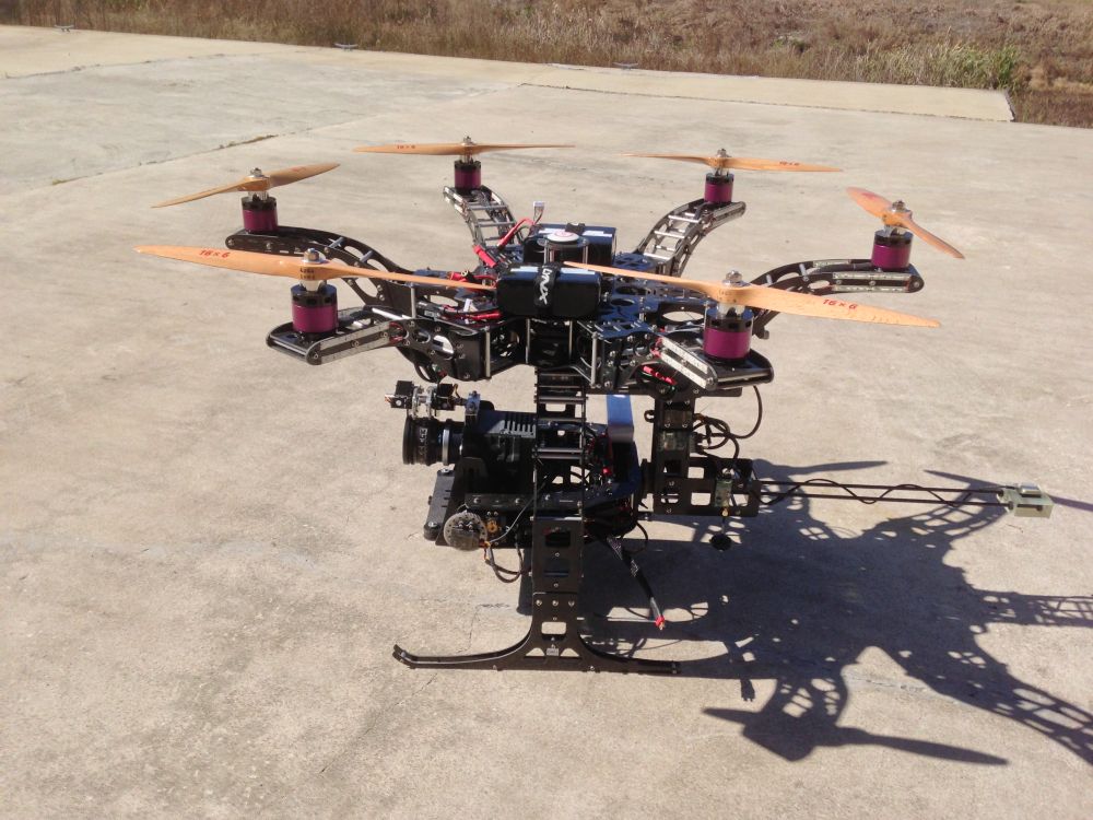

I see your issue which is common with people and their tbs discovery frames as well.
tie a string between the motors diagonally. (so tie front right to rear left and front left to rear right). WHere they intersect is where your center of gravity is supposed to be at. SOunds like that big 4s 5000 is weighing they rear and big a pulling your CG to the rear of the quad
