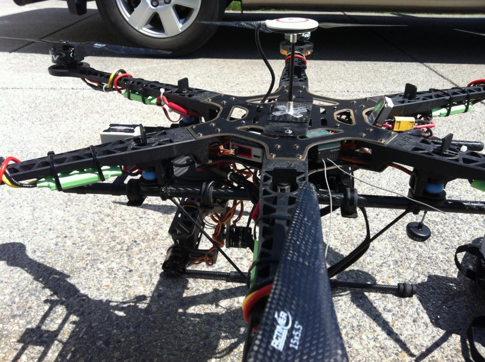

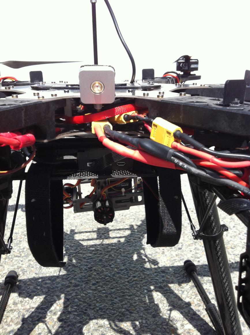

There could be several issues at play here...... In my case the IMU baro sensor was being spoofed by the nearby props.... especially when flying forward...the IMU was originally mounted in the top plate.... I bought the DJI-Innov S800 anti-vibe kit and relocated the IMU down below on the IMU plate on the landing gear and most issues were resolved. Also I had a MR wobble problem traced back to undersized motors/props...... swapped out both and chose the Turnigy Multistar 420KV motors and 15 inch x 4.7 carbon fiber props and the wobbles disappeared. see my signature below for some hardware details..... View attachment 12769View attachment 12770View attachment 12771
