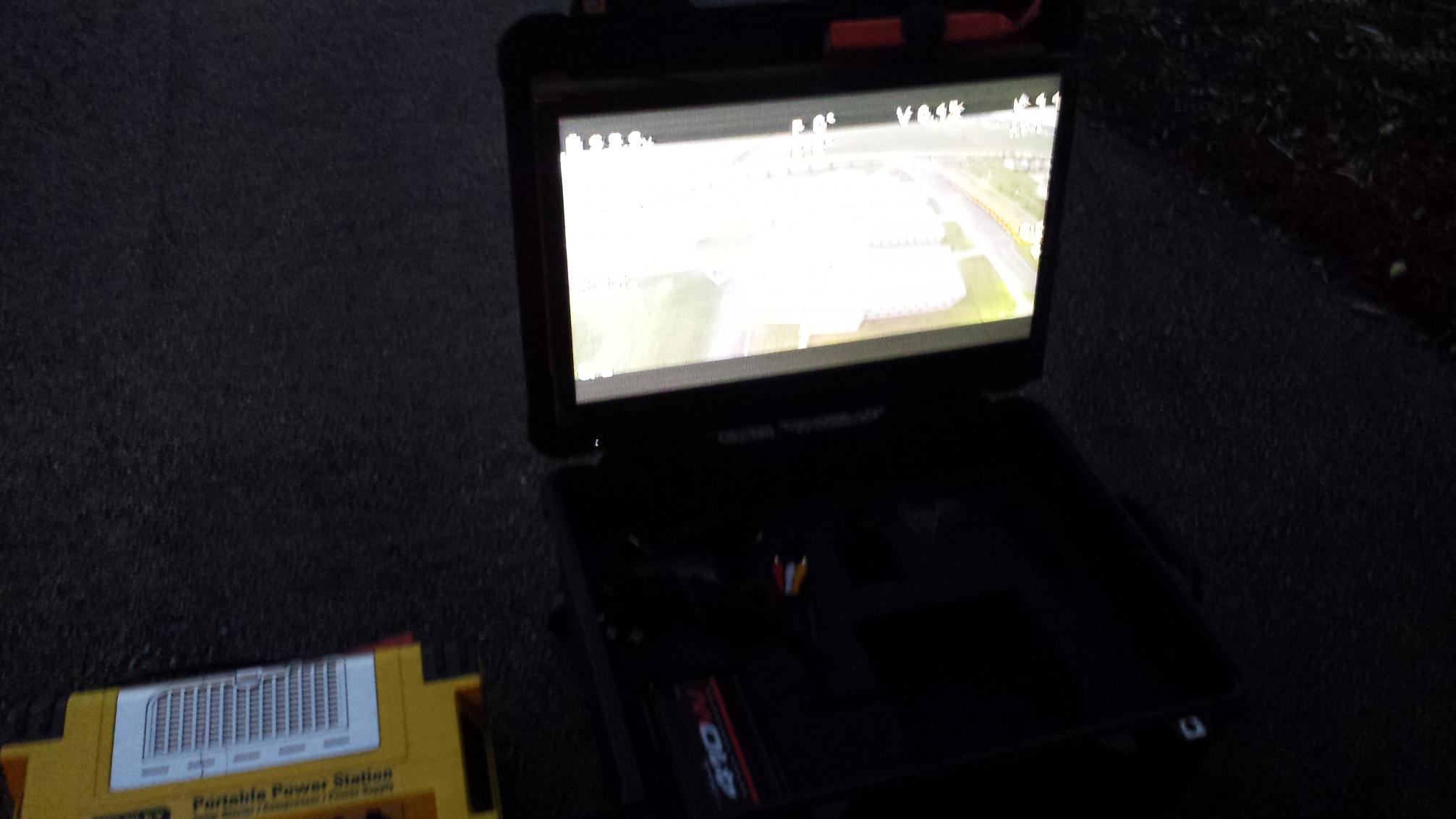

Okay thought I'd post my final setup.
IN this case I was pissed off and decided to go to walmart. I had read things about a specific Vizio monitor that they don't make any more so I bought the 22" Vizio (E221VA) LED monitor at Walmart. Drove to the nearest Forest preserve, plugged it into an inverted and took it for a quick flight to test. Worked like a champ. Not its not without it's blue screens, but in fairness it only blue screened or did no signal at the same point my 7" from FoxTech did. So In my personal opinion if the known, well used, well reviewed 7" blue screens at the same time the Visio does they are on the same page ;) It was very quick to come back, just as quick as the 7".
Only downside to the TV, if you call it that is it's 120VAC, vice a nice easy 12v. In my case, I happen to have a 4S Lipo, 12000mAh plugged into the Immersive RC power brick, so all I had to do was run a cable from there to a small $25 400W inverter from walmart to power it.
Attached are two pictures, one of the setup, the other is of the video (Sorry it was dark on a cell phone camera). The one showing the image was from my 5.8GHz DJI AVL58 at 300M distance 50m elevation without line of site. The blur in the camera is me ;) Point being is it works ;)
View attachment 13479View attachment 13480
