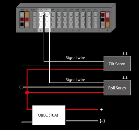

Rob, on your site under resourses towards the bottom there is a drawing recommending a 10amp UBEC feed the two servos in the steadi do recall when that was added because I have never seen or read about that before, is it urgent it's a must I don't no, what does concern me that they say use a 10amp UBEC 10 amps for 2 servos is a bit of a worry I realise that the servos are working all the time keeping the Gymbal vertical but drawing 10 amps? ....john
I cannot remember where I got the image from. I am not sure how much the 2 servos will draw. This image was really just to show how one should connect the servos to the YS-X6 and not to use the power from the YS-X6.
johnno
Phi rob,so it's not a requirement for the Steadi....John.
